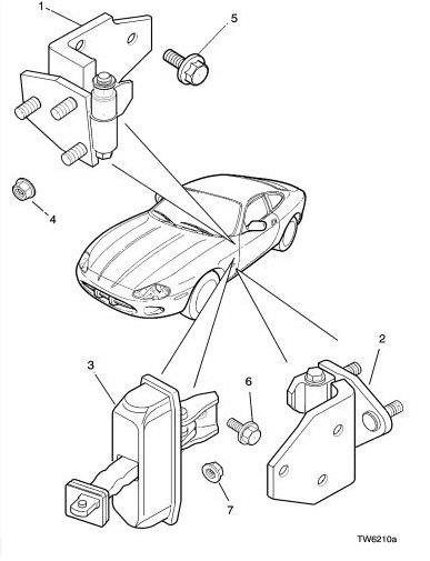

Originally Posted by ScottXKR
..... the the noise frightens people away.
That's no bad thing.
Make sure the Door Check Arm is undamaged (see item 3):
Although a regular issue on both X300 and X308, the XK8 has an improved design but there's still been a few reports of failure.
