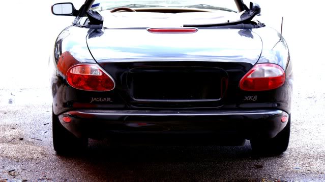

After lots of cutting, voila!
Attachment 171722

good modification, so exactly how much 'cutting' required? I do like the jewel tail lights better.

Literally a hole the size of the tail light.
The jewel tail lights mount quite differently to the body.
Yours screw to the body, while the newer version protrude through the hole that the old would have screwed to, and have a bracket of sorts from the back side.. like a drywall screw approach.
Really freshens up the look i think... although subtle.
I made brackets out of aluminum, but i think they can be sourced directly from Jag.

Looks excellent, much more modern. If I might suggest some Philips Silvervision indicator bulbs now to remove that 'egg yolk' look? Cleans it up even more :)

1 thing convenient about the swap is that the new tail lights use the same plug, so it's plug and play I think. Actually I haven't tested the new version with the battery attached just yet... but the plug does in fact plug in.

Sorry to say but every wire but the fog is in a different place, I can give you all the changes if you like.
I also do composite rear back plates, for a 3rd of the price of Jaguar if you are interested
Damn, I was worried about that.
That'd be awesome to let me know the wire swap!
I haven't looked close enough, is it a cut and mend ordeal, or easy enough to remove pins?

Attached are the wiring changes, look on the plug and the positions are numbered, it is possible to get the pins out with a very small thin bladed screw driver, in the old days before I bought the correct tool I use to cut, solder and shrink wrap the connections which maybe your easiest option.
Good luck
P.S. Bare in mind this is for UK XKs so the drivers side is your passenger!
You're a gentleman.. thank you sir.
Kudos!

I wouldn't say it was subtle, I would say it is a big difference, the older lights look very dated, I never hesitate to change them!
Attached is your wiring changes!

Thanks again.. but can you just verify how I am to read this?
i.e. where is the plug 1 position?

Look on the plug, on the side wires go into each hole is numbered, to remove the pins you will need to remove the red plastic insert, look to the side of the plug and you will see a couple of red tabs sticking through, with a small srewdriver push them in and up at the same time.
Take all the wires out except the orange/black and then put them back in the relevant hole positions as described, one connection does not get used.
