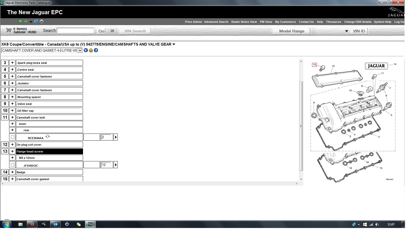

1 Attachment(s)
JEPC doesn't give size for the camshaft cover bolts but shows the coil cover bolts (item 13) as M5 x 12mm.
Attachment 127282
avern1 Mar 25, 2016 06:32 AM
The cam cover bolts are a machined configuration to contain the isolator and would not be a standard off the shelf bolt. There are also 2 types as shown on JTIS one is a stud configuration that will hold wire mounts or the dipstick bracket and the others are hex head.
Dealer or breaker is the only source I know of.
XxSlowpokexX Mar 25, 2016 07:07 PM
The bolts are special but they can be cut and the isolators used on new ones. Ive done it before on other cars. When Im don't with my fiasco Ill post the info for others.:O) Thanks!
