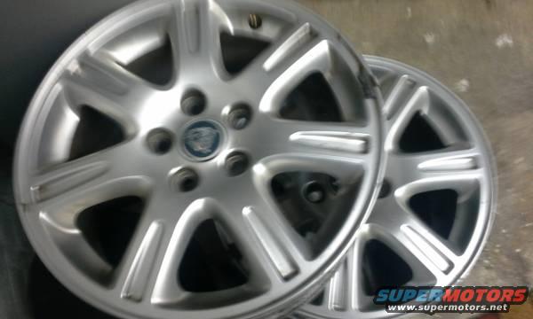

Will these nice 6 star jaguar rims fit my 1998 xk8? they are 16", and what tire size should I go with for them.
Stock rims are the 17" UGLY fan blades IN THE LINK BELOW, I HATE THESE RIMS.

I personally agree on the stock rims. They make me think of that alien stuck on the guy's face. Regardless, I wouldn't go under 17in. You're going to need a very tall tire that will look strange and will affect handling a bit and likely throw speedo off. There are some good choices at 17 and bigger that should do for you. I've got the stock Lamina's on my 2000 and while they are not flashy, they are easy to clean and look passable. Easy to find as well as folks take them off to go to 19 and 20. Good luck.

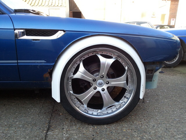

You can make Range Rover wheels fit as the offset is quite large so a spacer will be required....... But I would not recommend anything too large like I am doing to my XJ a set of 22" Range Rover wheels
