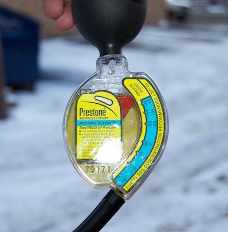

I don't know how you'd measure water vs. antifreeze, but auto stores sell little coolant testers that show what outside temperature you are protected to, e.g. 32F, 20F, 0F or below. Looks like an eyedropper with little floating ***** in it.

Originally Posted by KillerKat
............ How can i check coolant mixture ratio to water?
There's several brands of coolant tester available. This is one from Prestone:
To use it, draw coolant from the Expansion Tank into tester and read the strength off the scale.
This one is available through Walmart.
Attached Thumbnails aftermarket coolant temp gauge-prestone-coolant-strength-tester.jpg   aftermarket coolant temp gauge-prestone_antifreeze_coolant_tester.jpg

The antifreeze testers measure the density or specific gravity of the coolant, just like the battery testers with the floating *****. But why all the discussion on measuring temperature? Hasn't everyone checked out the Realgauge kit from whitexkr?

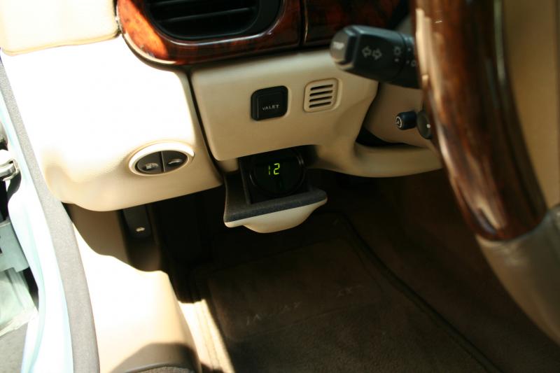

A few years ago after an overheat scare I installed a digital gauge on my '97. Since I did not want to replace one of the Jag gauges with a non matching one I was able, with a little backyard fab work, to install it in the flip out glasses holder This way it can be hidden or left open. The sender I installed in the heater hose. Seems to work well but the temp these engines run on a hot day at a long stoplight will scare you before the fans kick on and she cools down some. I have seen it go as high as 135 on a real hot day and the jag gauge is still dead center. I think White XKR has now come up with the better mouse trap but at the time this worked for me.
Attached Thumbnails aftermarket coolant temp gauge-xk8-005.jpg   aftermarket coolant temp gauge-xk8-003.jpg
