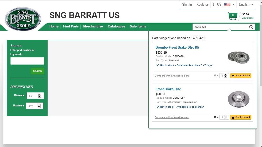

User 070620's Avatar
Join Date: Jan 2012
Posts: 1,462
Received 301 Likes on 148 Posts
Old 11-05-2018, 07:29 AM

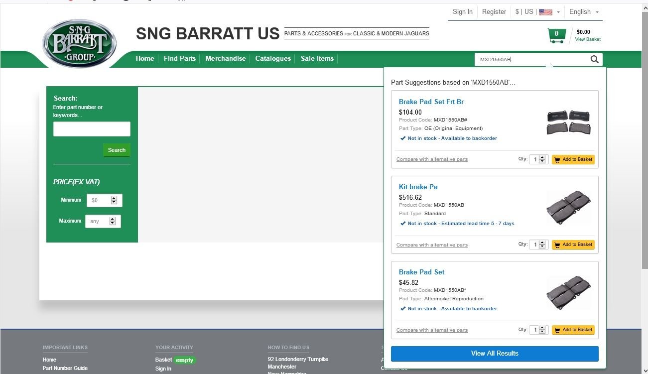

jobagadonuts's Avatar
Join Date: Jan 2015
Location: Hawaii
Posts: 128
Received 49 Likes on 19 Posts
