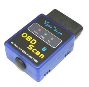

If you have one of these neat BlueTooth devices for running Torque Android .......
............. then don't leave it plugged into the OBD2 Diagnostic Port with the vehicle parked up for a few days.
I left mine connected over the Easter weekend and the battery was too far down to start the vehicle this morning. The Diagnostic Port has a permanent live feed so the BT adapter was powered on even with the vehicle locked.
