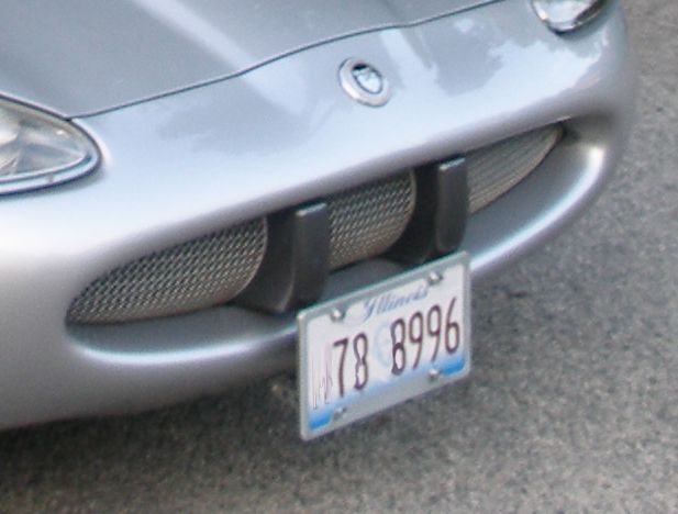

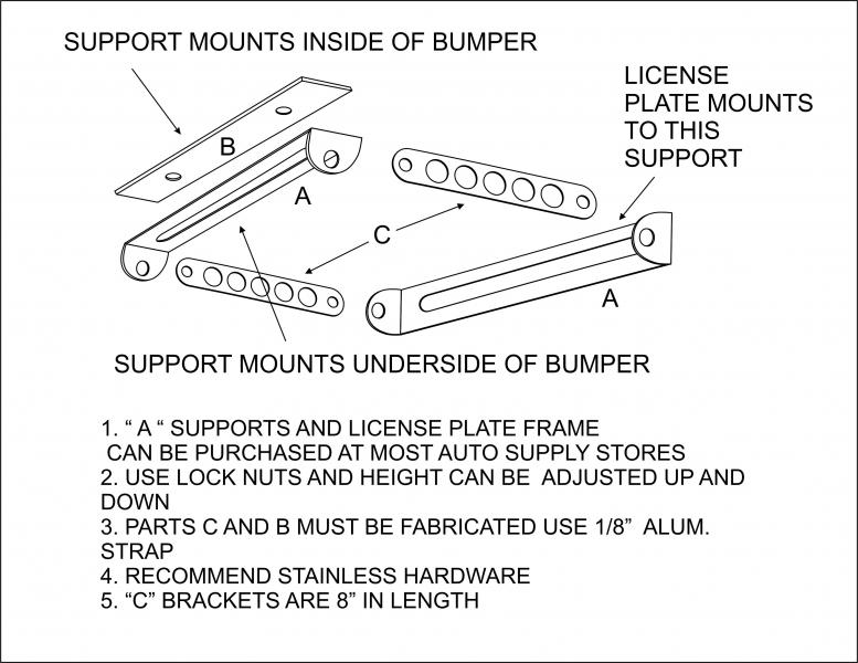

I had this bracket on the front when I first bought the car. After repainting it I left it off. It's adjustable, you can adjust it up or down. the problem was hitting the curbs and parking blocks. In Illinois we are a two plate state. I haven't had it on for about two years and have had no problems.
