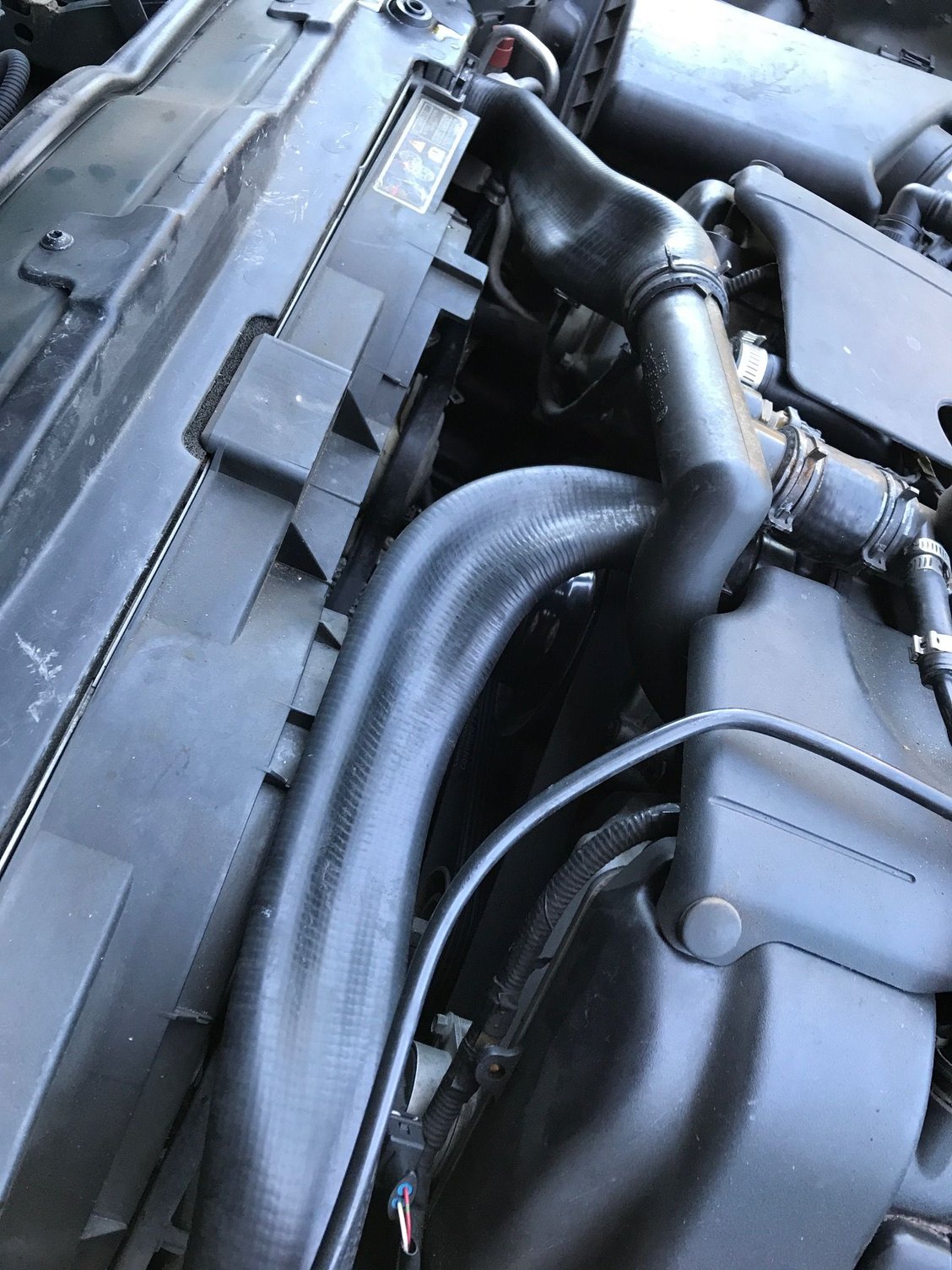

When this first happened, I was driving about a mile from home and the car began to jolt. The "idiot gauge" was maxed to hot, so I pulled off and let the engine cool. When I arrived home (after a couple more cool-down repetitions) I opened the retaining tank (..yeah, I know- never do that..) - the hot coolant spurted up; I covered it back up and when the engine completely cooled down the hoses were puckered in (see photos).
The radiator is flowing; the pump and thermostat are working and the fans kick on when they should. BUT- the coolant looks and smells fine and the oil does as well. I'm very puzzled.

Did you check or replace the pressure cap? Faulty radiator caps, in our case the pressure cap in the coolant reservoir, can cause collapsed radiator hoses and expanded ones too. They're supposed to regulate pressure by venting to and from the overflow tank via the overflow tube. If they don't work properly, the coolant may boil and create steam at too low a temperature. Then after cool down, any pressure might not be released causing collapsed hoses. Maybe this $9 part is all that's wrong. A clog near the coolant reservoir or in the overflow tube might cause similar problems I would think.
