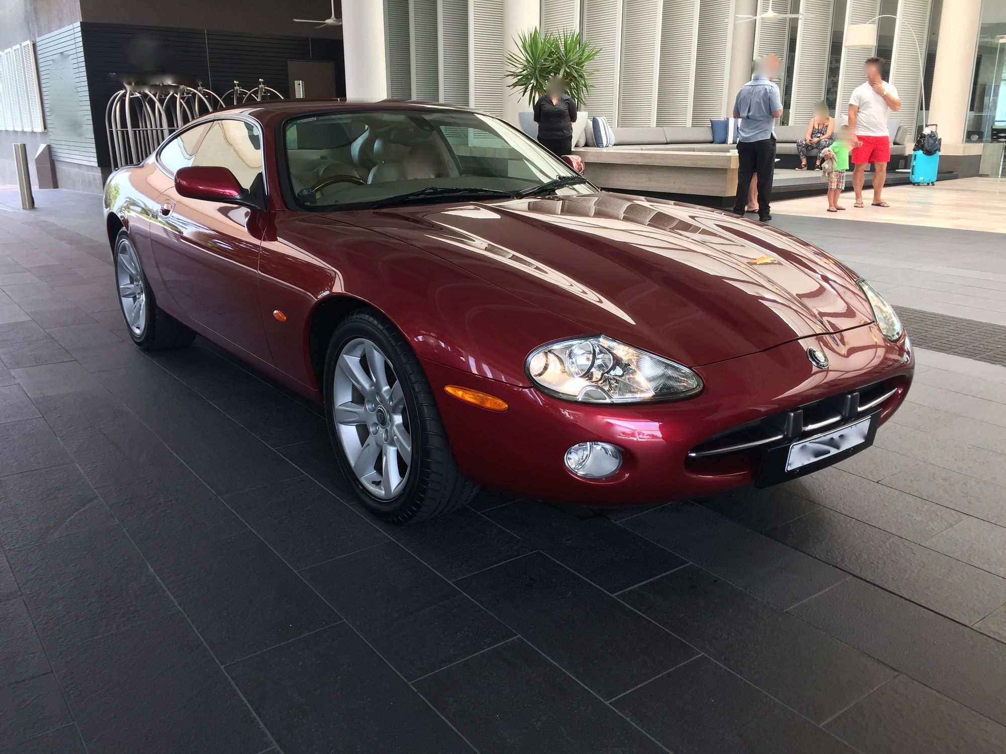

Hi, I have just purchased this...
https://cimg3.ibsrv.net/gimg/www.jag...8f778a5113.jpg
It is a one-owner 2003 XK8 with only 6,000 miles from new. My wife and I picked it up on the weekend and drove it 500 miles home. The car was faultless and we were having a great road trip until close to home we struck some really heavy rain on the freeway. I mean this was REALLY HEAVY RAIN. The heaviest I have ever driven through in 30 years of driving. The road was not flooded at all and I slowed down to about 20 mph until the worst past.
Anyway, we both noticed a very small trickle of water on both sides of the cabin around the A pillar and front of the doors. Then the radio started playing-up and changing stations of its own accord so I switched it off. It would not turn back on again. Then about ten minutes later the Check Engine light came on. The car was running fine and there were no other warnings so I decided to press on to home.
The car seems fine except the radio is still dead and the Check Engine light still comes on when I start the car. Any suggestions? Thanks

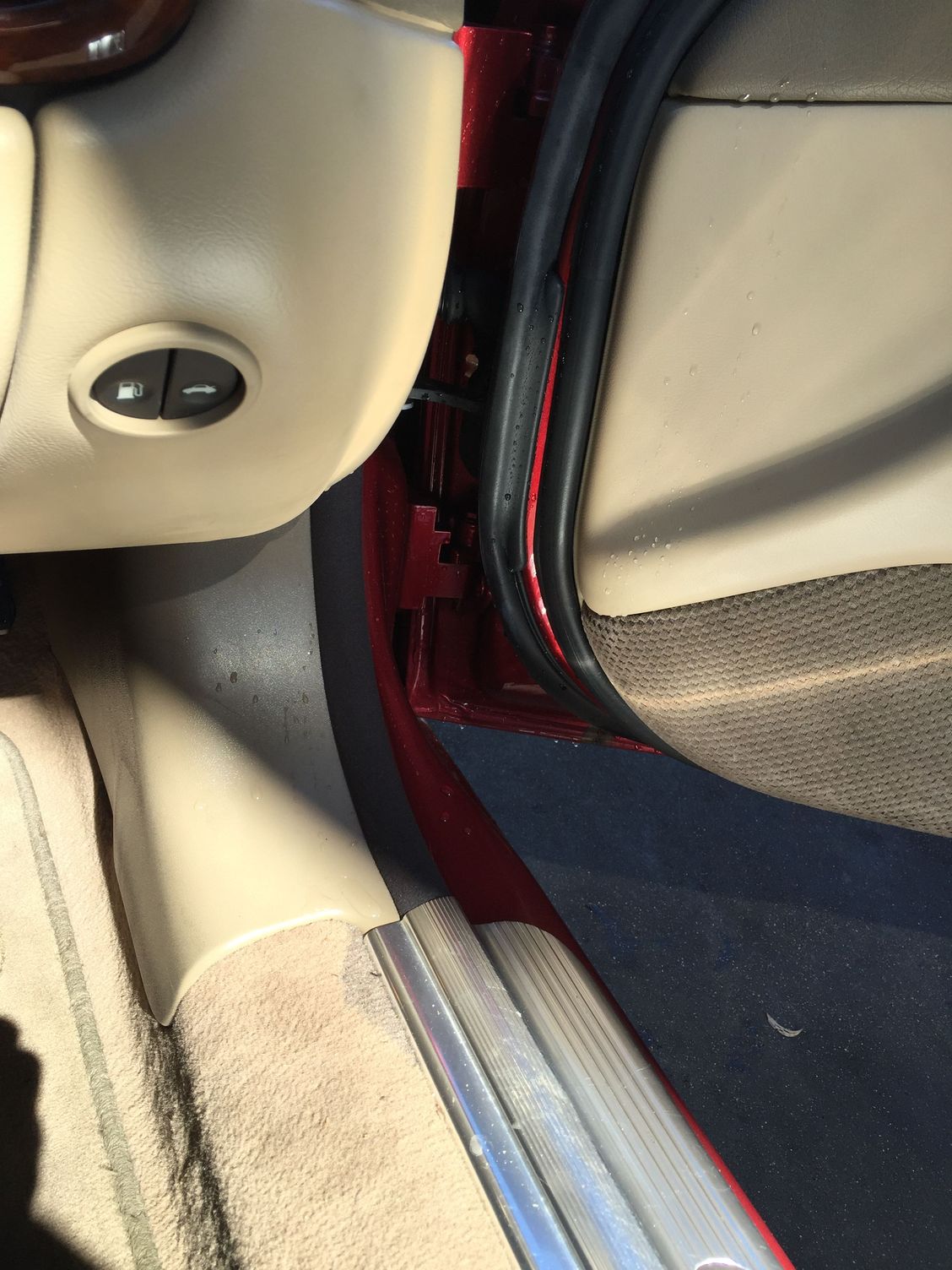

Thanks very much for the advice so far. I went to the carwash today and noticed the same leaks again. You can see the small dark patch where the carpet is wet on the sill.

oyster Dec 18, 2015 10:30 AM
Hi .
I have compared the rubber moulding in your picture with my own, and what I can see looks ok. Still I would check all the rubber strips both on the door and the door opening for any sign of misfit or tearing.
To me it looks that the water is coming from above dripping down, so I would suspect the moulding on top and top forward of the door opening, the one the window slides into when the door is closed.
It can be hard tracing water leaks. I would spray with a hose a small part at the time, starting at the top and look for any moisture.
