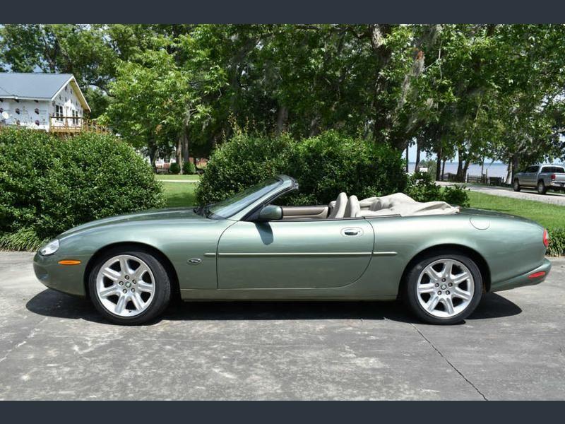

Great colored car you have and a good looking dog too!
