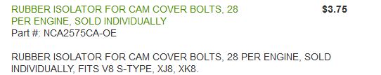

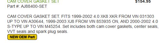

When I did tensioners I used the OEM parts from Jagbits a forum sponsor. I reused the bolt seals on all but 2 they were hardened and brittle. Make sure to clean the cam covers well and check for cracks. Cracks around the bolts are a major cause of leaks. Pretty simpe change out just follow the pattern and torque values in the tech manual

Oh, I just saw the attachments. The M/ Victor Reinz set also included all the spark plug area O ring seals and all cam cover bolt isolator seals.

Order the vvt seals separately they do not come in the kit
