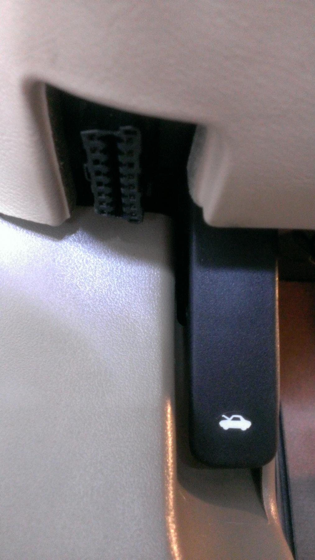

Where is it
I read on another post that the diagnostic connector is close by the bonnet (hood release) catch - "just hanging there" - well I had a pretty good look today and I can't see it. :icon_confused:
Loads of wires but no obvious multipoint connector.
On my 2001 XKR (right hand drive) the bonnet (hood) release is on the side wall of the passenger footwell (would be the drivers side on a LHD car).
Any pointers as to where my connector is located please?
Steve

rothwell Sep 7, 2013 08:57 AM
2 Attachment(s)
On my 2004 LHD car it is right above the hood release.
Attachment 53757
worrasf Sep 7, 2013 11:14 AM
Originally Posted by WhiteXKR (Post 807333)
See lower right corner of dash, shown for a RHD vehicle.
Thank you - got it just where the diag says it should be. Clearly, different placing on LHD and RHD versions.
Steve
