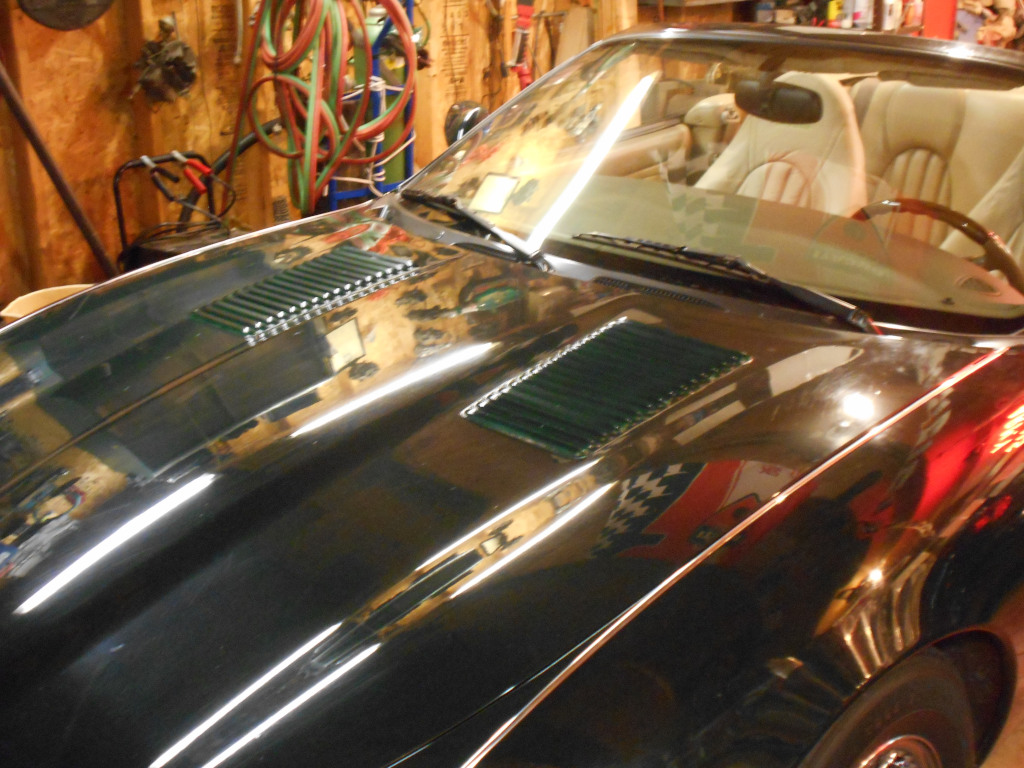

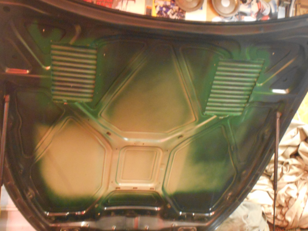

Here's some pics of the louvers Rich. I was told they came from a 1928 Plymouth. Some folks would not cut a couple supports under the hood. It didn't have any effect to how the hood closed or functioned.....Be cool....Mike

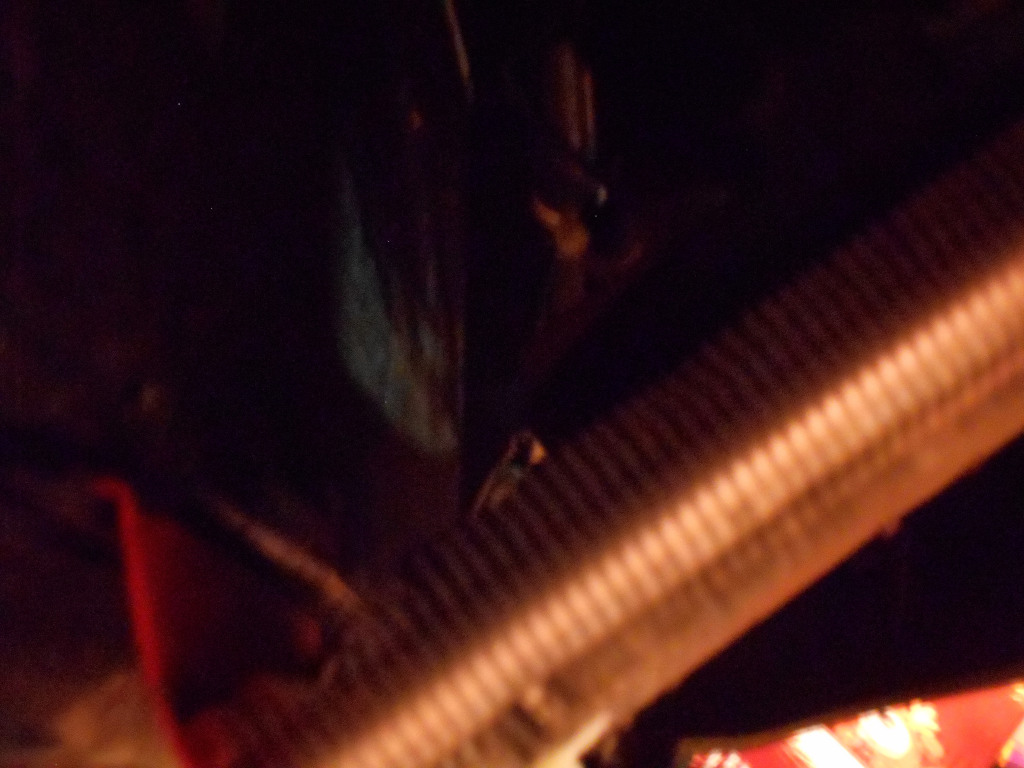

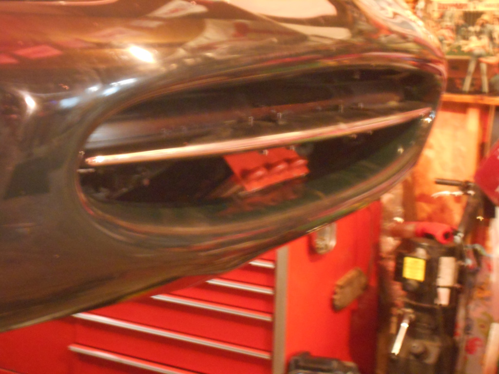

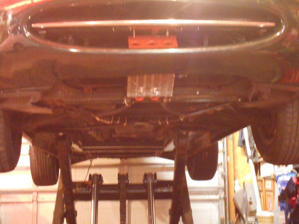

Jag#4.....Here are the pictures you asked for of the trans cooler tilted in front of the condenser. I am sorry they aren't very good, but I shake a little. The pics under the hood are kind of dark, and some of the problem with that is that the fan frame is black. I use a lot of wire ties. It came from a couple of years installing MRIs for General Electric. I must have 500 of them. They came with each MRI package, and you threw away what you didn't use. I didn't. We were supposed to make wires and hoses, so they wouldn't move. I made the hard lines from the trans out of copper tubing. There is nothing to worry about, because the cooling system for the trans only runs at around 5psi. The copper tubing is secured to 2 bell housing bolts, so they do not fatigue. The rest is rubber fuel line, secured to the X member under the engine, to 2 copper tubing clamps to the cooler. The bottom of the cooler looks very exposed in the frontal picture, but it is really higher than the oil pan. I will probably paint the top of the cooler black, so it is not so noticeable. I have a rectangular vent hiding the lower part of the cooler when everything is together, like the XKE had......Hope this helps.....Be cool.....Mike
