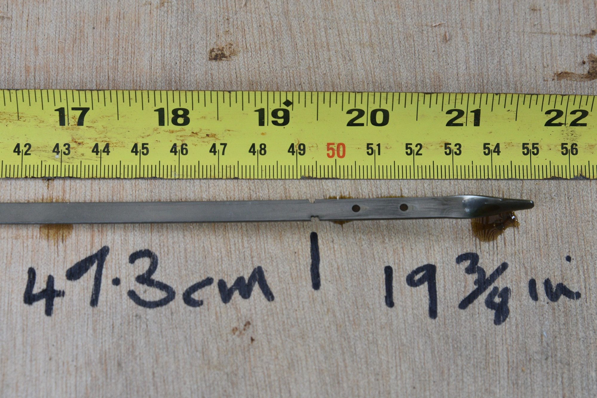

Shows starting point for my measurements
Later dipsticks will have full mark at the higher level.
Its not a valve clearance problem but its piston slap. It sounds like out of adjustment valve clearance because its in rhythm with the spark plug firing as the tap only occurs on the unloaded part of the piston movement. If you dont have the piston slap yet then to avoid it you need to increase the oil level as Jaguar Directive. If you do have it then increase the oil level ,add Molyibdonem oil treatment or consider increasing the oil viscosity. There is no vehicle component called a tappet. As there are two variants of dipsticks fitted the photo show you how to check ..small knick in the stick at the new level.

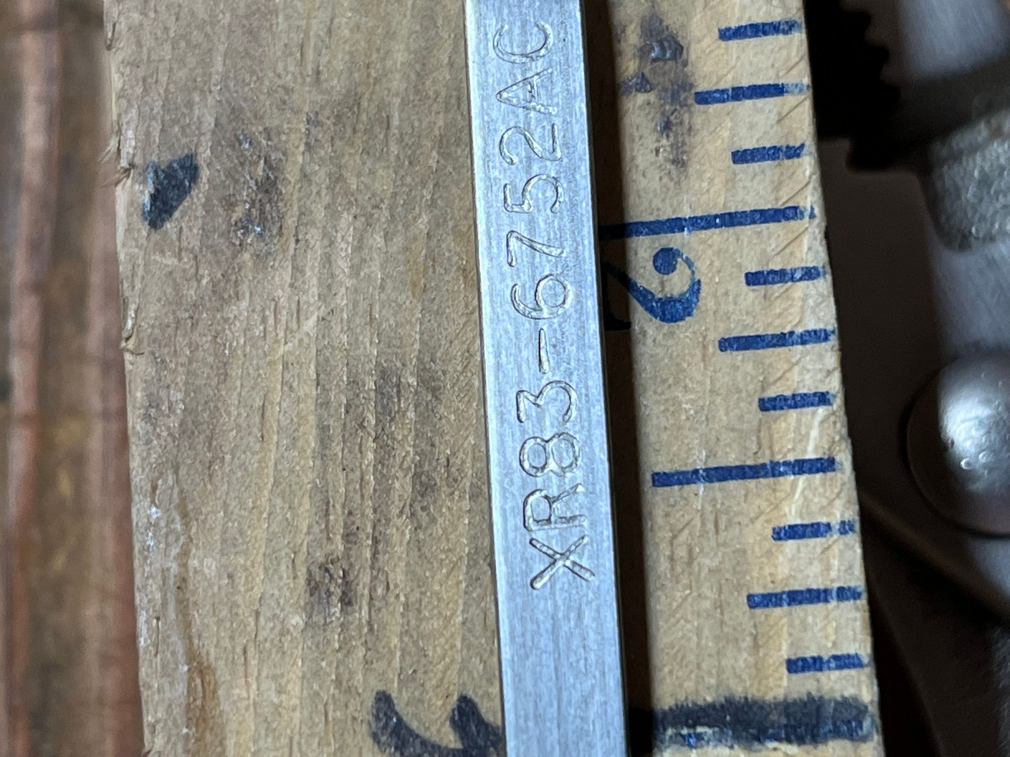

As to the dip stick, I may have misunderstood but according to Tech Bulletin 100-17 to ensure the additional 1 litre of oil the correct dip stick is part XR8-2806 and that has no notch in it. This applies to early 4 litre V8 emgines.
However, the TB may have been superseded?
Old Mar 27, 2022 | 11:13 AM
zray's Avatar
Joined: Jan 2018
Posts: 3,741
Likes: 2,333

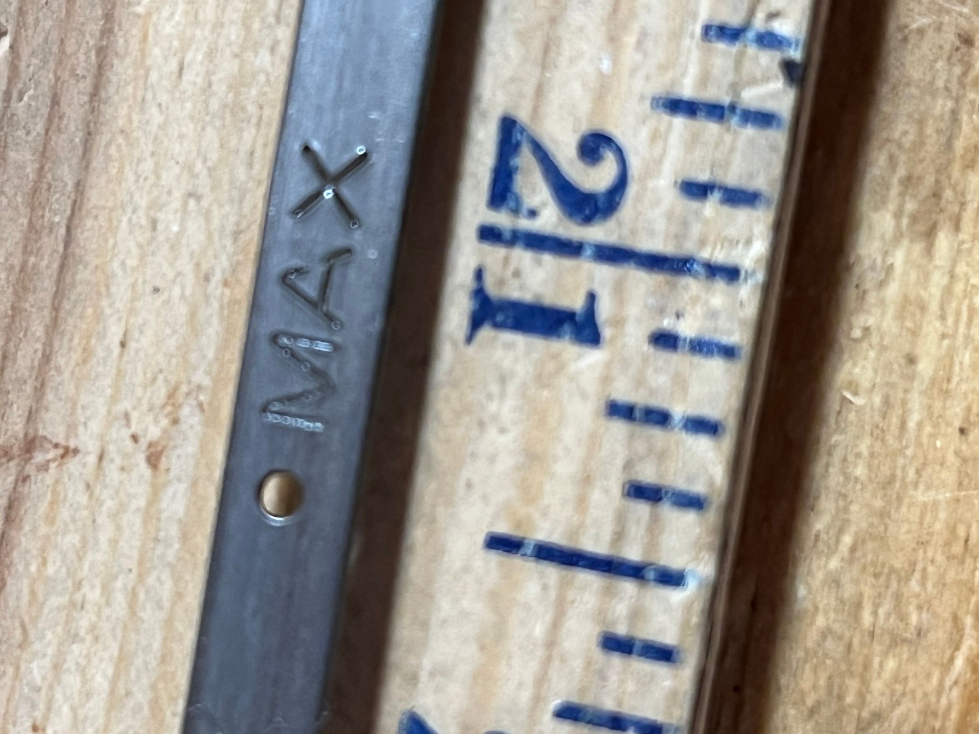

It’s my understanding of the post that the notch was added by the owner
Z
Old Mar 27, 2022 | 11:16 AM
drmike's Avatar
Joined: Nov 2013
Posts: 563
Likes: 90
From: Worcester UK
Ah, I see.

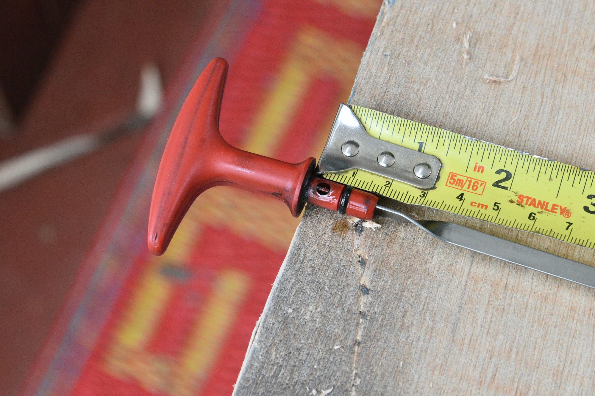

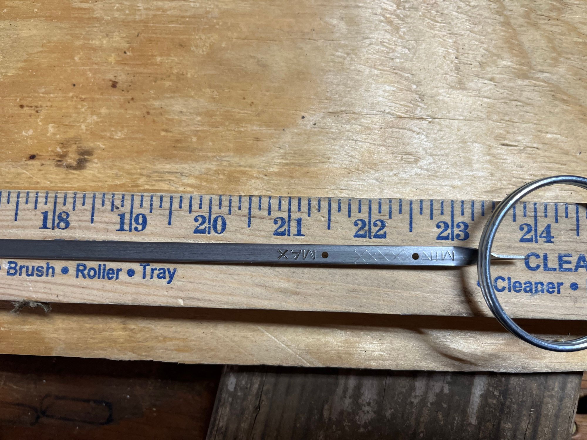

Originally Posted by Pistnbroke
Click like a tappet knock ( Excess valve clearance noise
After seeing the above photos I took photos of my 2002 XKR engine oil dip stick and measured the distance to the fill line using the same starting mark as above photos. Unsurprisingly, my distance to the full mark @ 21.5” / 54.6 cm was totally different.
Note: it takes me about 7.75 liters / 8.2 US quarts of oil to fill to the MAX line during a oil & filter change.

I have a 97 XK8 4l non turbo . I know jag raised the oil level 1 quart and offered a revised dip stick..no numbers on mine. Could be a different sump, different dip stick tube or more baffles in the sump to help the pump during cornering. I am sure michaelh can find the advisory .
My stick has no number on it.
