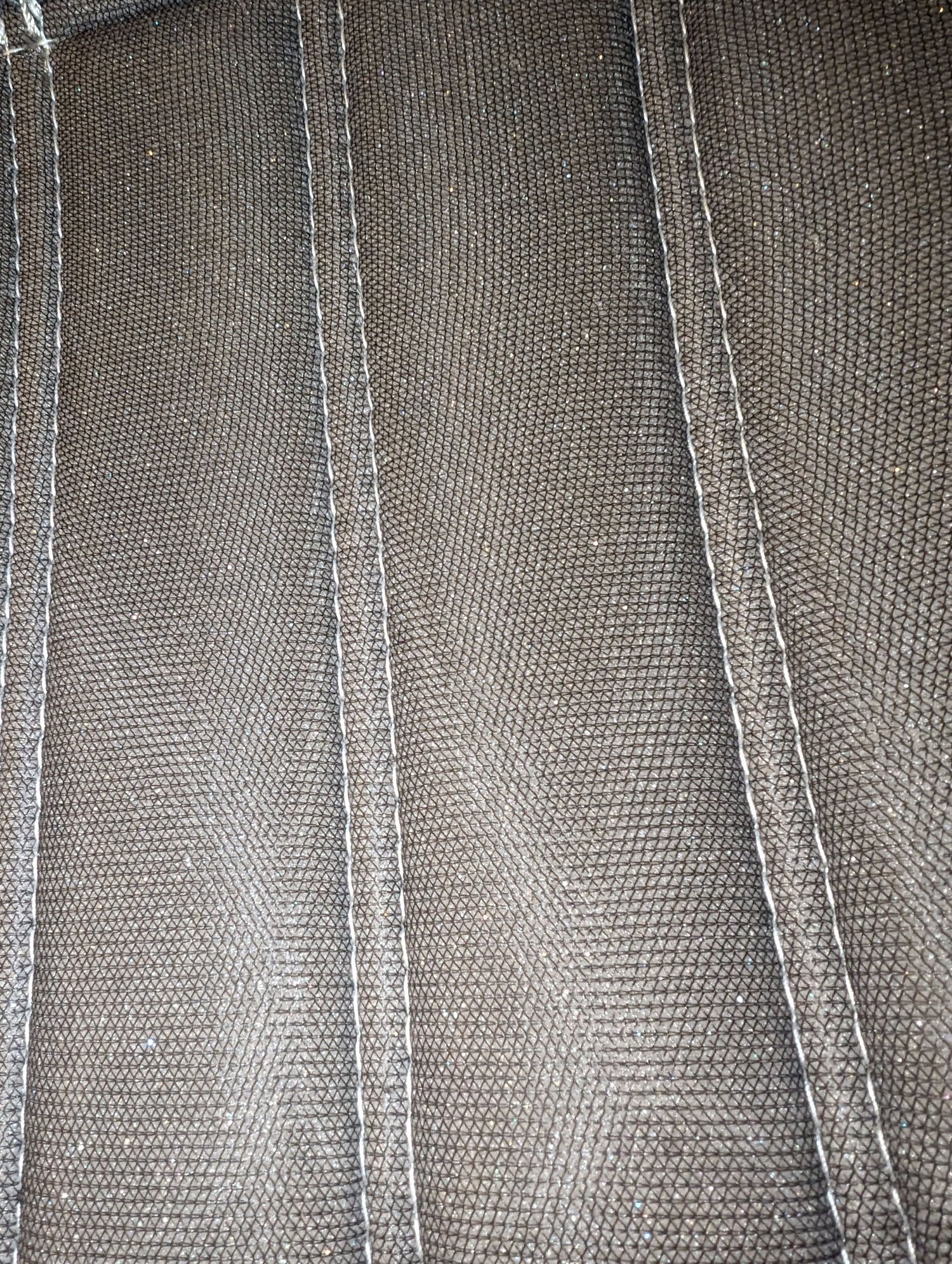

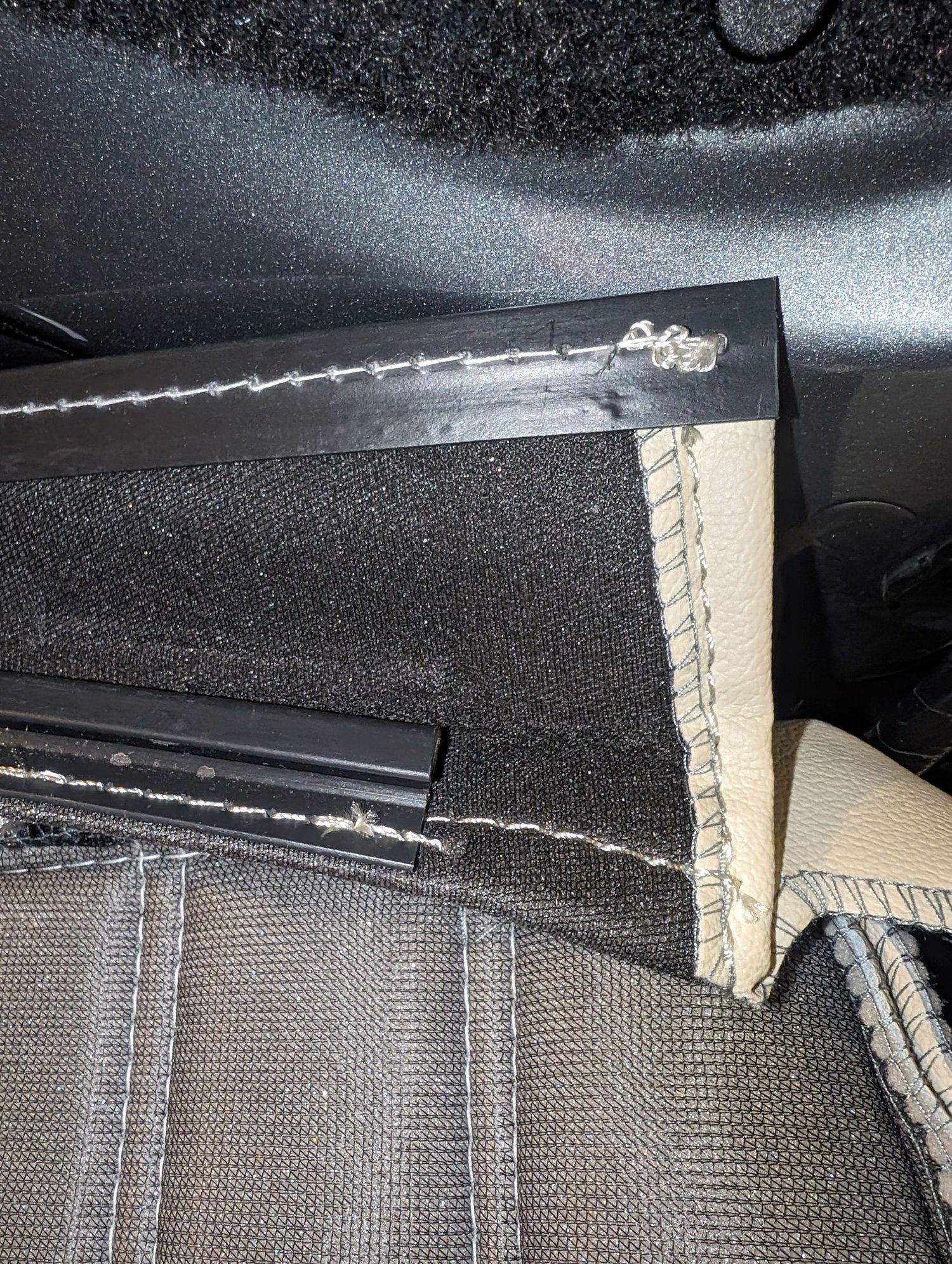

Would you be so kind as to take a few. close up detail images of the face and back of some stiching?

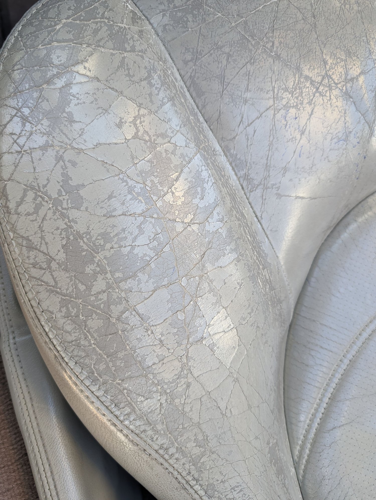

Here are some pictures of the seat before and after re-skin, and some photos of the back and face of the stitching on the passenger seat skin that I need to put on. As you can see from my seat before I did it, it is an improvement.
I also have some photos of my (good) passenger seat for comparison with OEM. Obvs, LSeat.com is no-where near OEM quality but for $300 I am pretty satisfied. My car is a daily and I intend to drive the wheels off it, so it is good enough. Considering an upholstry shop or a much better upholstry kit would be $1200+, and I am not in a position to spend money like that on upholstry right now, I am satisfied. The new leather is also a lot grippier and I slide around a lot less.
Also someone in the UK is gonna get lucky cos I will be going there in May/June and fully intend to pass my good condition right-hand seat OEM cover (oatmeal) onto a good home for a reasonable-verging-on-robbing-me-own-granny price.
I will say, I feel like these look a lot better in the light of day with the top down than they do in photos. Cameras tend to bring out every flaw. I am glad I had re-done some miata seats before taking these on. I did not use hog rings, instead I used zip ties, and I regret nothing. Took three attempts to get the cover on satisfactorily. Passenger seat will be much quicker.

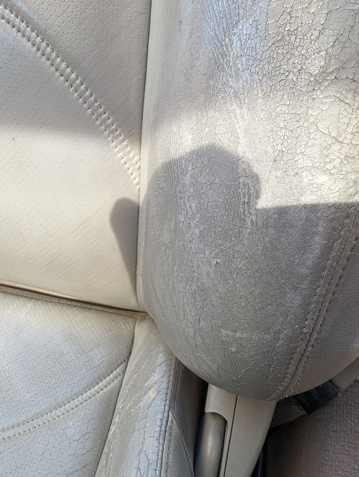

Old seat. cracked and worn.
bolster worn almost through the leather. This seat has been repaired before; it has not lasted.
cracked squab.

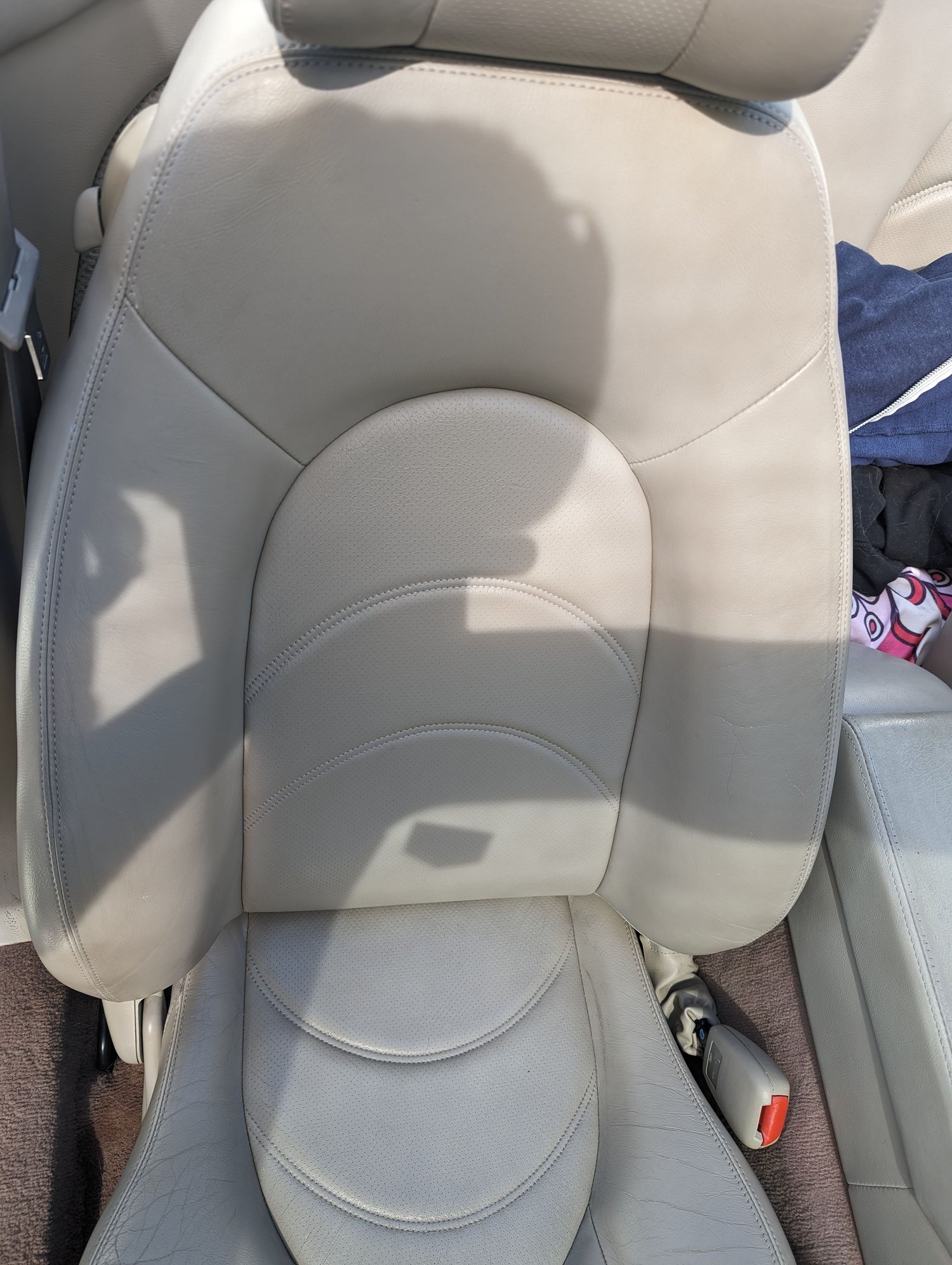

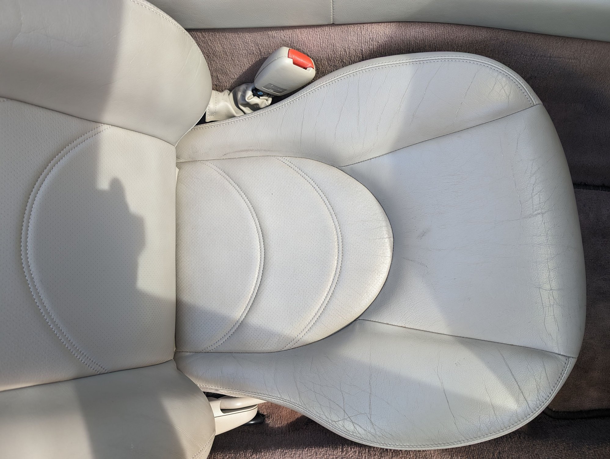

OEM passenger seat. Much better condition. I hope this will make a nice driver's seat for someone in the UK.
another passenger seat for comparison

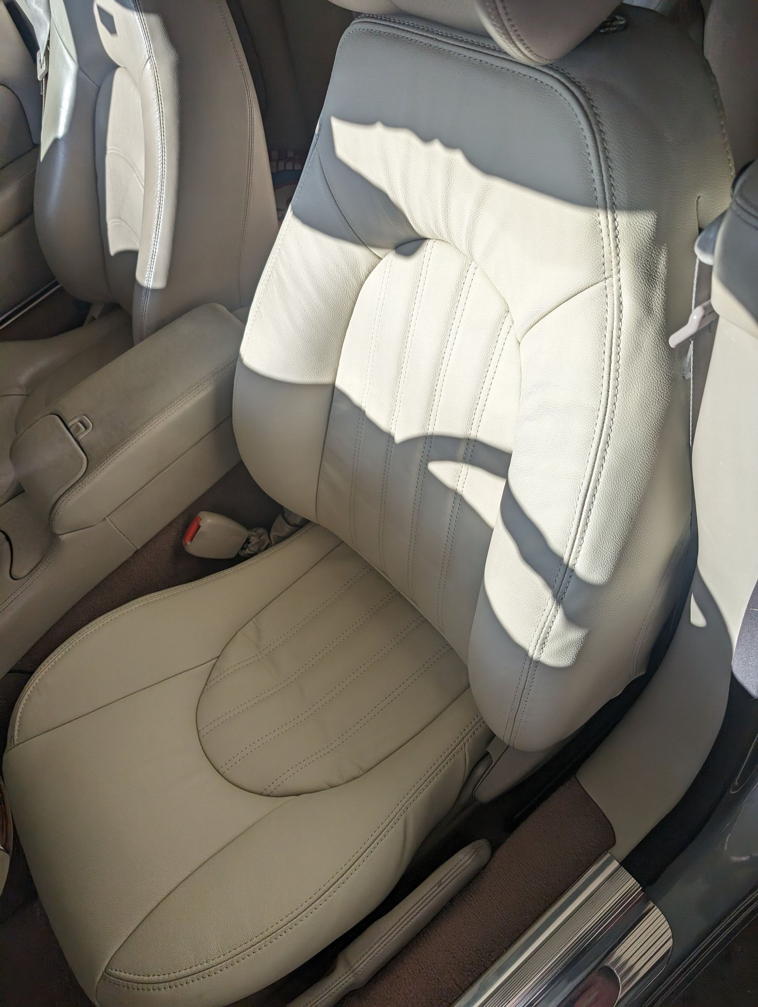

re-upholstered driver's seat in daylight.

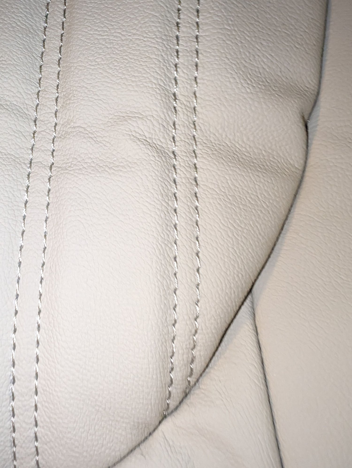

squab close up

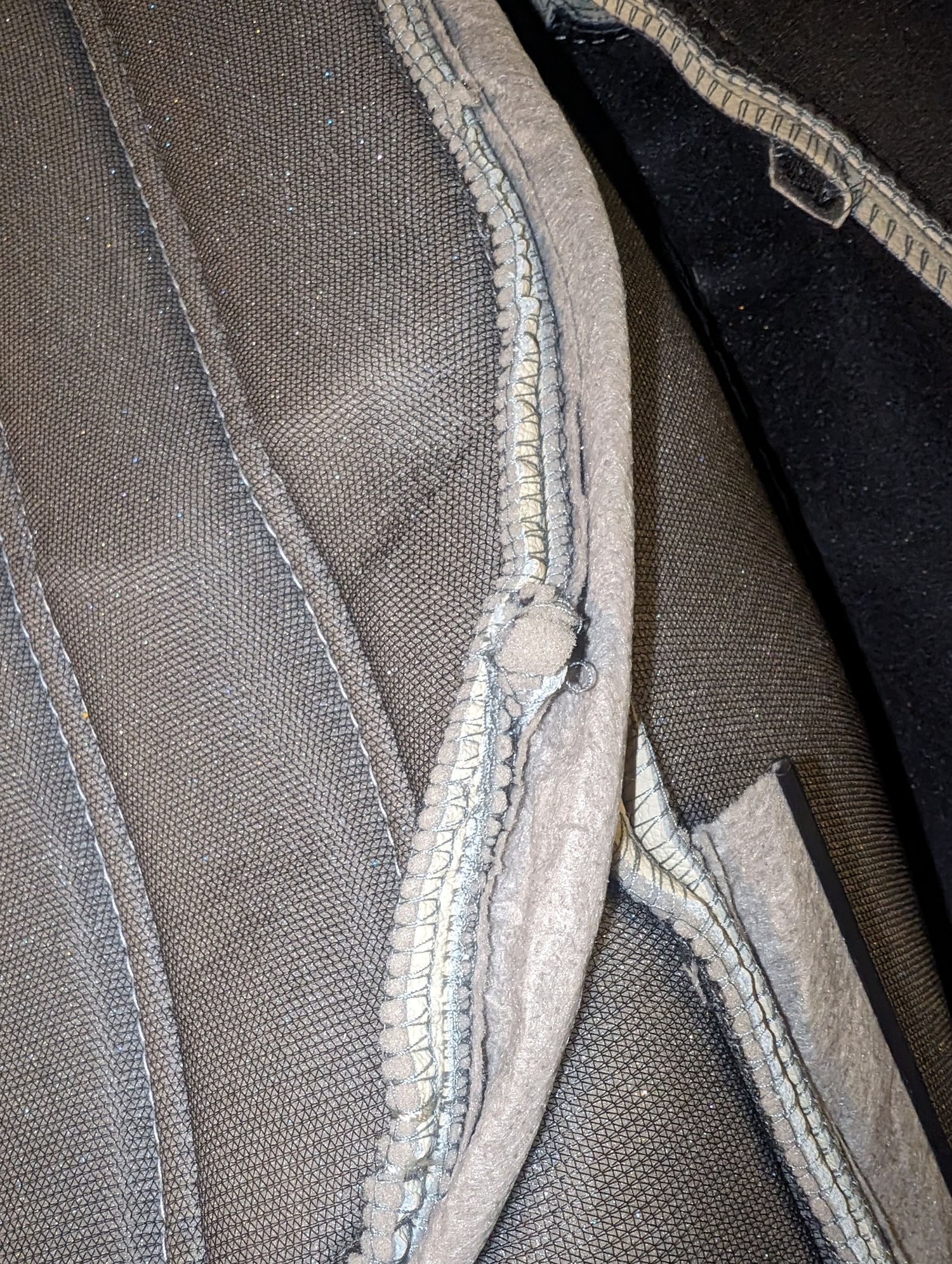

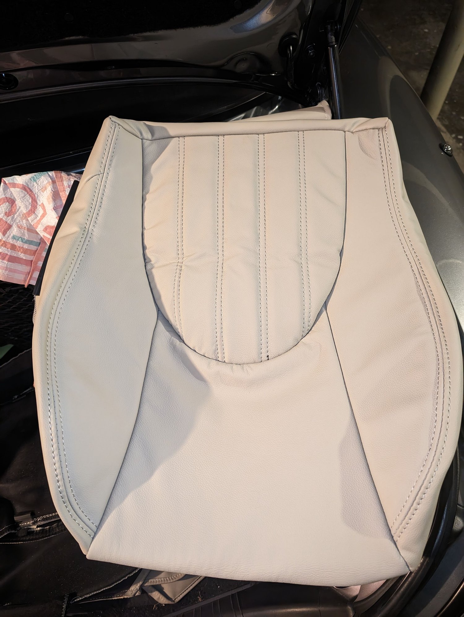

Now some detail shots of the face and rear of the replacement covers before install.

You should be able to get rid of the wrinkles in the seatback with a heat gun, maybe a hair dryer.
yeah it was 8pm by the time I finished and my fingertips were bleeding, but I'll give it a go. I was also gonna try going to lunch and parking it in hot sun with the top down
I also managed to forget to put the wooden board back in the back of the seat but I'd clipped up the seat by then and decided it could wait.
another thing I found helped was working up and down the seams and making sure they all sit evenly on one side or the other of the foam so they don't get that wiggly appearance.
also when attaching the covers to the seat foam with zip ties (instead of hog rings) I alternated from side to side to ensure they were uniform, and fed in the zip ties beforehand so they would be easy to thread through and ensured the clips faced out so I could snip them and rotate them round to the back of the seat. zip ties are also great cos you can hook everything up and cinch it down progressively. I did that three times before I got the technique down right. passenger seat should be much quicker.
