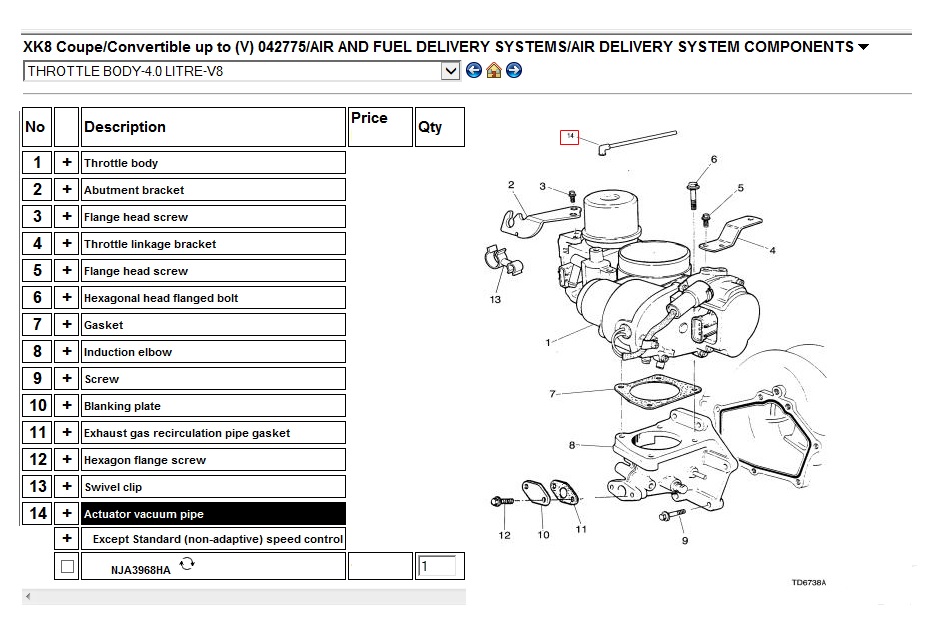

1. On the throttle body there is a vacuum hose that should be connected to a black cylinder on the top of it. Mine is missing so where does it come from so i can replace it. ......
Assuming you refer to Item 14 (Actuator Vacuum Pipe)?
I haven't had an XK8 with this early pattern TB but the Parts Catalogue suggests the Vacuum Pipe is only fitted on vehicles with adaptive speed control.
I'm sure someone with direct knowledge of the early TB will be along to tell me if this is gibberish!

The vacuum hose on top of the throttle body is cruise control. The hose runs to some control valves located inside the right hand side wing ( looking from the drivers seat ) You need to take off the wheel arch cover to see them. There is another hose that runs from those valves to the back of the engine just under the throttle body, which is the source of the vacuum.
If your car has the cruise control option, you need these hoses and control valves to have it work. If the vac is missing, you will get an engine fail safe mode when you switch the cruise on. If you do not have cruise, just ignore it. The throttle body may have been changed at some point and the cruise part of it redundant.

Hi yes the actuator pipe. I wondered why i got engine failsafe mode when the cruise was on. Cheers guys I can now trace those pipes and sort that out.
