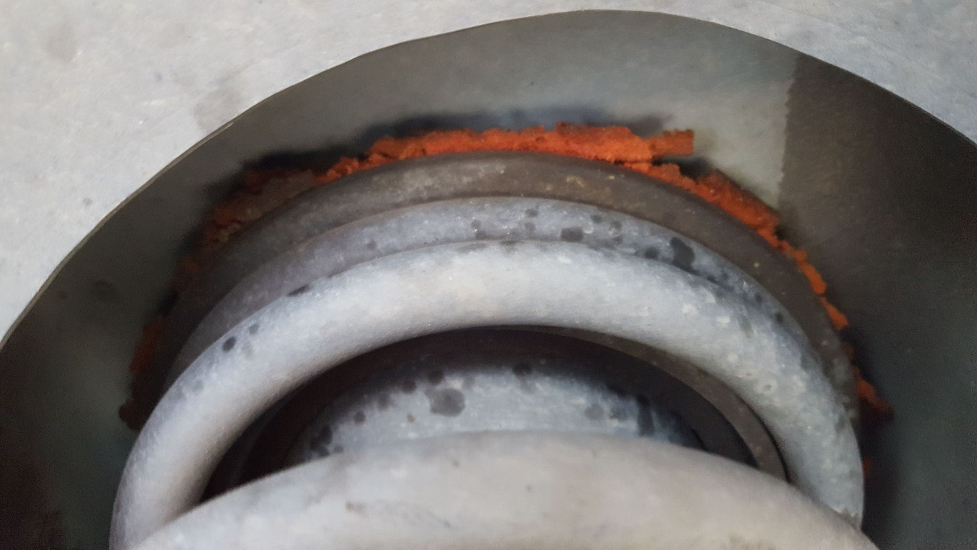

Om28v Aug 15, 2017 06:47 PM
https://cimg3.ibsrv.net/gimg/www.jag...7c3c9a3ea0.jpgComplete toast.

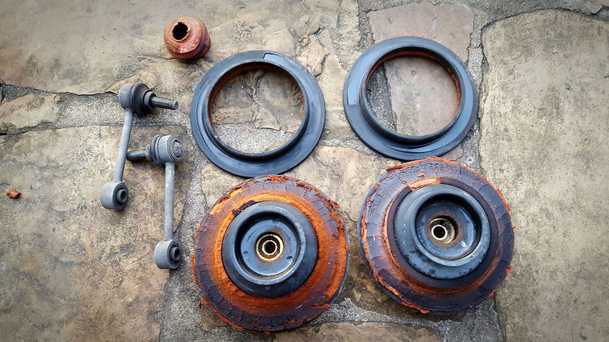

Om28v Aug 16, 2017 08:53 PM
The nasty bits are out. I thought my sway bar links looked pretty good that were in there, but they were cheap, and we had a member say they got a huge change after doing these links. The old ones aren't even close the new ones from Welsh, where I got the poly top shock mounts. The old ones were in bad shape it turned out. Wouldn't kill you, but it has to add to slop. 20 minute job...tops.
The picture shows the old mounts and links and what's left of passenger bump stop.
The bump stop is made of the same deluxe rubber foam the towers have in them it appears.
If you don't have air, don't do the spring compressor rental/free from AutoZone. You could kill yourself. I did finish the drivers side..but am getting the passenger side pressed tomorrow. They are beasts with no air tools in this configuration.
If you own sockets and understood bolts, I you can do sway links in 20 easy I think.
If you want to do the towers, you need to understand bolts, big ones, suspension forces, and have nice lifting things. I really didn't think it was that much harder than some starters I've replaced for friends. Except those spacers.

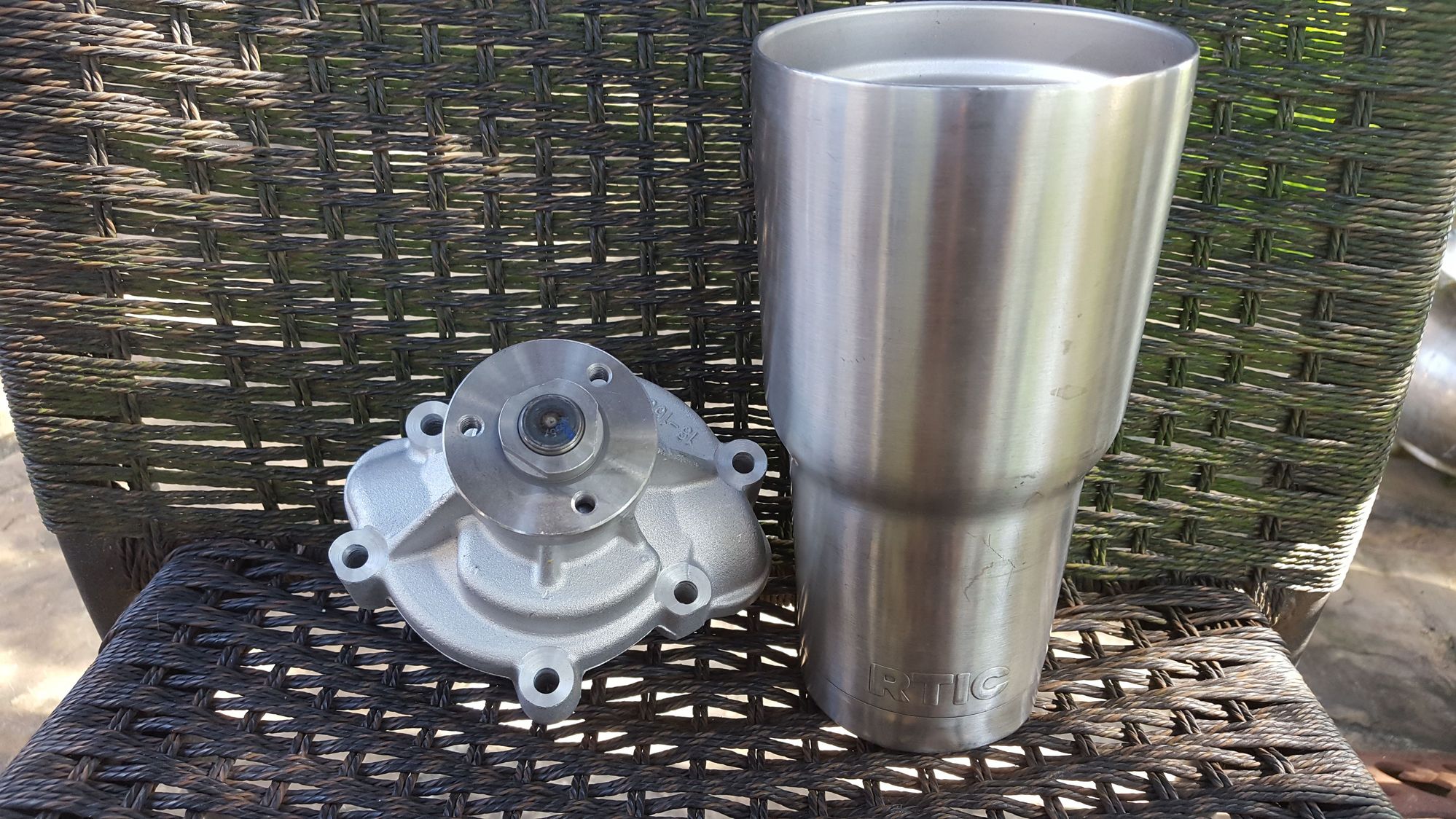

Om28v Aug 17, 2017 04:29 PM
https://cimg2.ibsrv.net/gimg/www.jag...7b7d33a175.jpgShockingly tiny water pump
