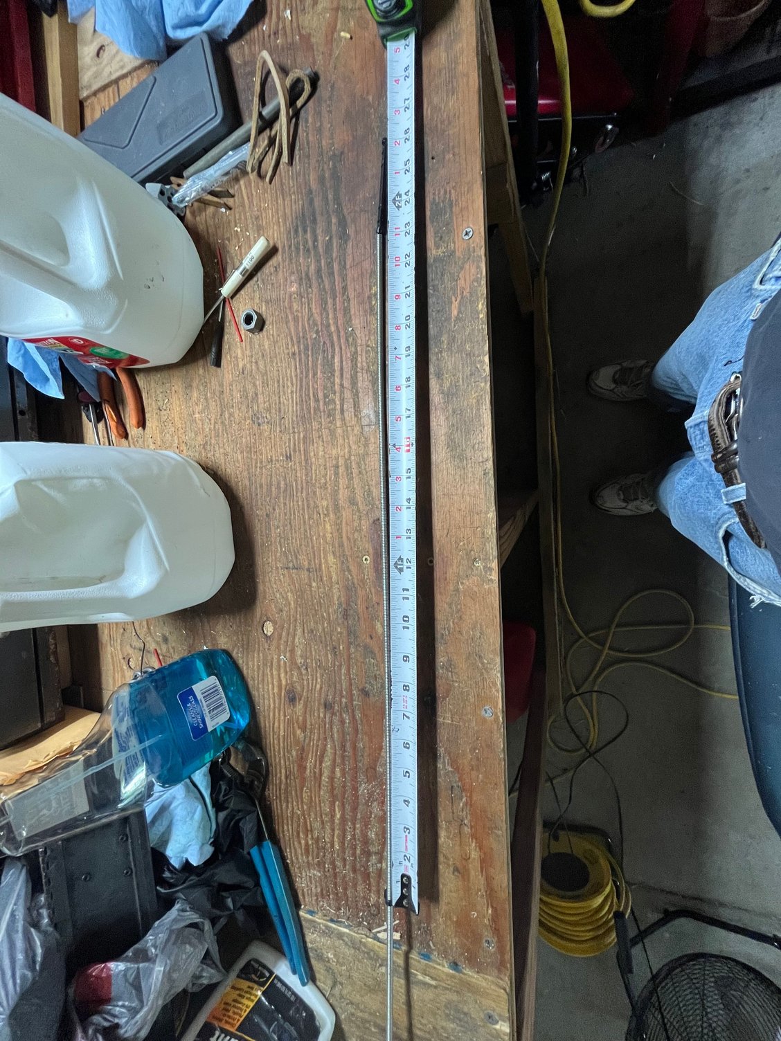

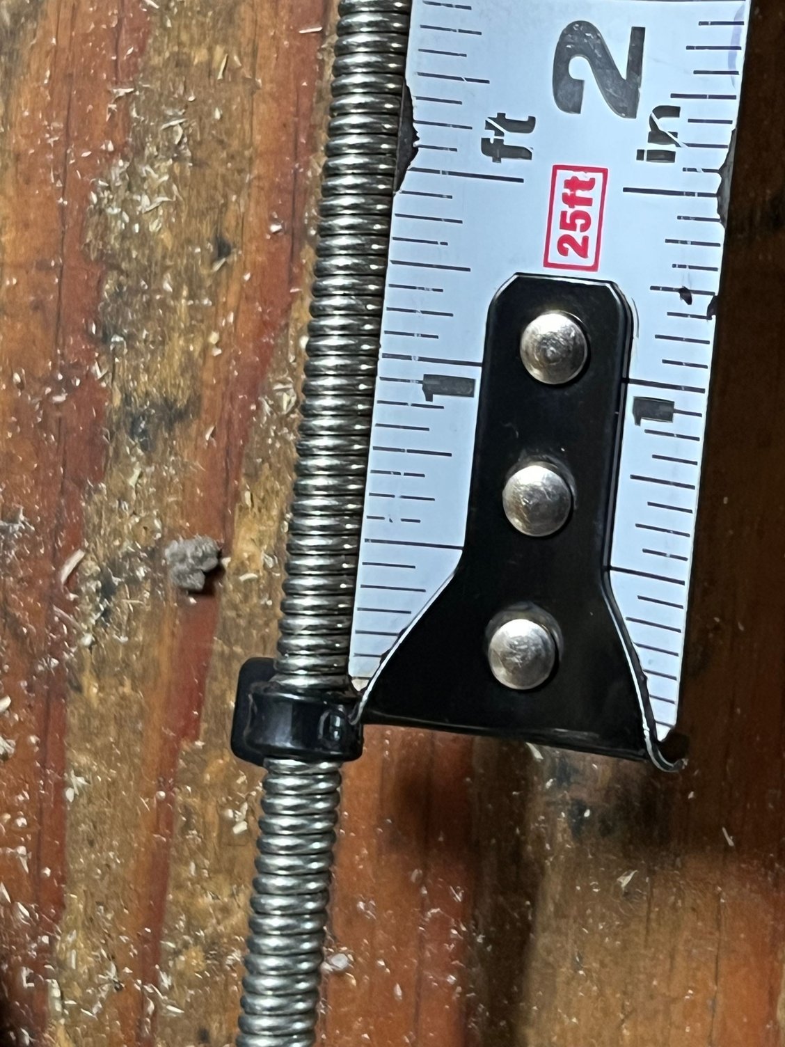

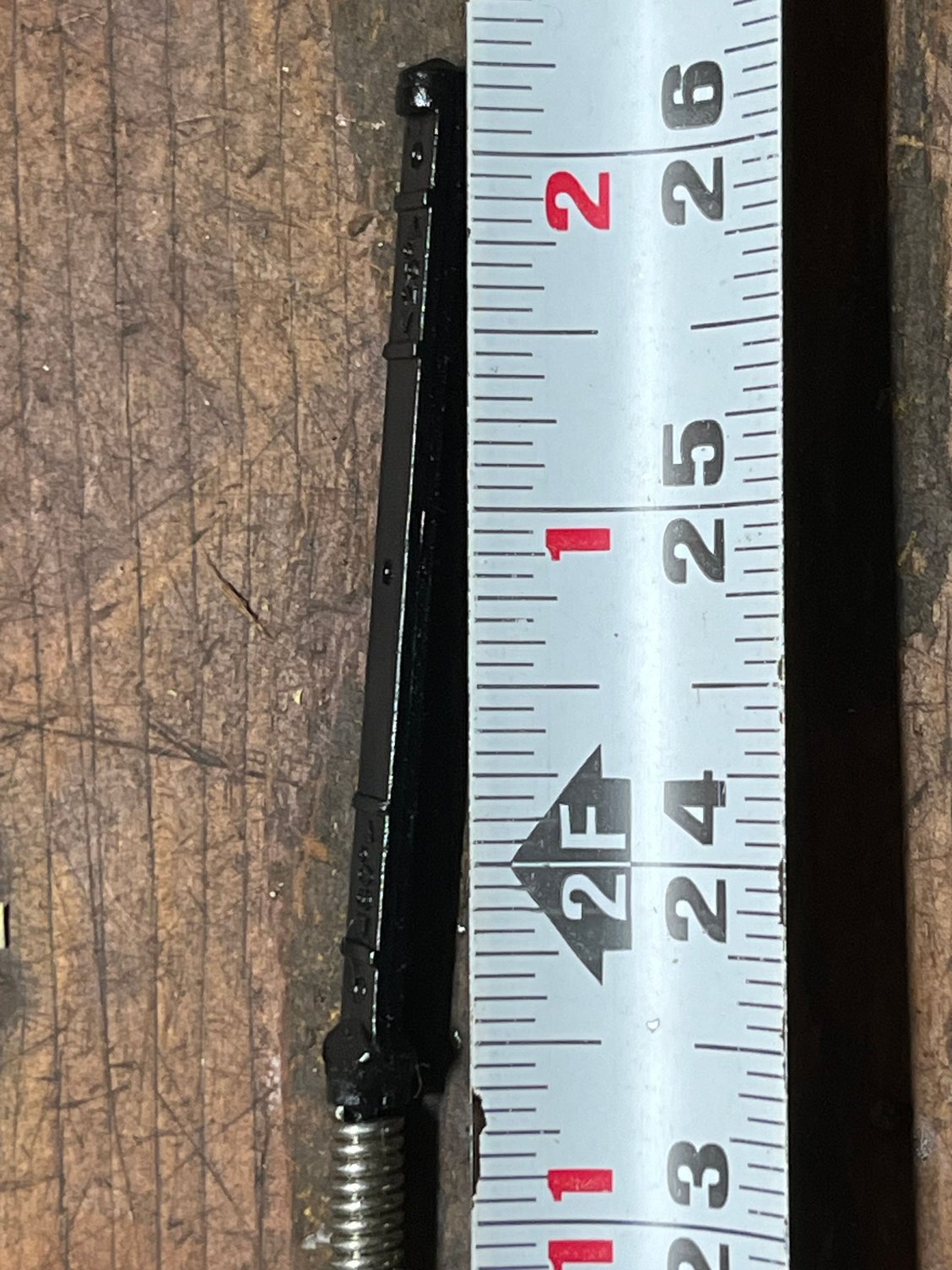

About 26.25 inches or 667 mm of my A/T dipstick will be “in the tube” before it bottoms out.
I learned on this forum that the end of dipstick does not actually touch bottom, but that the ears or notches near the end of it prevent it from going in any further,
