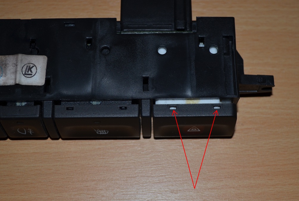

steveinfrance Mar 2, 2013 06:13 AM
2 Attachment(s)
The problem seems to be there is a long plastic plunger bearing on a rather feeble keyboard type switch which, once the grease gets old + dirty, doesn't have the willpower to push the plunger out.
FIX
Use the Rev Sam's console removing video - easier in later cars since the shifter bezel is held on by four small Allen screws.
IMPORTANT
You MUST pull the console horizontally to the rear of the car until it clears the switch/radio cluster.
If you don't you will break the feeble plastic housings it slots into. Grrrrr!
Once you have the cluster unscrewed (6 phillips, don't drop them into the transmission tunnel) you can unplug the switch module with DSC, Hazard etc. and take it somewhere warm.
Remove the PCB from the back, then follow Graham's instructions to remove the front of the switches.
With a fine screwdriver lift the body clear of the little locking tab (arrow)
https://www.jaguarforums.com/forum/a...1&d=1362226155
The plunger can then be pushed backwards out of the body and body + plunger cleaned and given a dose of silicone spray.
Do the same with any switch plungers that feel sticky.
That's it.
