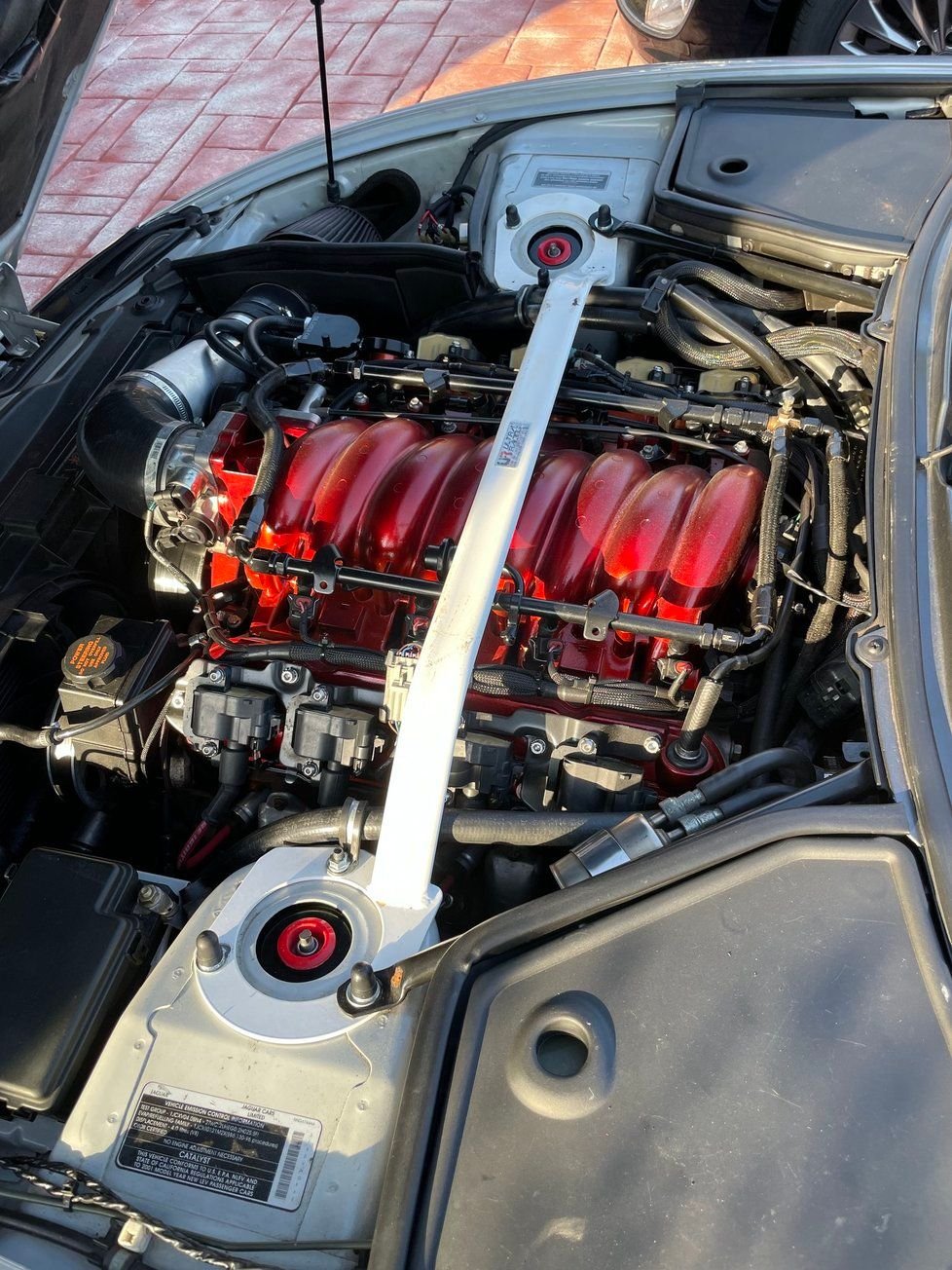

I can tell you what it takes to put an LS motor and transmission in your car I absolutely LOVE the difference it made in my car in power and reliability! I want to try go with a manual 6-speed in the future.

Since you've done it, if the engine had dry sump could you lower it in the frame enough to allow for a whipple ---- without a hood scoop?

Interesting! I will have to take a look and see. Right now the hood insulation just touches the front edge of the throttle body, so it's a tight fit. I'll have to do some measuring and see how high off the block the hood clearance is front and back and see what the crossmember and motor mount situation looks like. You never know... one of these days I may have to get a supercharger and 6-speed manual
