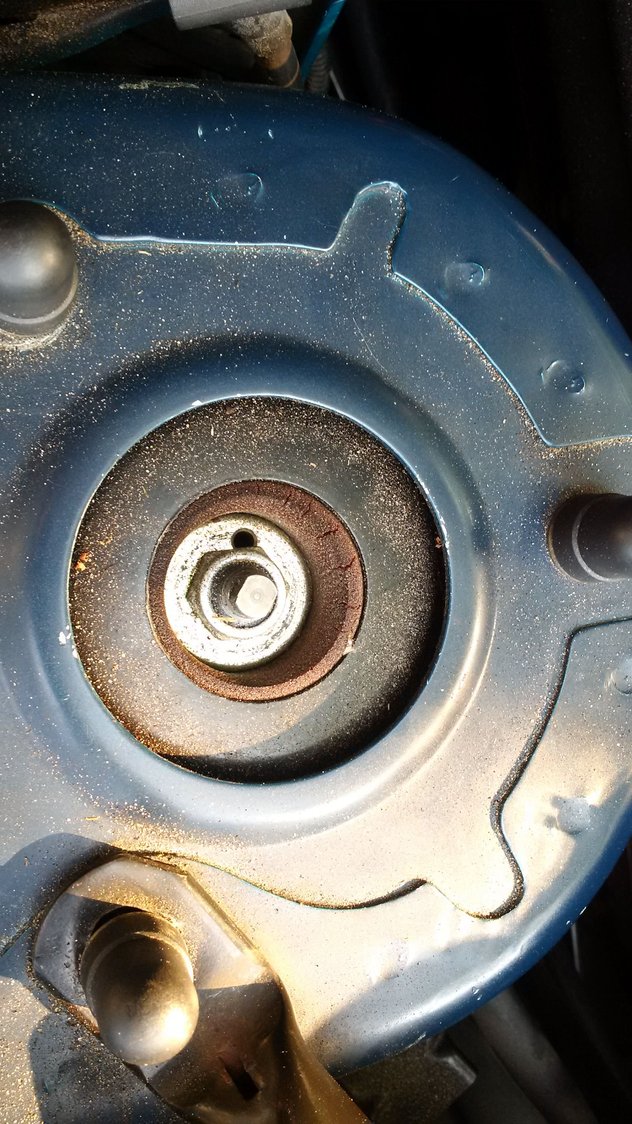

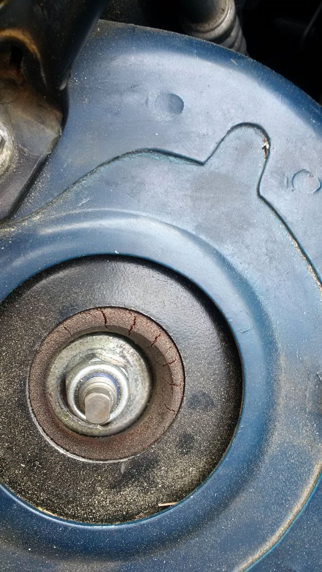

yes - sounds like the upper shock mounts are shot!!! There is a brace that runs from the shock tower toward the windshield. With the shock mount gone, the upper plate is now able to move rubbing against the top of the fender well. This noise is now transmitted via the brace into the dash as you are hearing. Pop the hood and look at the shock mounts - you will see the foam disintegrated around the center shock bolt - I've posted pics from mine showing the failing foam - the bolt should be centered within the foam and you can see it is not along with the cracks and foam bits. This is not as bad as the first time I replaced them as there were chunks of foam just laying around the bolt
Thank you for your response. I just had the upper shock mounts replaced. I didn't do it at the dealership....Trying to save money I went to a family friends shop. I'm taking it back to him in the morning. Do you think he didn't tighten the top bolt enough? It didn't make any noise the first 100 miles but now there is definitely loose somewhere. Hopefully it is something that just needs tightening. I hope.
