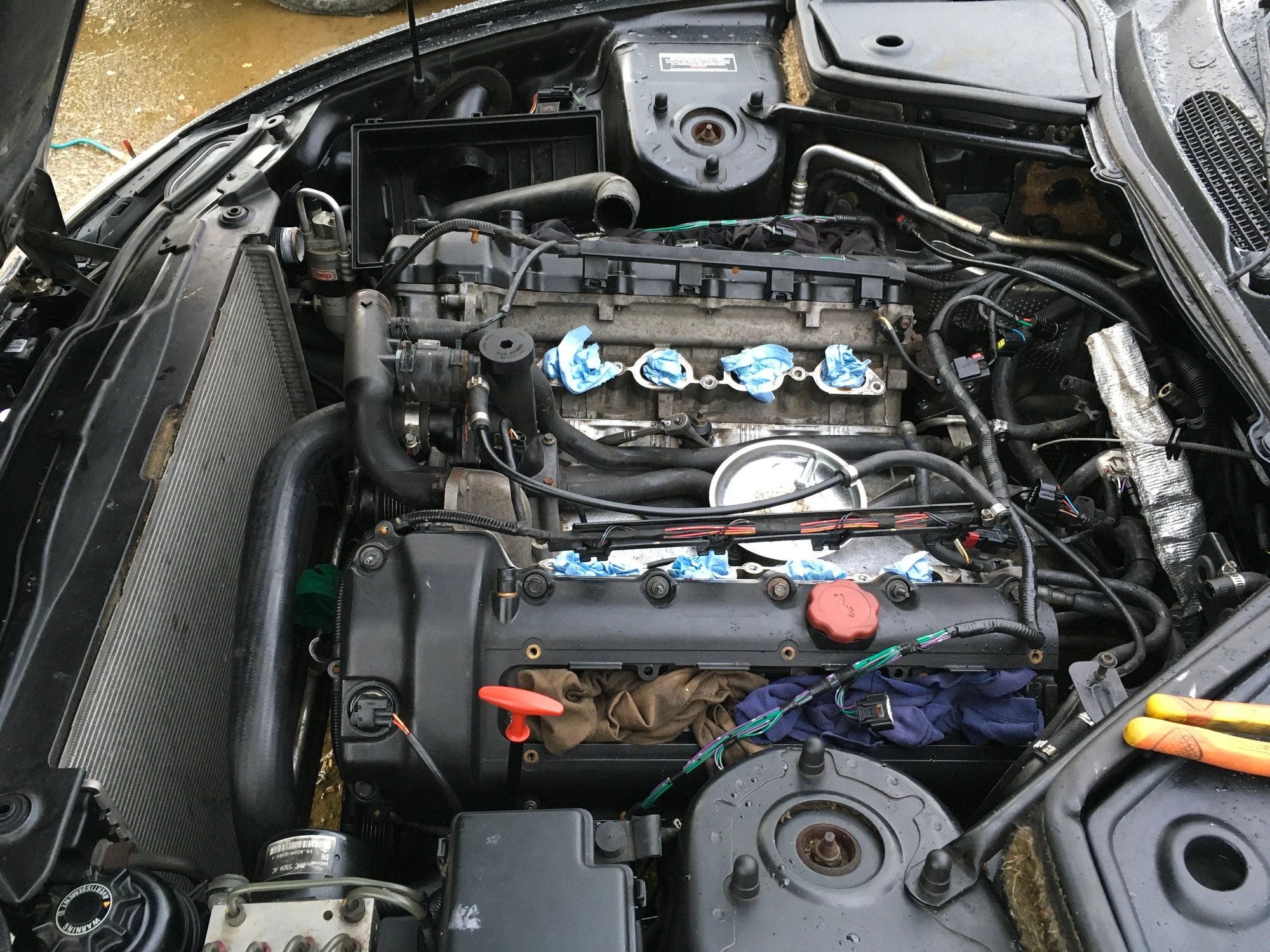

Made some progress today, in between the autumn rains. l noticed a few things that may assist those that follow.
Before you put the cam clamp bars on, put a dab of grease or assembly lube on the cam flats, with the spread you can be sure that you have them flat.
Your kit will probably contain 4 bolts, these are for the primary tensioners as the mounting tower is shorter. DO NOT USE the originals they are too long.
The safety pins on the secondary tensioners are plastic, i can see them breaking so take some load off with a lever while pulling the pin.

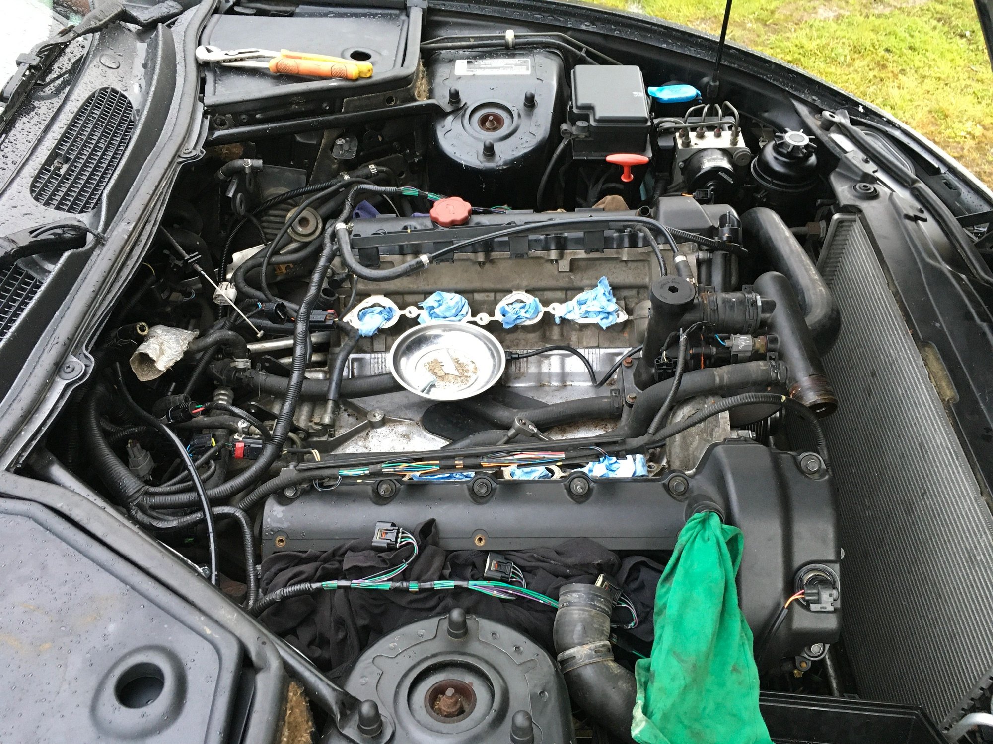

Some more progress today.
Found out that there was a different bolt size used for outer chain guide securing bolt on bank A, The 1999 XK8 is a M10, some of the later heads are M8. The good news is its tapped into a closed void so you can drill and tap it in place, not ideal but not the end of the world.
l noticed that the chains are very very snug in the aforementioned outer tensioner width wise, it may be due to the aftermarket parts it dont think its the end of the world i will just do another oil change after a couple hundred kms on top of the shortly after it runs again one.

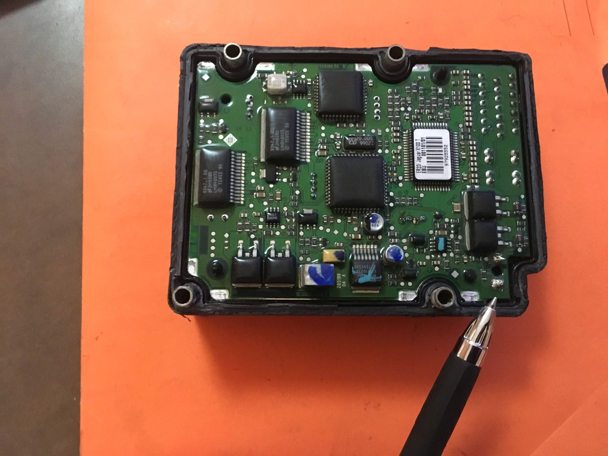

l repaired the ABS module by re soldering the ABS motors power poles. Mine was a little different and seemed to have a protective rubber coating that needed dealing with. The lights and warning messages are now gone, and i have operating abs and traction control systems. Being that i had messed with the integrity of the system it seemed like a good time to flush the brakes and whilst the wheels where off a good time to service the calipers and lube the half shaft UJs.....a gentle day later.
One thing i did notice was that under magnification the soldered joints on the power poles where not fractured like the pictures online, more a very feint grey tide mark.

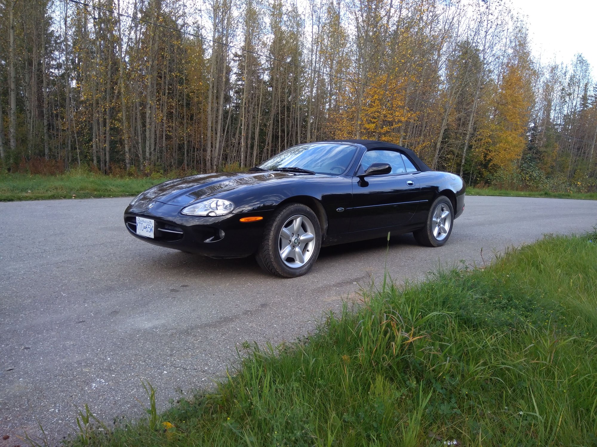

Re finished the hood with 3 stage ''Renovo'' system from the UK, very happy with that, followed by very light cut and polish. l figured out why the hood latch light was on, a washer was in one of the latch wells, left there by the ''shop'' that dealt with the initial burst line, i love these sort of things, makes me wonder what other Mickey Mouse repairs have been done. Having done around 500kms i did a compression test and all within 12psi of each other, good enough.
Anyhoo, the reward, no lights of misery and imminent fiscal pain. Next trans and diff fluid swaps.
Best view in the house.
