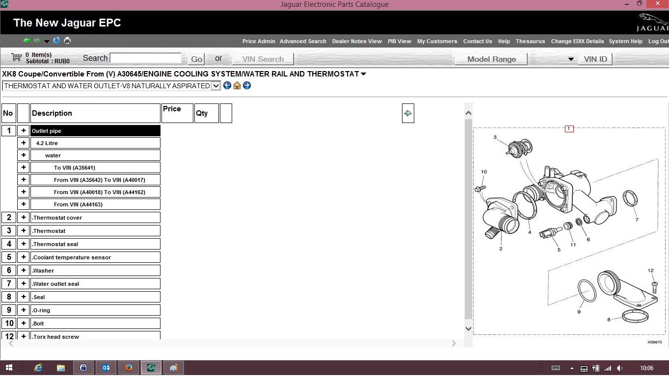

GGG Oct 16, 2014 04:14 AM
1 Attachment(s)
The Thermostat Housing on the 4.2 litre XK8 is completely different from the earlier 4.0 litre.
Attachment 98342
The aftermarket aluminium replacements for the 4.0 litre are a great improvement on the plastic OE Thermostat Housings. However, I haven't seen the later 4.2 type available in aluminium. Presumably there isn't sufficient demand ....... yet!
