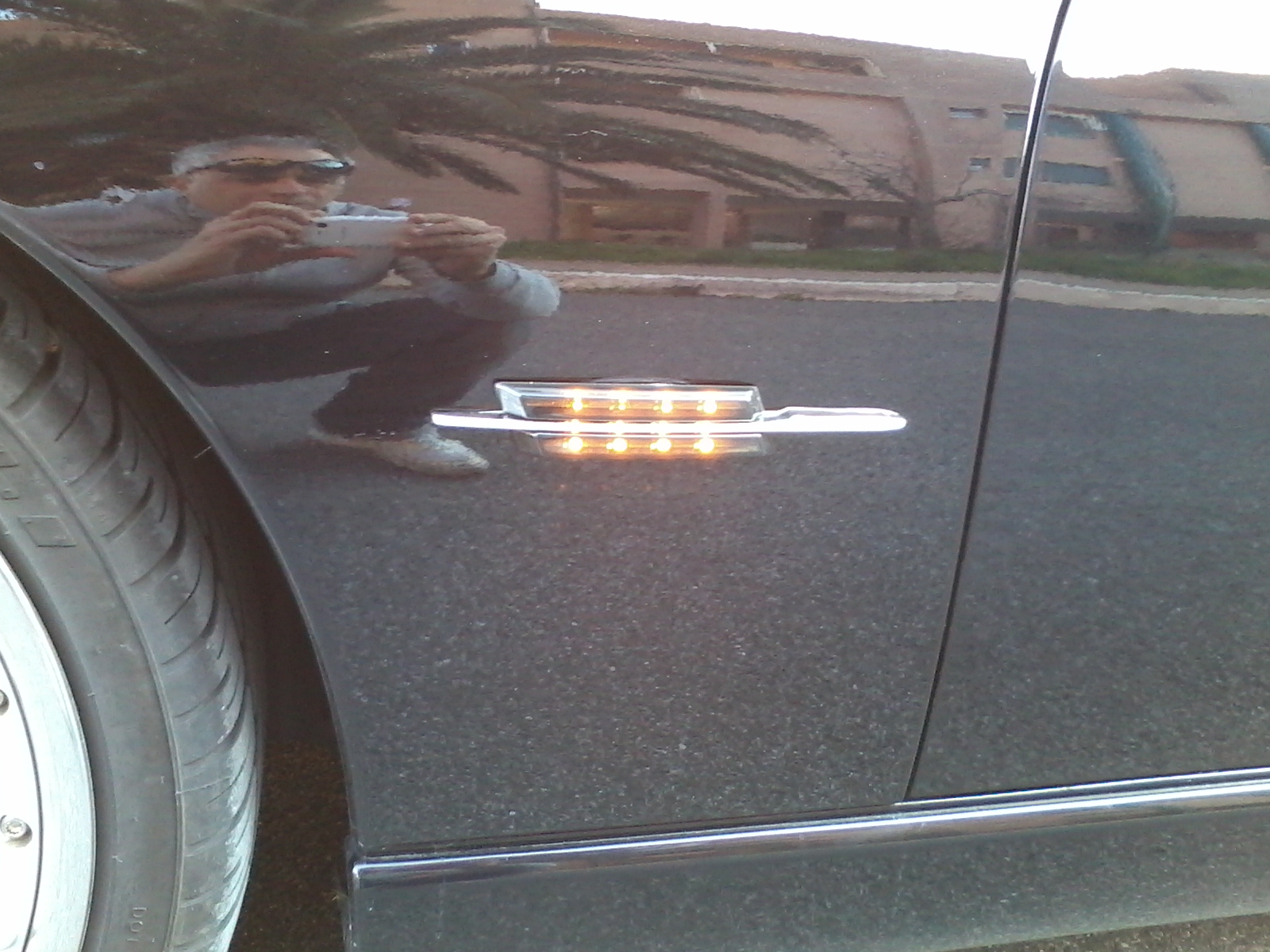

instructions:
- Apply double-sided tape on the sponge around the direction indicator
-buy a BMW connector with cables
-cut 2 sockets Jaguar and solder the wires from the connector BMW. Insulate all.
-attach the new LED turn indicator on the body of car.
attention: the buzzer inside the car arrow activated will increase the pulse frequency but externally will always be the same.
these arrows are both obscured or clear.
(you might notice a slight aura of the old indicator. just a bit of polish to make everything perfect)

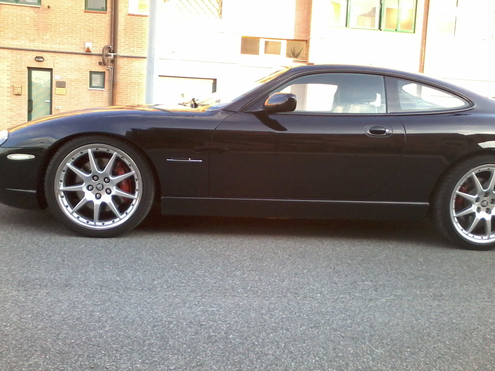

Certainly distinctive. Pretty nice mod.
I might like it better if it was less angular. Works against the curves of the car, so not for me.

Nice work, although here in the US there is an very oval jaguar symbol there.
I also think a curvier indicator would work better with the car's curves.
