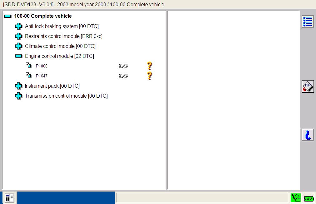

Well, maybe I got an answer for you. Just got an XK8 NA AJ27 car in and did a test. It came in with an EVAP fault P0455 only. With the car running, I disconnected the Bank 1 Upstream connector, the gray one. Read the DTC's and had both P0455 and P1646. Reconnected Bank 1 and disconnected Bank 2. Read the codes again and still had only P0455 and P1646, never would set P1647.
As I explained some time back, [see post #31] once we record an O2 sensor fault, it generally STOPS LOOKING at the O2's because it knows something is out of whack.
So I cleared the codes and re-read them. [remember, I still have Bank 2 disconnected] After the re-read, there it is.......P1647. It went exactly as I mentioned before.
So there is an answer for YOU. [Someone with an XKR, not so much!] You have some kind of a circuit fault to the Bank 1 sensor, or a failed sensor. Now you need that detective.
One thing your guy could do is swap the two upstream sensors, clear the codes and drive until something resets. If it changes to P1647, you know it's the sensor, if it doesn't, you know it's wiring or [ouch], the ECM.
Happy hunting guy!

my head hurts,
Well my p1646 turned out to be the oxygen sensor and not the pump relay after all, I thought that mine was a 2001 model year according to the registration document but it turns out it is actually a 2000 model year after talking to my friendly jag dealership in Lincoln (UK) so as a lot of others i thought it would be pump relay but mine fell into the "up to 2000 model year range" and I was reading it as FROM 2000 mod year it is in fact the early coding and the expensive repair, I have had it replaced and the codes have cleared but I still have missfire on 7 and 8, tried swopping coils and plugs but still remains, when i removed the plugs and turned her over there was a lot of fuel blown out of the cylinders (7,8) so seems like overfuelling and fouling plugs, next check fuel trims if I can get into scanner to talk to it.
to be continued!
