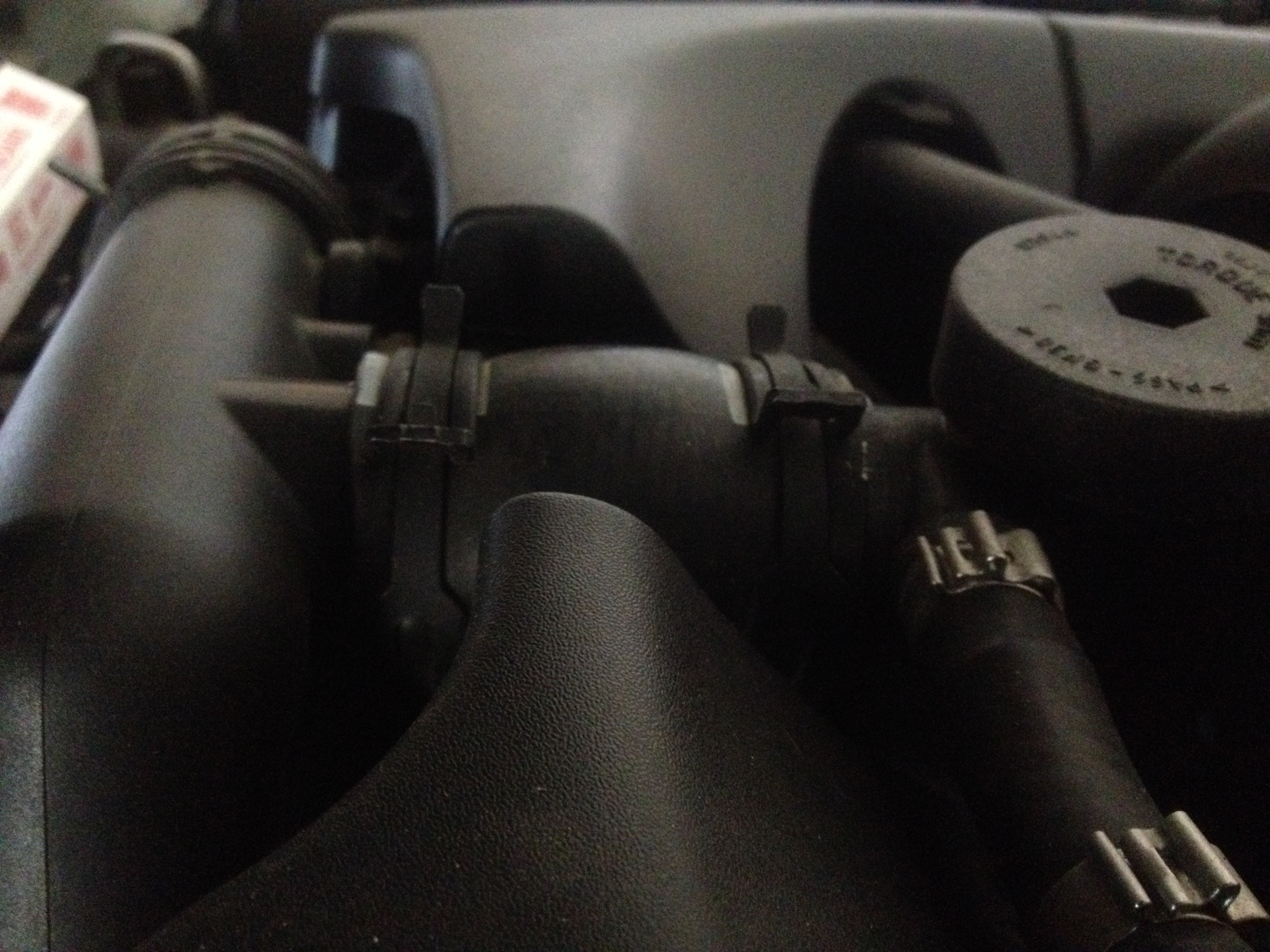

Hope this fits this thread... can anyone tell me if this little bit of hose looks like it's bulging more than it should?

It shouldn't bulge at all, so it's time to get to work. It would be best to replace the housing with an aluminum one, and also replace the radiator hoses, crossover pipe and water pump while you're at it.

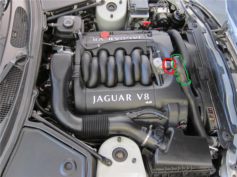

Anyone have a recommendation on where to get these two parts (outlined in red and green in attached photo)? XKs unlimited apparently doesn't carry them...

  #30
rwilcoxen's Avatar
Joined: Jun 2016
Posts: 66
From: panhandle, tx
the last time I was on ebay, they had them there. you might try sngbarrett,com

test point's Avatar
Posts: 5,390
Likes: 1,116
From: Ellijay
SNG Barrett for sure.

Is this the correct hose? NCA2213AC "bypass hose"? Found one here https://www.1aauto.com/1999-jaguar-x...c/1999-899-161
And, their outlet pipe is still made of plastic SNG Barratt - Product Details I emailed to confirm.. I thought these were available in aluminum somewhere? XKs unlimited apparently doesn't have either of these parts..

michaelh's Avatar
Posts: 4,812
Likes: 3,025
From: Jersey, Channel Islands
Seems to be the season for this job. I've ordered same parts for mine, although I went the dealer route as no shipping charge means it works out around the same.
NCA2213AC is correct for the bypass hose.
The crossover (AJ85885) isn't available in aluminium AFAIK, unfortunately.
