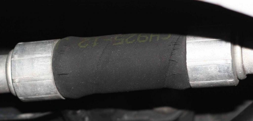

Some time ago I told you all about my oil cooler Hi-pressure hose rupturing during my post chain tensioner replacement test drive. What a mess it made. Well I finally learned how to post pictures so I thought i'd show you. The new hose has an improved ferrule to reduce the stresses on the hose. The bottom hose on the left end is where it ruptured. If your hoses are swelled at the fitting then I urge you to replace them. The other "half" of the hi pressure side (feed and return consist of 4 hoses) had been chaffed by the inner fender on the metal pipe section. (Don't have photo shop to add arrows and such) but you can see it in the pictures. This concerned me so I wound up replacing all 4 hoses...about $400 from Gaudin.

Mine had a leak, driver side, at that fitting you show in the first couple pics. Never ruptured, I replaced after noticing some oil drips hanging from the metal section.

White XKR, yeah my hi-pressure side had ruptured at the oil pan end, the hose connected to it was the one that was chaffed. My Low pres/return hoses looked like yours, i.e. cracked and swelled at the fittings so I decided it was time to replace them as well. I like Jaguar's improved design with the longer bell shaped fittings...should last much longer.
Stevepaa, to view the hoses look from underneath the car. They originate at a fitting between the oil pan and the front damper/harmonic balancer. They branch to the right and left into/behind the plastic inner fenders. The Hi-Pressure hose is on the left, return on the right. They connect to another hose that wraps around to the oil cooler which is in front of the radiator and AC condenser. There are O-rings at each end of each hose that can also develop a leak (as per H2Oboy's car did). To replace them you need to lift the car up, remove the inner fender liners and you have full access. Not hard to do.
