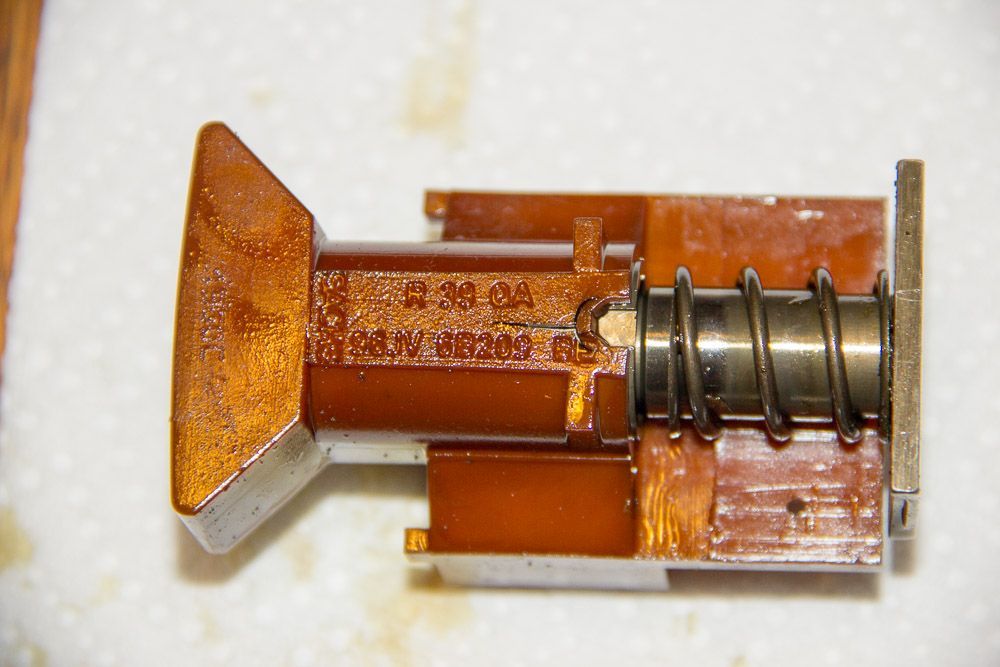

Pics of the old plastic tensioners - so close to gone!!!
Well I'm so fortunate that I engaged with you all on this forum and especially paid attention to the warnings about the 1st gen secondary tensioners in my 2001 XK8!
If you've read this thread at all you know the most recent work I had done was to have them replaced with newer 3rd gen metal tensioners, and I held off on driving the car quite a bit this fall with concern that I could drive it into a massive failure.
This week I finally got around to digging through the parts box in my trunk and dug out the original tensioners. They look worse than any I've seen on the forum so far, short of total failure!
I feel SO fortunate that these didn't fail before I had them replaced!
You forum jockeys rock! A thousand thanks to everyone who contributed to this post.

1st tensioner zoomed out - notice the crack running up from the hex shaped recess in the plastic above the spring

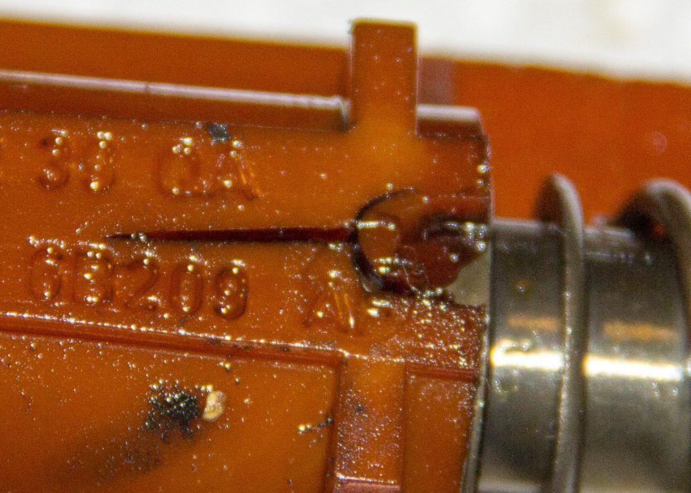

https://cimg9.ibsrv.net/gimg/www.jag...5c63739019.jpg
1st tensioner zoomed in - you can see through the crack all the way to the metal, and see additional cracks around the beveled edge if the hex recess.

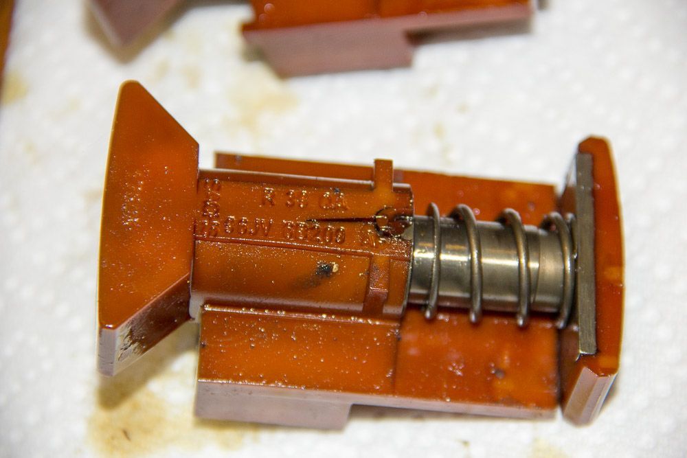

https://cimg4.ibsrv.net/gimg/www.jag...a854b89baf.jpg
2ndt tensioner zoomed out - same thing! Notice the crack running up from the hex shaped recess in the plastic above the spring

jamdmyers Feb 5, 2015 11:22 PM
You'll notice the plastic top on the first photo is missing, (or not in photo) if you don't have it and it wasn't retrieved during service you might consider pulling the oil pan and checking for debris, that's usually where they are found, good chance at some it may affect oil pressure as bits lodge themselves in the sump screen. There are a number of posts finding this here (with photos)
soultech Feb 6, 2015 09:55 AM
Thanks man, I wondered about that as well. The piece was not in the parts box. I was thinking maybe the mechanic dropped it in the trash or on the floor.
I'll look into the procedure, do I have to pull the motor or lift it to get the pan out to look into it?
RJ237 Feb 6, 2015 11:07 AM
No, just remove the x brace. Use a new gasket and torque properly as in JTIS.
