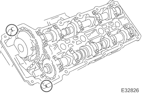

You should be fine, of course clean and inspect. Don't forget to use a dab of sealant where the jtis calls for.
Attached Thumbnails Tensioner Job - Do I need new gaskets/covers?-valvecoversealant.png
