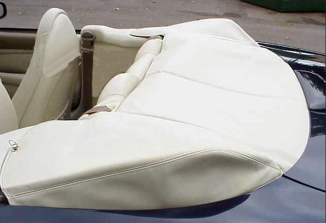

Here are the basics.
  • Lower the top
  • Open the trunk
  • Pull the cover loosely into place, with the flaps (arms) on the fenders and the 3 loops dangling into the trunk
  • Put the female snaps onto the male studs (on the fenders) and pull up on the ring while pressing down on the snaps (this works like a marine snap if you have boats)
  • Close the trunk on the loops, securing the rear of the cover
  • The extra material in front between the flaps will tuck in behind the rear seat backs
  • Tuck in all loose material

Too easy!!
Figured what was throwing me however. I found I have some 'loops' of the same heavy banding used on the tonneau that holds the pegs but these are inside the area where those fit at the trunk. I have no idea what they are for now.
Also, the peg for the snap/catch attachment at the front of the tonneau was reversed with the screw in the cover. Reversed those and it all fits....and works.
Thanks!
