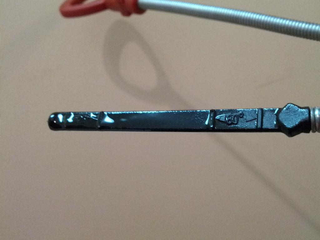

- I have the correct MB transmission dipstick, and have checked the level, which appears to be OK (see image below). However I have gotten a spot on the driveway while the car was sitting, though I suspect it's coolant (as that also signaled a low and I had to top off about half the reservoir).

Current fluid level after going from cold to a short drive:
(P.S. Is the MB ATF fluid supposed to be yellow-ish instead of red...?)

Don't have an answer here for you, but for just to be sure, have you checked the oil temperature when you measured it and was the dipstick measurement with the engine running?
Yellowish isn’t an issue, better then black and smelly, however if your oil has never been changed, after 10 years of service it might be a good time to change it as well. Or you could have it checked with http://www.blackstone-labs.com/, but I would change it regardless.
