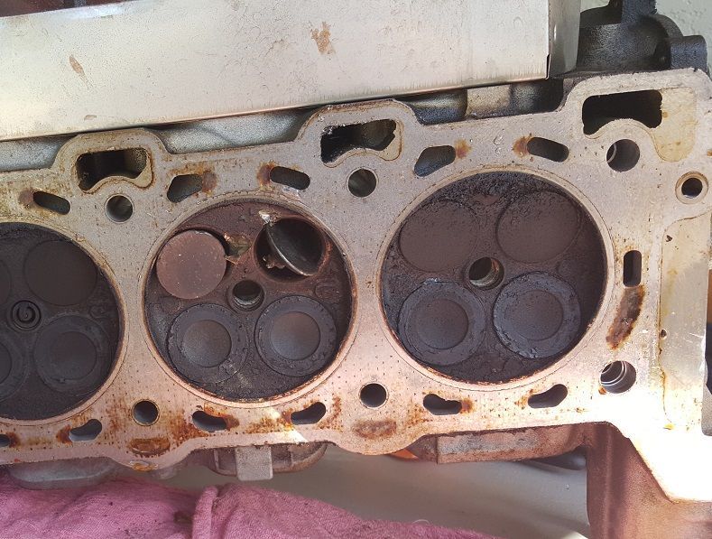

So, I picked up a parts car with a "blown" engine for next to nothing. I started stripping the engine and sure enough found the secondary tensioner on right side was bad and secondary timing chain broken. I decided to keep going and took the cylinder head off. What happens when the secondary tensioner fails? The picture below shows the damage done...bent exhaust valves that gouged into the cylinder head itself...ouch.

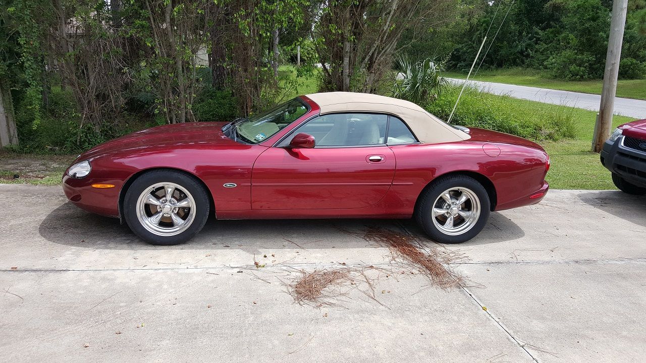

This story has a happy ending...I decided to attempt to save the cat rather than strip her for parts. I found a used head at a local salvage yard and put it all back together with new timing chain and tensioner. The result...another 1997 Jaguar XK8 back on the road, not sitting in a junk yard.

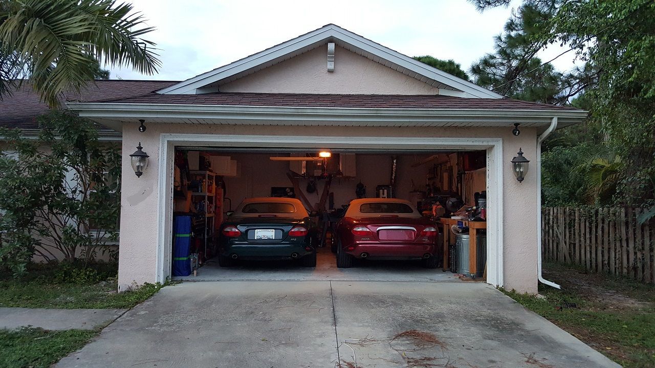

And then there were 2...

If that doesn't scare all 4.0 owners enough to replace their plastic tensioners immediately, I don't know what will....

What condition were the primary tensioners and guides in?
Borg524 Dec 3, 2015 05:07 AM
The guides and primary tensioners were in surprisingly good condition with no cracks (engine has 81,000 miles on it).
