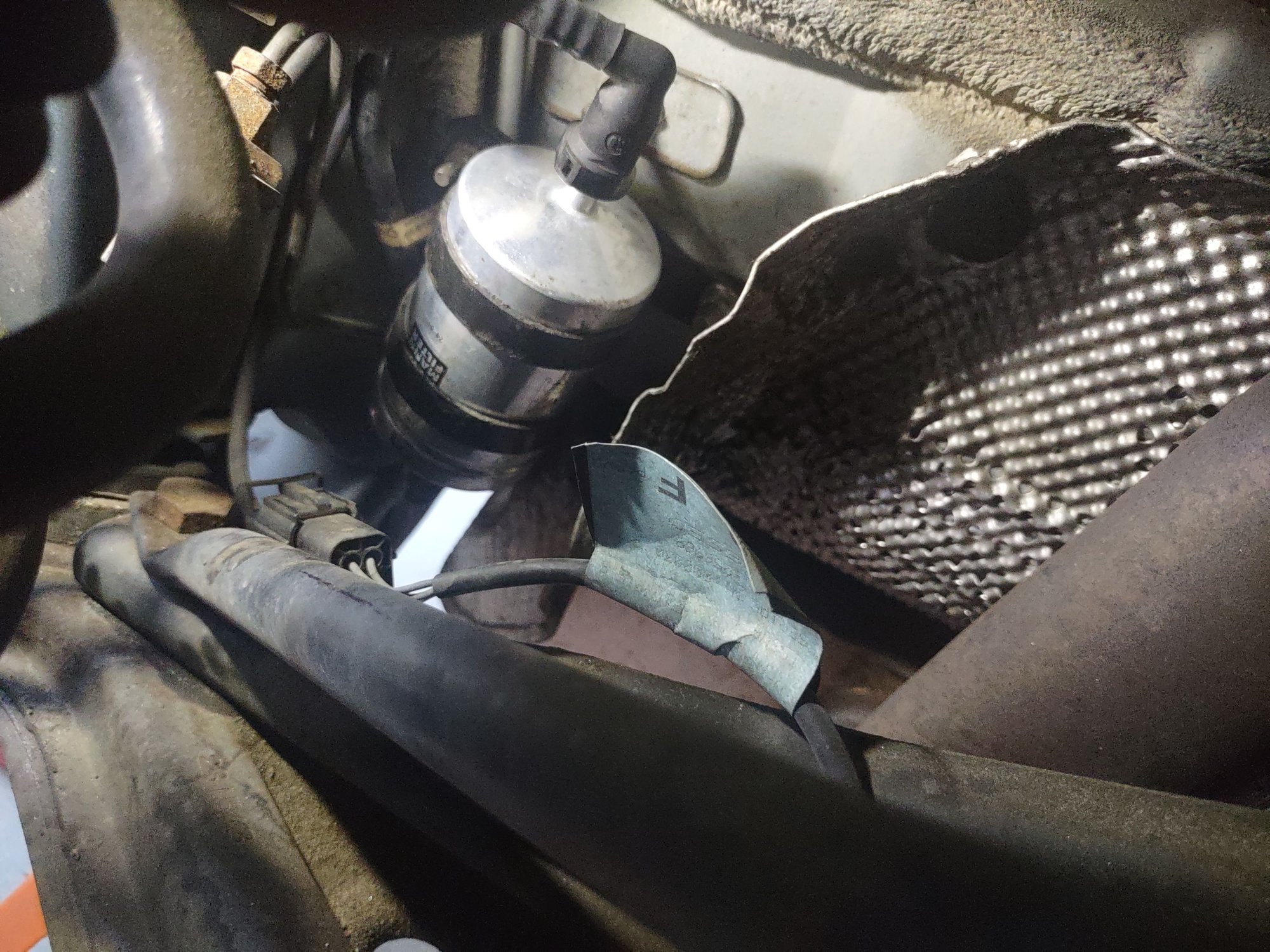

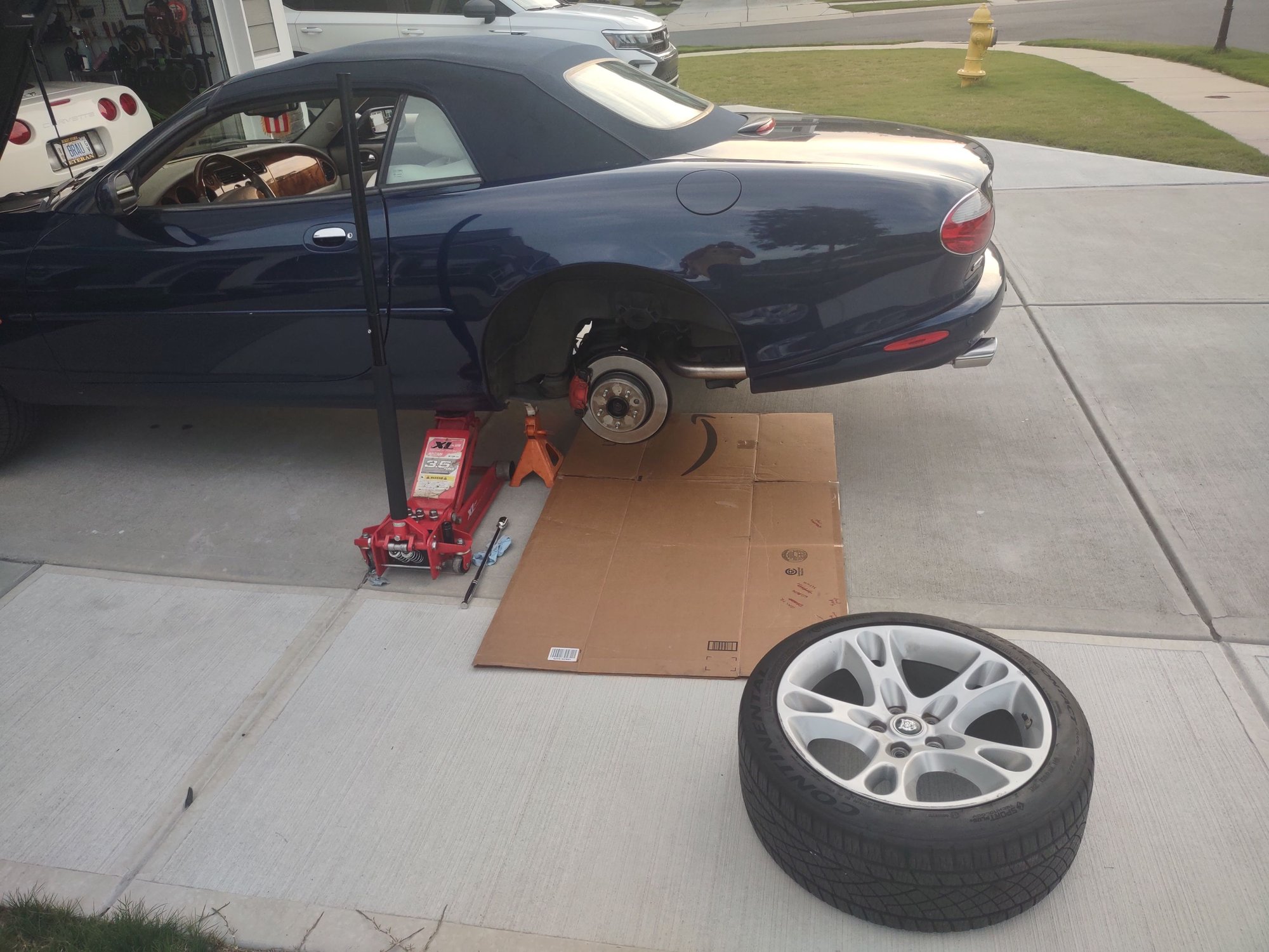

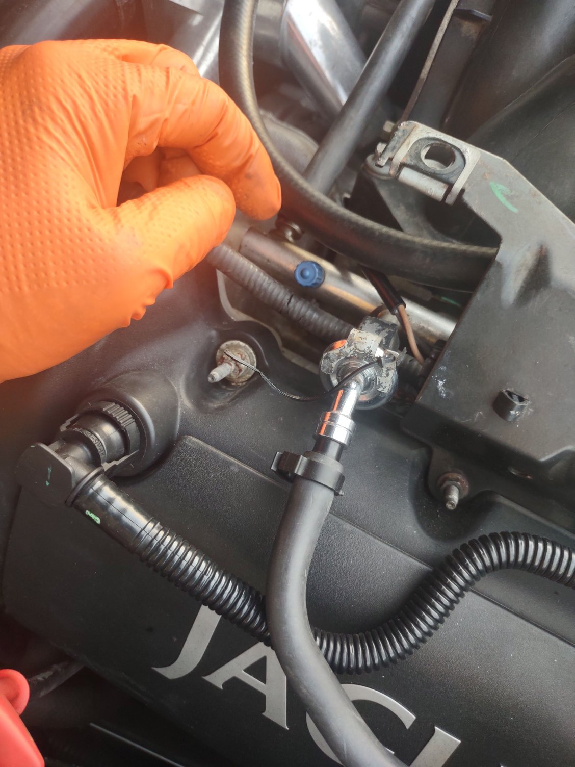

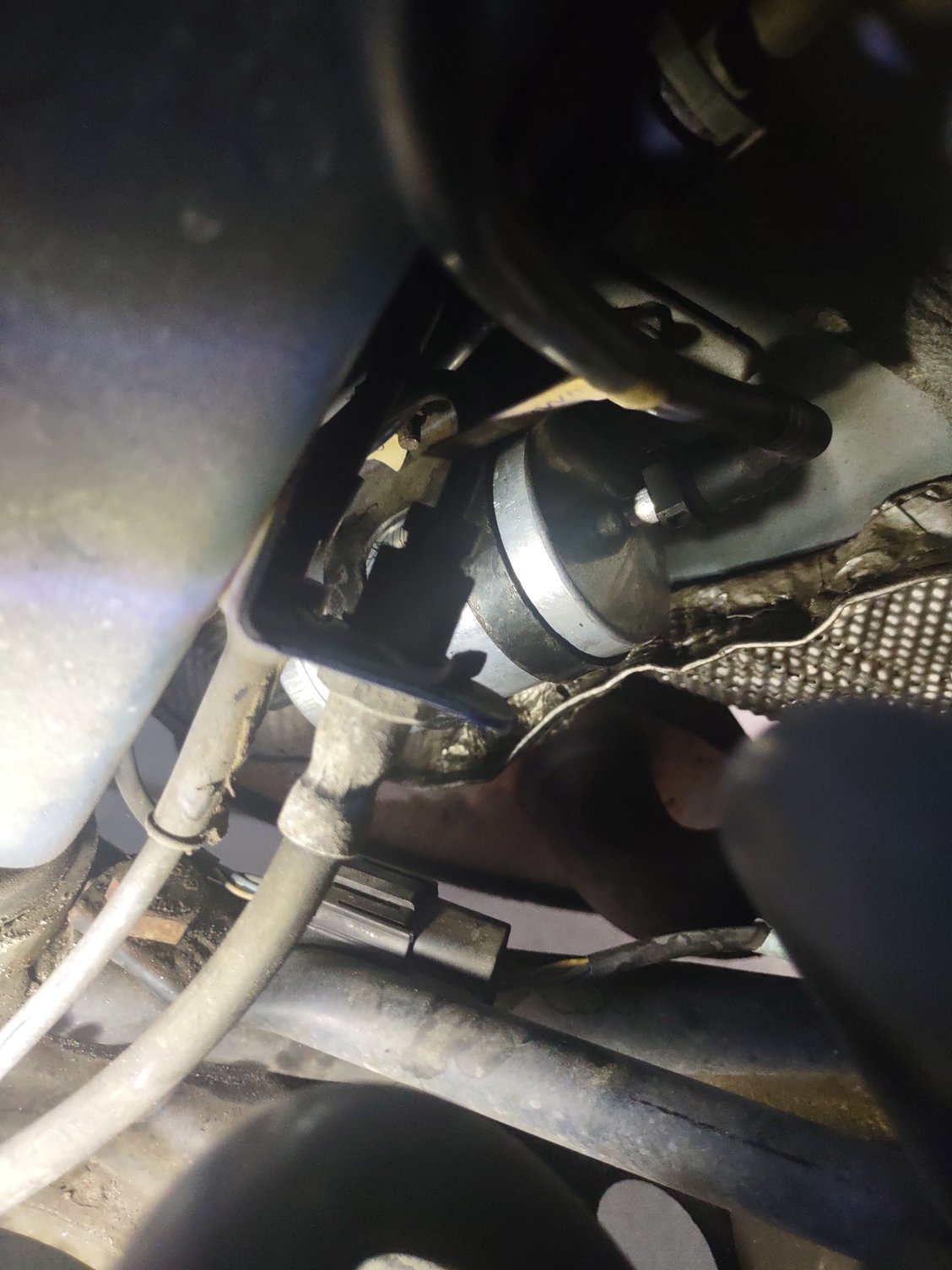

Did a quick fuel filter change, it took me longer to figure out the disconnects than the rest of it
Jack & stand
Jack, Jack stand, front wheel blocked
Is back there
Is back there
Release fuel pressure

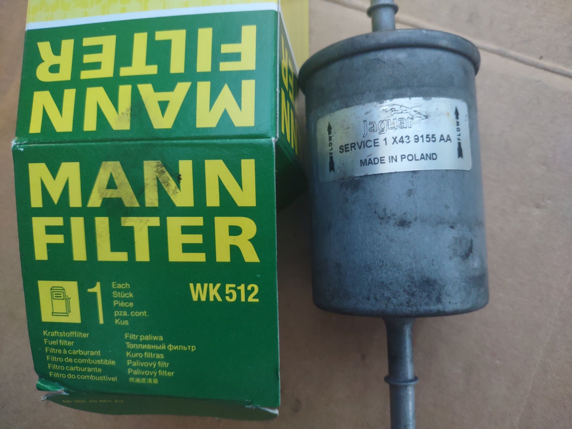

New filter
New filter
New filter
New filter box and stock filter. Date last changed unknow

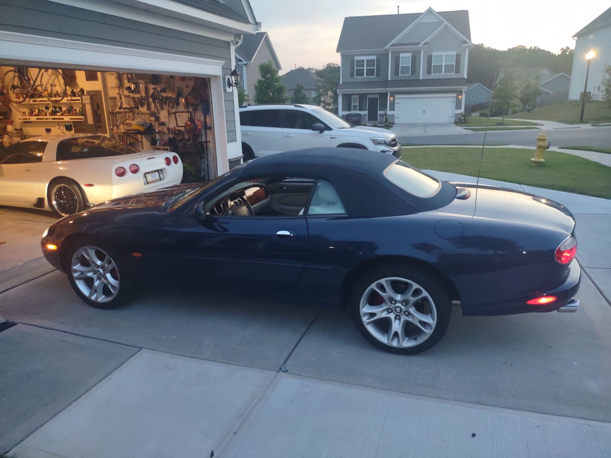

Ready for a cruise, that was pretty quick. 15 minutes or less

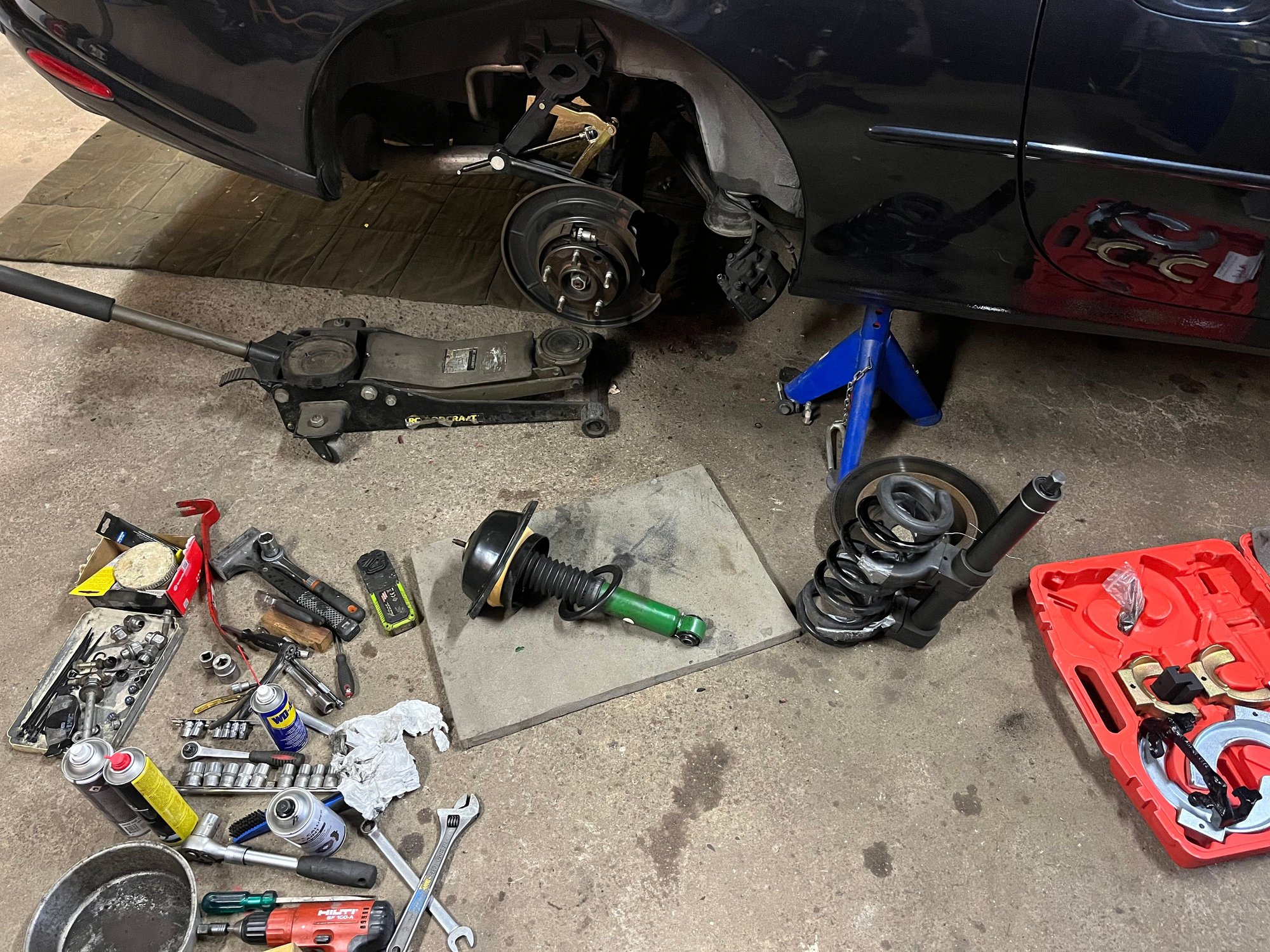

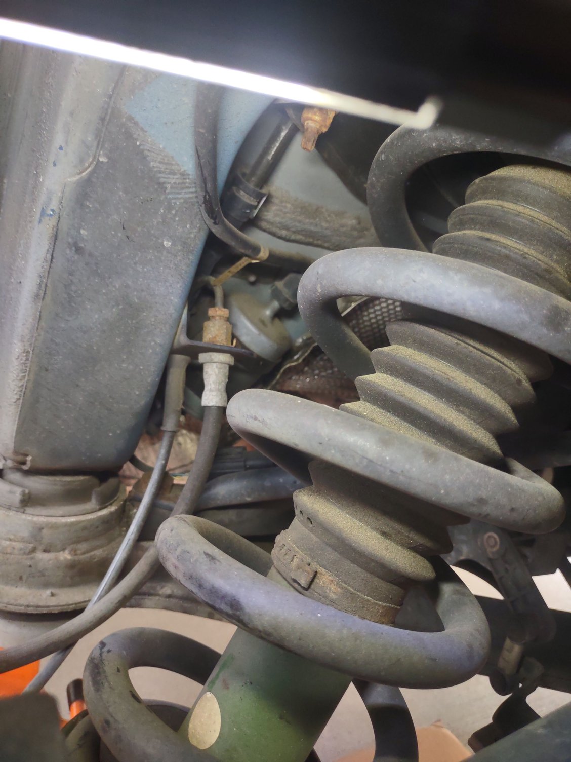

Default Rear suspension, the usual suspects..
Did both sides this weekend, but boy what a struggle without a proper lift.. but i won in the end.. i also had to mend that little link to the chassi movement potentiometer.. its plastic bearingcaps just fell off when i toutched it.. managed to McGywer togeather a ”new” with a part from my Citroen XM parts collection.
A splash of black caliper paint and it was as good as new.. 🙂

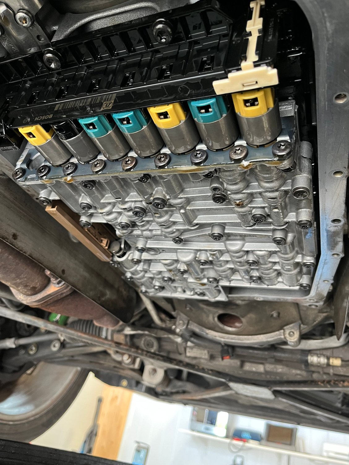

Default Gearbox oilchange
Since i did not have any solid information from seller regarding the status on gearbox oilfilter/oil i choosed to played it safe. According to the seller, they had some issues with the gearbox so they decided to flush it.. They had to push 5US gallons through it before the oil came through clear.. ”did you replace the filter too?… Ehh.. No.”
Luckily i have a friend with a workshop i could borrow a proper lift from.
With the pan removed everythin actually looked really nice.. and no ”mud” in the pan.
Nice and clean.
Nice and clean.

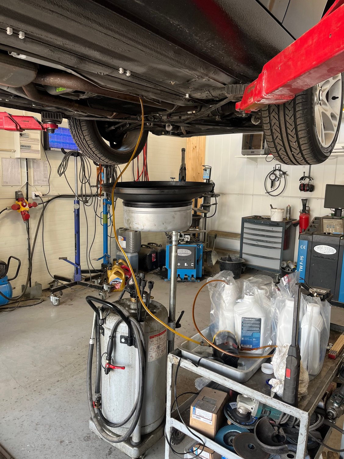

A neat setup, using a small car battert and a cheap electric ”oilchanger pump” sucking from bottle and filling gearbox without making a total mess.. It took 3liters to get to full again.
A neat setup, using a small car battery and a cheap electric ”oilchanger pump” sucking from bottle and filling gearbox without making a total mess.. It took 3liters to get to top it off again.
