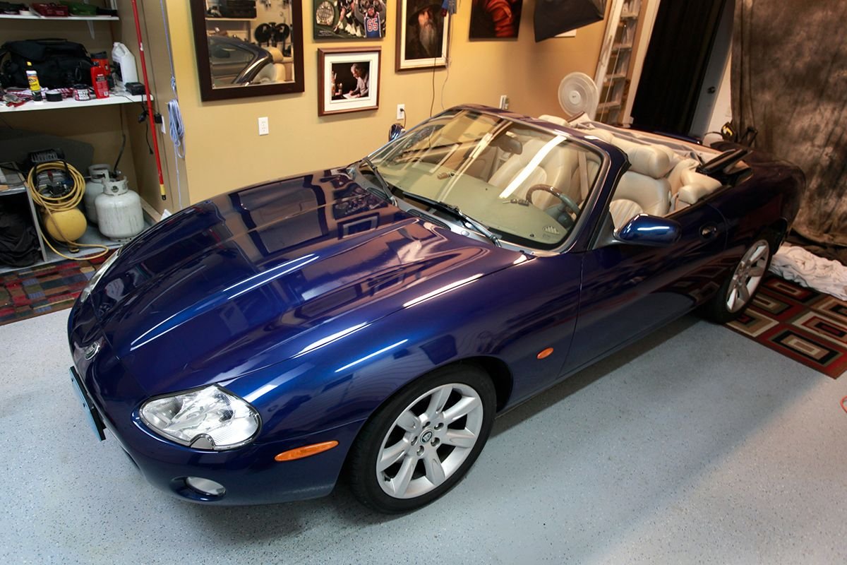

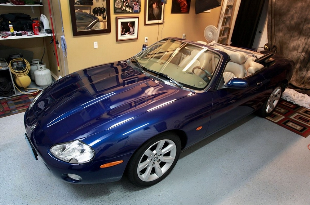

Never mind the choice of car .........
Attachment 104560
......... I'll settle for the designer garage.
Attachment 104560
If I could pay only $11,000 for an 03 convertible i could afford a designer garage! Green with envy as an 03 car would cost US$40k here in Australia.
