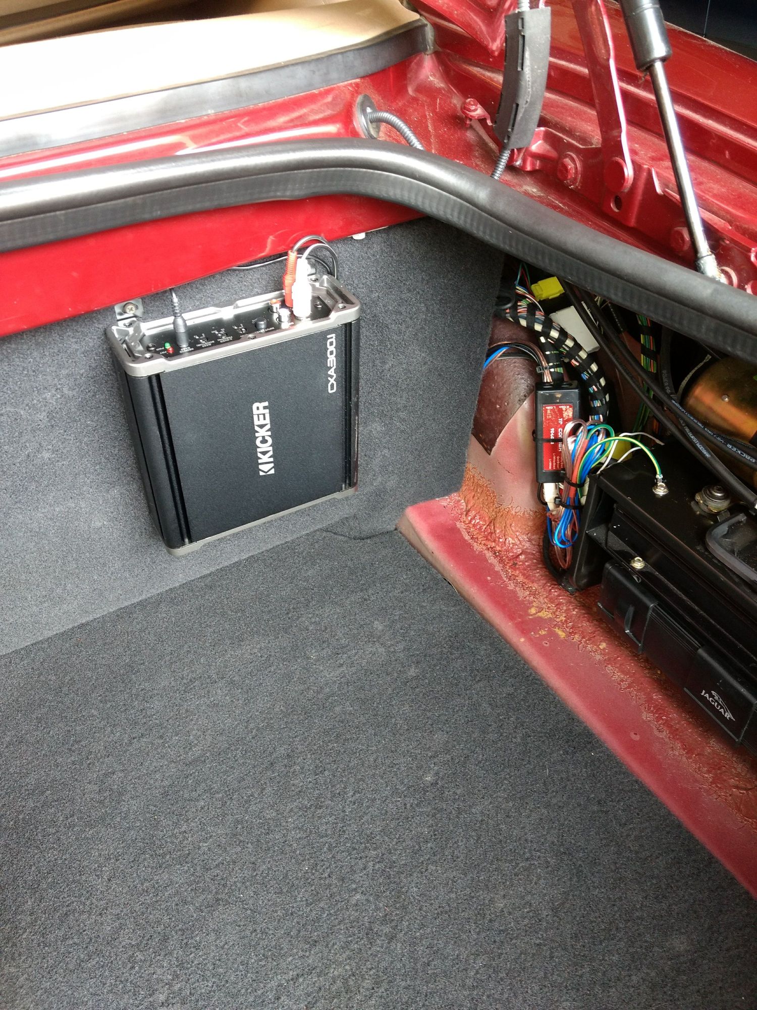

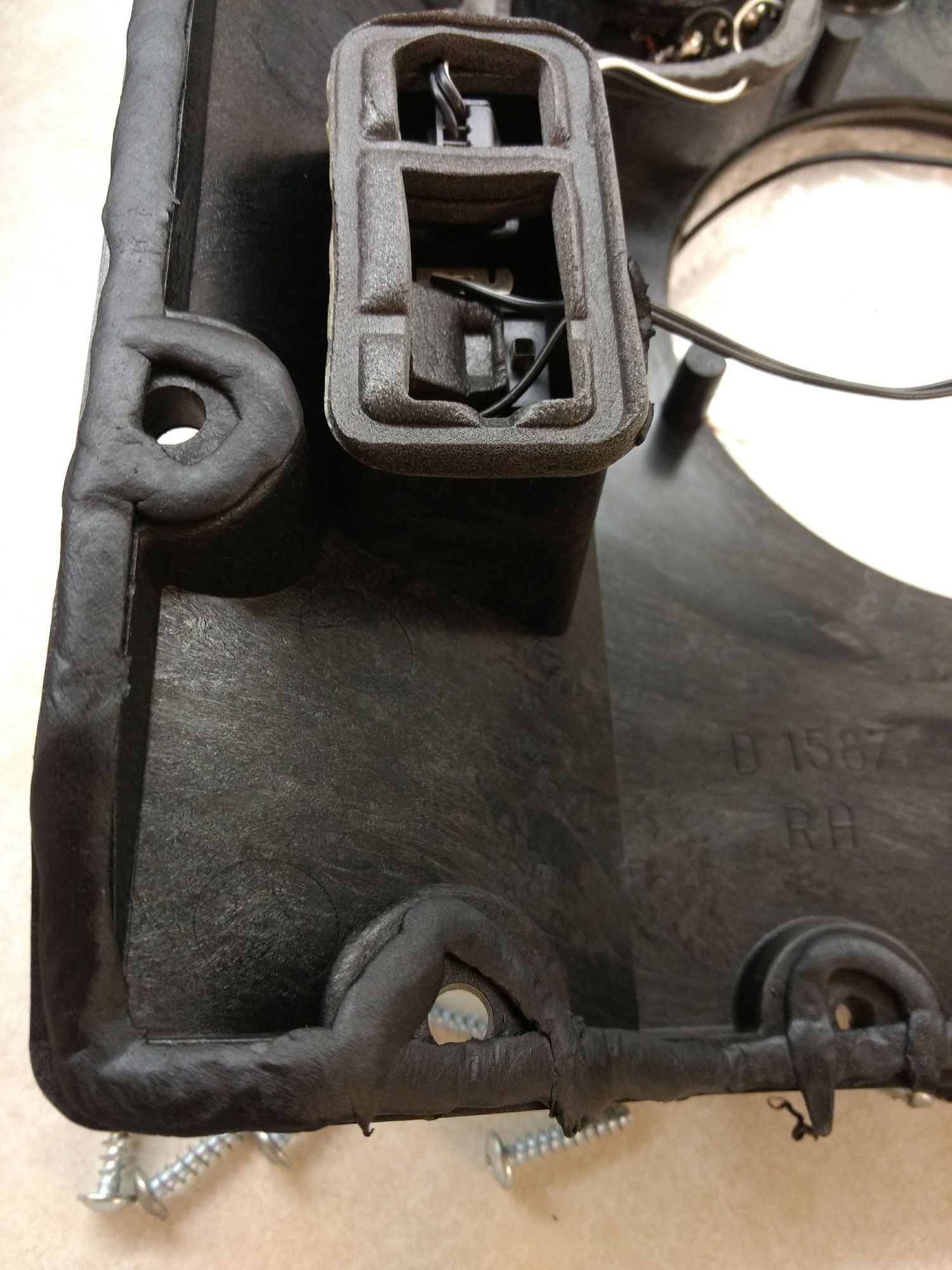

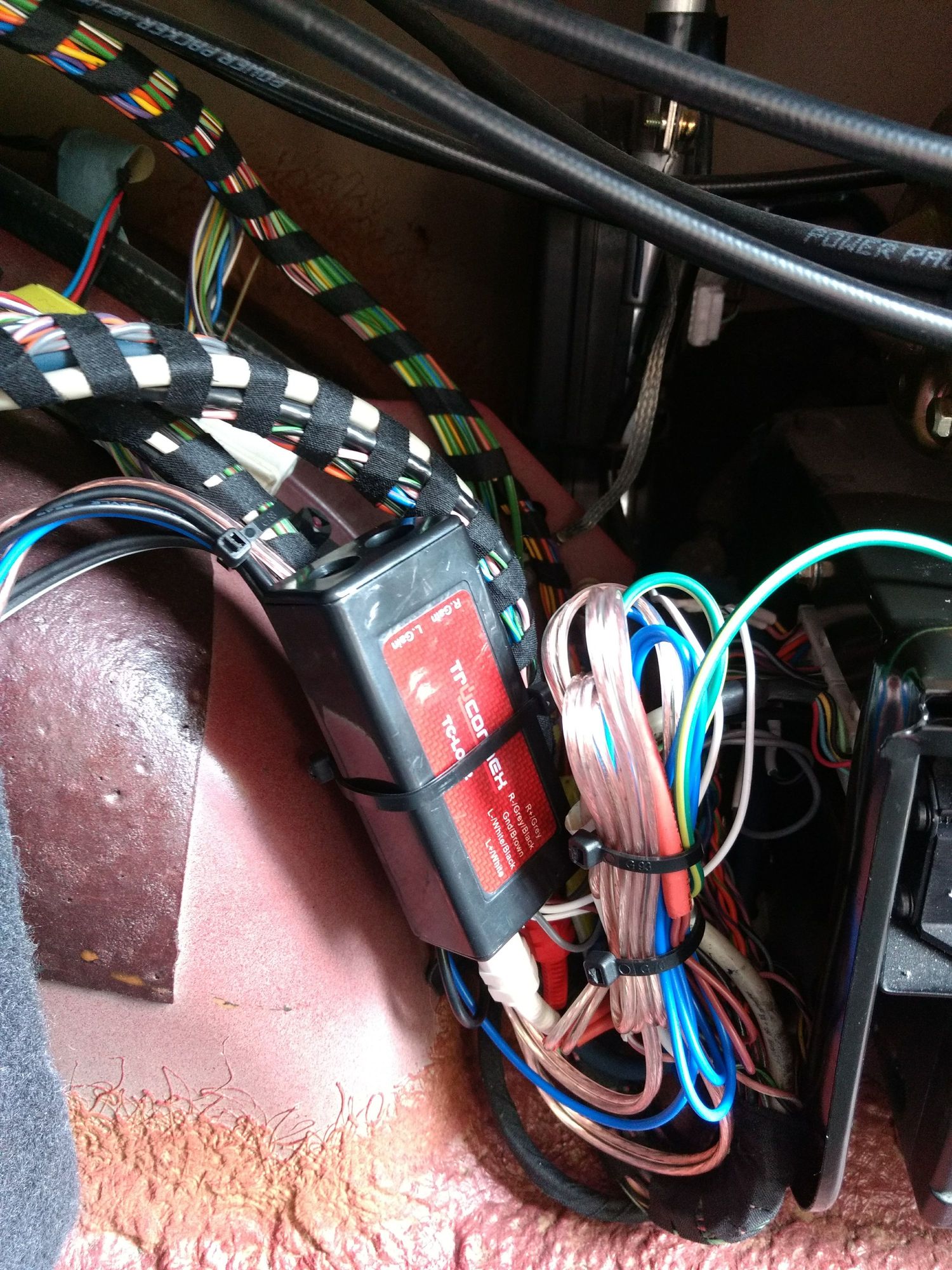

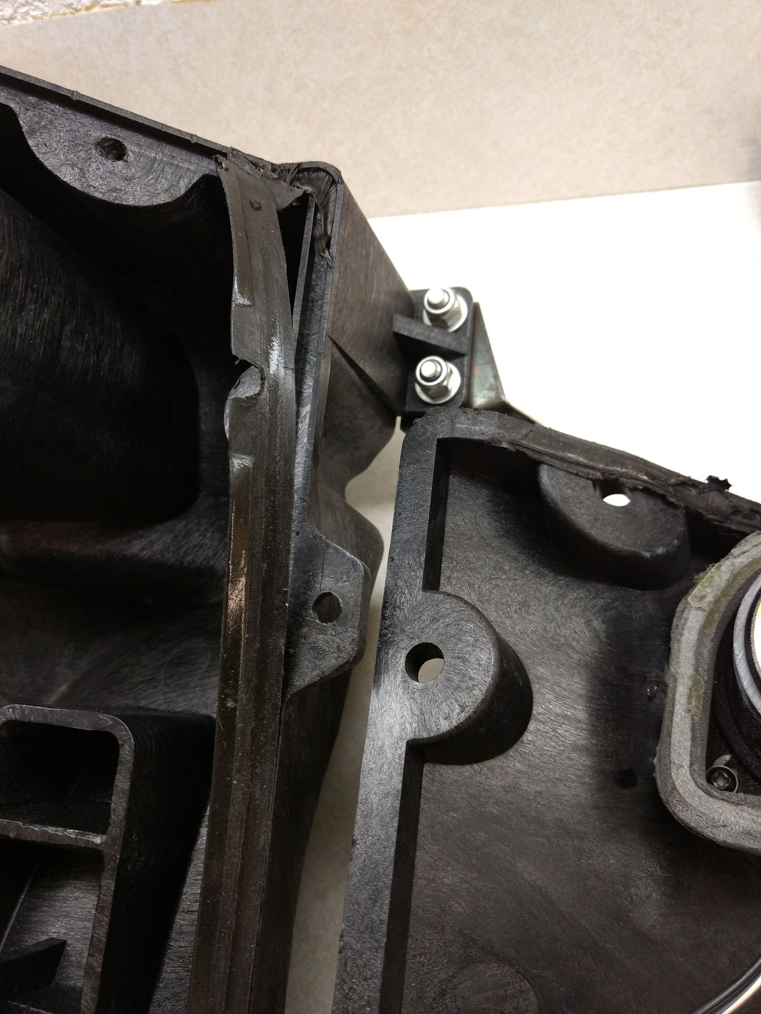

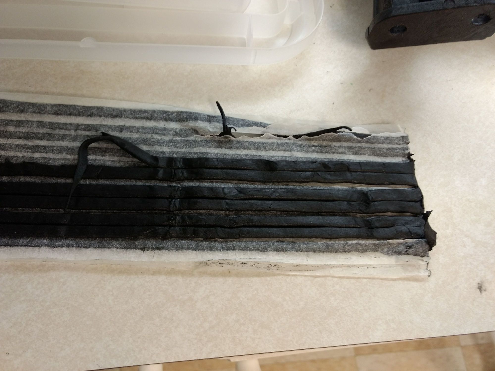

Subwoofer story
After living with the updated system for a week, I decided that the bass coming from the replacement subs wasn't sufficient for my taste, particularly with the top down, so I decided to look into getting more bass out of the subs that I purchased, Kicker CompRT 43CWRT672. In reviewing the specifications for these, mounted in sealed subwoofer enclosures, I saw that the recommended operating power is in the range of 150 watts RMS each (300 for the pair). With the factory amp reportedly rated at 240 watts total for 8 speakers, it was pretty clear that the subs weren't being sufficiently powered. At the recommendation of Kicker technical support, I purchased a Kicker 43CXA3001 300 watt amp to put on the subwoofer channel. I had contemplated a 2-channel amp since the original subs were on separate left and right channels, but Kicker support recommended against that, stating that I'd get better performance out of a single amp channel and that left/right balance on the sub channel isn't really necessary (which made some sense because the coupe XK8 only has one center mounted sub).
Wiring for the amp wasn't very complicated, but working in the trunk with the original wiring was a bit challenging since there isn't much play in the original connector wiring. The rear sub speakers are factory wired directly to the amp on separate wire pairs, and these were easily identified at the connector using the wiring diagram above. I don't know the original wire gauge that was used, but it appeared to be in the 18 gauge range. Regardless, with 300 watts available to two small subs, power loss in the speaker wire really wasn't a concern. The speaker would still be more than sufficiently powered, and there didn't seem to be any real advantage to running new speaker wires vs using the factory wiring. To connect the amp, I removed the harness clip going into the amp (the larger one), clipped the sub channel wires, connected the wires from the factory amp connector (amp out) to the new amp inputs using RCA connectors (soldered on and being careful to match the factory + wire to the amp + input to maintain polarity), and connected the wires going into the harness to the new amp speaker connectors (again, being careful to maintain + polarity). The new amp was supposed to be able to handle high-power (speaker level) inputs using a switch on the amp, but when I initially tried this arrangement, I noticed some "clipping" distortion with the subs. A tech at Kicker tech support suggested using a "line output adapter" to drop the power going into the amp, and I purchased a Metra unit that was available locally. Kicker also makes these, and they start at around $15 and go over $100. I opted for the $15 version, which is supposed to handle about 50 watts, and I'm guessing that the factory amp input won't exceed that. If it does, I guess it will eventually burn out the adapter, and I'll have to get a better one. Putting the line output adapter in simply involved inserting it between the factory amp output connector and the new amp input. I also had to add a power sensing line to turn on the new amp at this point because, while it was able to automatically turn on when the speaker-level inputs were used based on signal sensing, that feature doesn't work with the low-level input source. To get the amp to power on with the radio, I attached the power sensing terminal on the new amp to the power antenna wire, which was easily accessible on the same connector I was working with behind the factory amp (on my car Light Green & Black per the factory wiring diagram).
When all of this was done, I had expected great results...I was wrong. The subs had terrible distortion, and I tried a variety of amp settings with no luck in getting rid of it. Kicker tech support tried to help, but couldn't identify the problem. To narrow it down, I plugged my cell phone into the amp and played that as a source to eliminate the question of whether the distortion was sourced with the car system or the speakers themselves. Same distortion, so I knew it was a speaker issue. Eventually, with the assistance of a local technician at a stereo install shop who helped me bench test the speakers/enclosures with an amplified source completely separate from the car, the problem was identified. When I re-attached the face to the sub enclosure after replacing the mid-range speakers, I had used the original, but slightly damaged, gasket. With 10 screws, you'd think that it would have sealed OK, but that wasn't the case. The gasket was leaking in a couple spots, and by pushing on the speaker, you could hear the air whistling through the joint, apparently vibrating the gasket and causing what sounded like distortion.
I ended up disassembling both enclosures again, using a tack caulking material (I didn't want to use anything permanent because it's possible that the mids might have to be replace again one day), and tried to make sure that that all joints would be airtight. I also glued the wire connectors onto the enclosure to ensure that they wouldn't vibrate with the increased bass. Although there was still some minor leakage when I got done, it wasn't enough to cause any dissatisfaction with the result. The amount of bass that the new arrangement puts out is very satisfying...INCREDIBLY better than what I started with putting these subs on the factory amp. And, the factory amp/speakers for the rest of the system work fine.
It was also recommended that I use the remote level control, which is an optional plug-in for the new amp and allows you to vary the level of bass depending on what you're listening to, convertible top up/down, etc. I took that advice, which required running a single wire from the trunk to the dash, and it was well worth the effort. Varying the level of bass is a very nice option to have. To run the wire, I had to drill a hole behind the passenger side sub enclosure next to the original wiring harness penetration between the back seat and the trunk because I couldn't successfully get a wire through the original penetration to the side of the gas tank and into the trunk.
Here are some photos of the enclosure, the tack caulk that I used, and the final installation. Next project will be adding the bluetooth adapter, but I'm going to enjoy driving the car for a bit now that it's put back together before I tear into the console removal project.
https://cimg0.ibsrv.net/gimg/www.jag...b905b034de.jpgline output adapter behind factory amp
https://cimg1.ibsrv.net/gimg/www.jag...b193b1de0e.jpgamp installation (I used a plastic backer to screw into behind the panel for stability)
https://cimg2.ibsrv.net/gimg/www.jag...3caa34f501.jpgrope tack caulk applied to the joint between the face and the back of the box (smoothed and pressed down using wax paper)
https://cimg4.ibsrv.net/gimg/www.jag...3509e8025a.jpgrope tack caulk
https://cimg7.ibsrv.net/gimg/www.jag...fed8759ea4.jpgoriginal gasket material (allowed air leakage around screw holes, and not reusable if damaged at all during opening of enclosure)
https://cimg8.ibsrv.net/gimg/www.jag...a0cdbda90e.jpgA good place to start separating the face from the box (be careful not to pry hard and risk damaging the plastic...patience)
