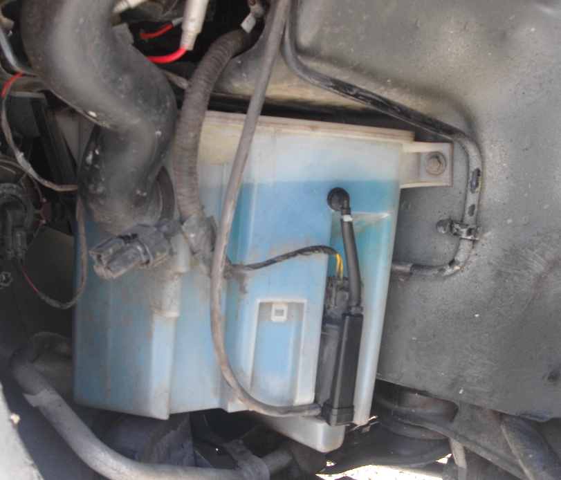

About the only non-functioning item is the windshield washer. I prefer to not go to the expense of renewing the existing unit, that involves removing the inner fender shield. I wonder if any one has figured where a "universal" pump/ and/or container can be installed in a tidy manner.

is the pump dead? Can you hear it running? I thought mine was dead but turned out that the plastic T or Y (forget what it is) under the cowl that takes fluids to the left/right wipers was broke and the cleaning fluid was just squirting into the cowl. Maybe your issue???
On my 03 the hoses goes through the master cyc area under the cover of that area.

The inner wing liner is extremely quick and easy to remove and will take a fraction of the time required to completely redesign the washer system. The "bottle" is unlikely to be broken, but might need a good clean out. The pump is available as a separate item, and would not be that much more expensive than all the stuff required to bypass the existing system. Your call, but seems a very complicated solution to what may well be a simple problem ! Do you have headlamp washers - if so - that's an additional complication unless you installed a second "new" pump for that as well.
