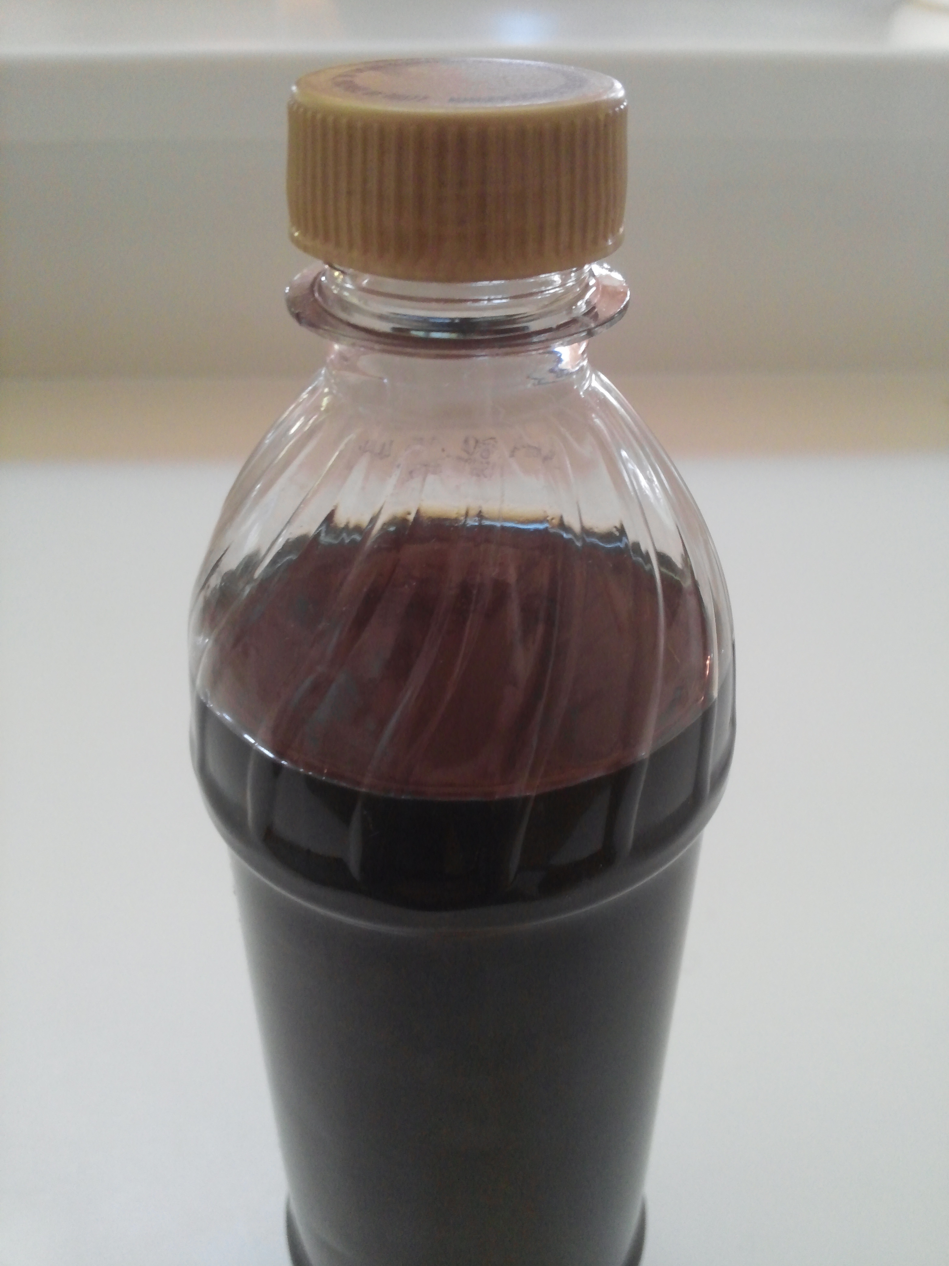

With all that information in hand and uncertainty about the filter or filter/pan from the local auto parts stores I made the decision to just have the local Ford store drain and fill with the Mercon SP. The fact that the dealer transmission specialist had not changed the fluid in a Ford version of the ZF is a significant piece of information in itself.
Assuming that I have not royally screwed up the fluid, labor and tax only came to $108 to replace the 6 quarts that drained out. What came out was serious black.
The transmission shifts as perfectly as it did before the change. The plan is to put a couple thousand miles on the 60% change and drain and refill again.
