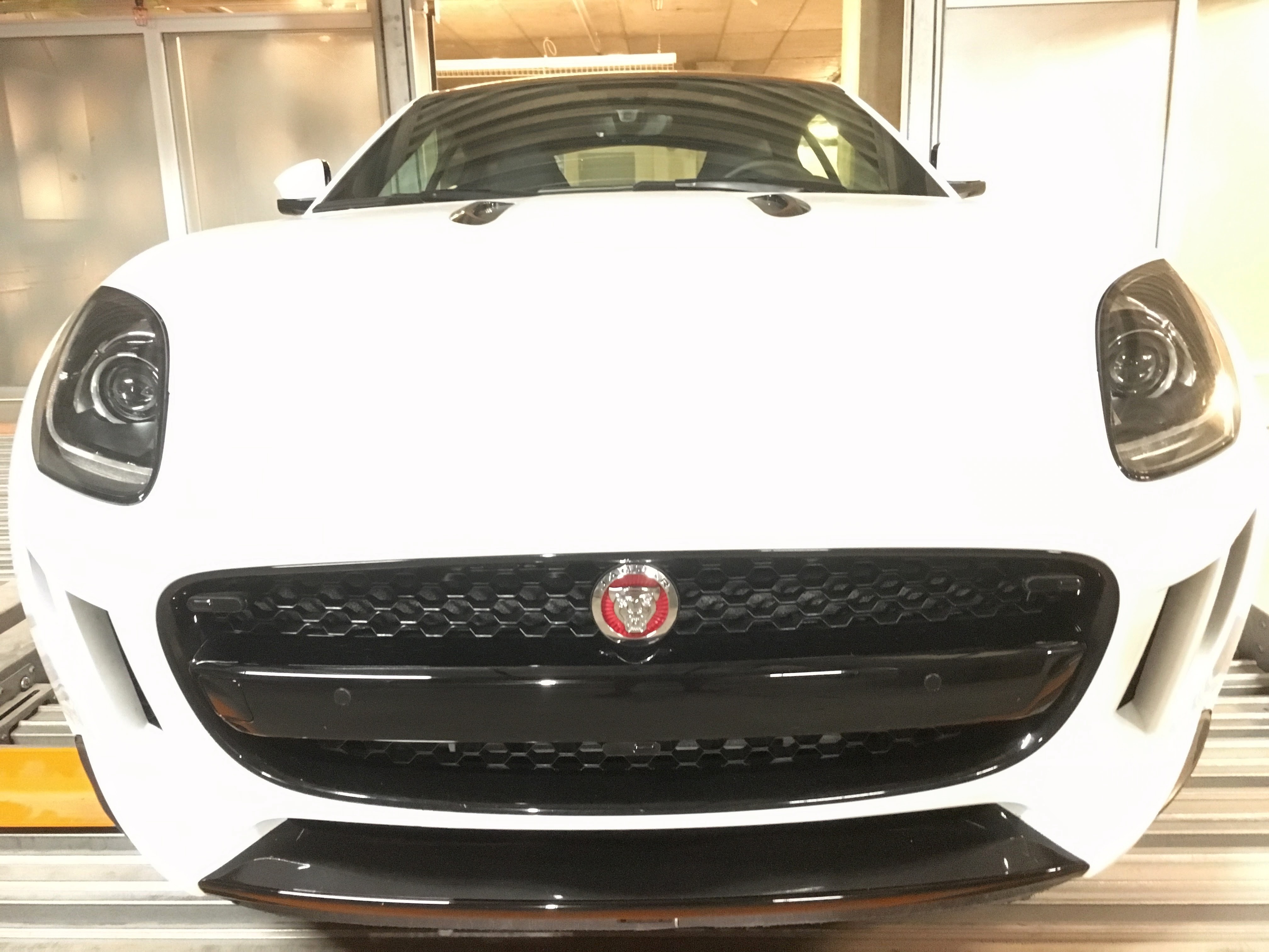

Quote: Shop installed the ALP jammers and radar detector today. I haven't seen it in person yet, but I'm really happy with the way it looks from the pictures. As expected they hid the ALP emitters under the black bar on the front and under the hatch in the rear.
The in-car display wouldn't work in the rear-view mirror because of the way our mirrors are made, so instead they moved to the backup plan of using the display that's normally used for the passenger seatbelt indicator. From the pics I think it looks great. Really impressed with how it's turning out. Pics below.
Stealing the passenger seatbelt status indicator for the radar detector and ALP displays.
Startup screen for the ALP and STi-R.
Side view. No sign of any changes other than my new tint. Check out the McLaren 675LT sitting beside me. The cars that come into this place are just sick!
ALP emitters hidden under the black bar in the grill.
Close up of the ALP emitter mounting.
ALP emitter mounting in the rear.
I'll never see these parts again.

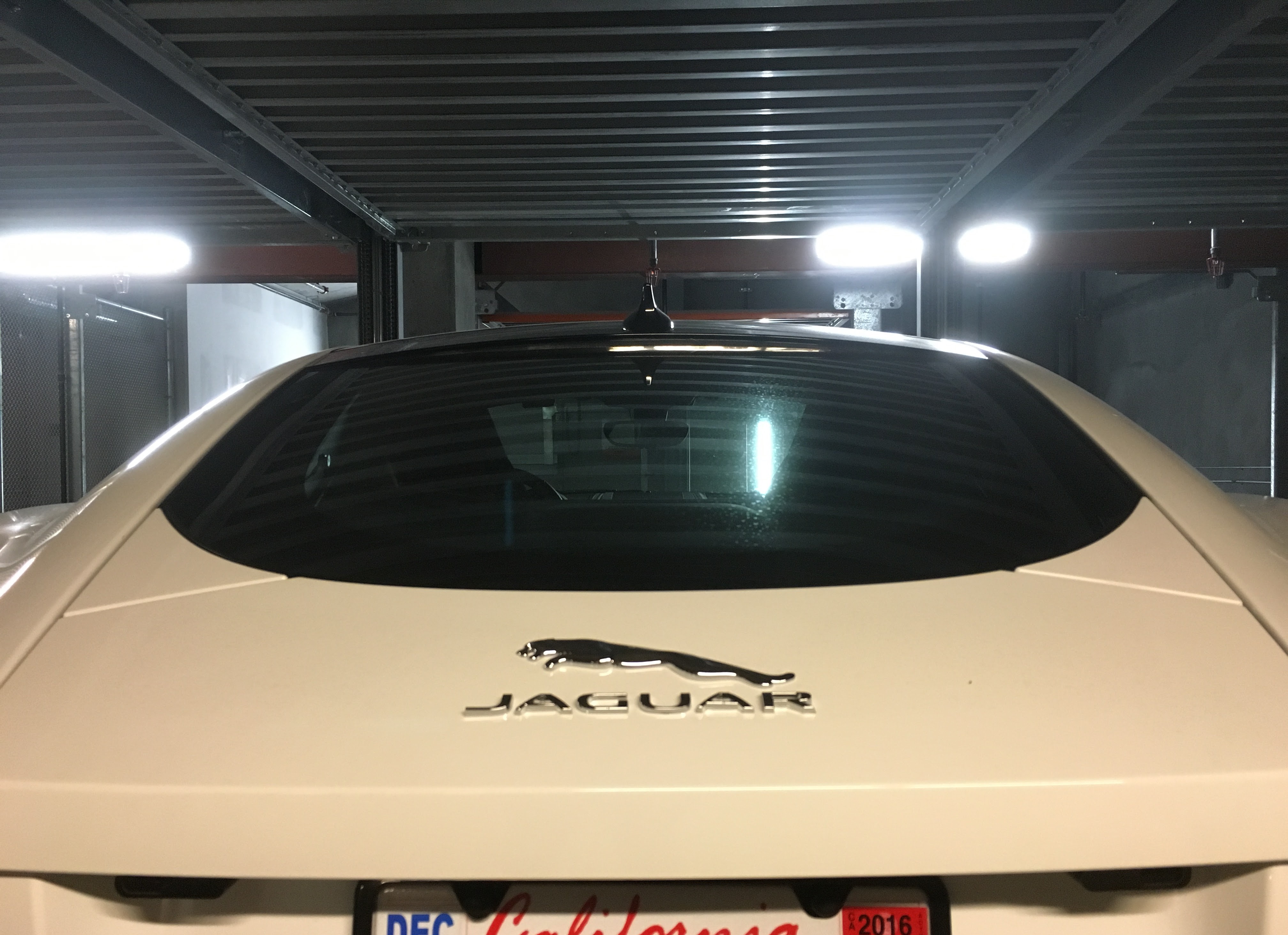

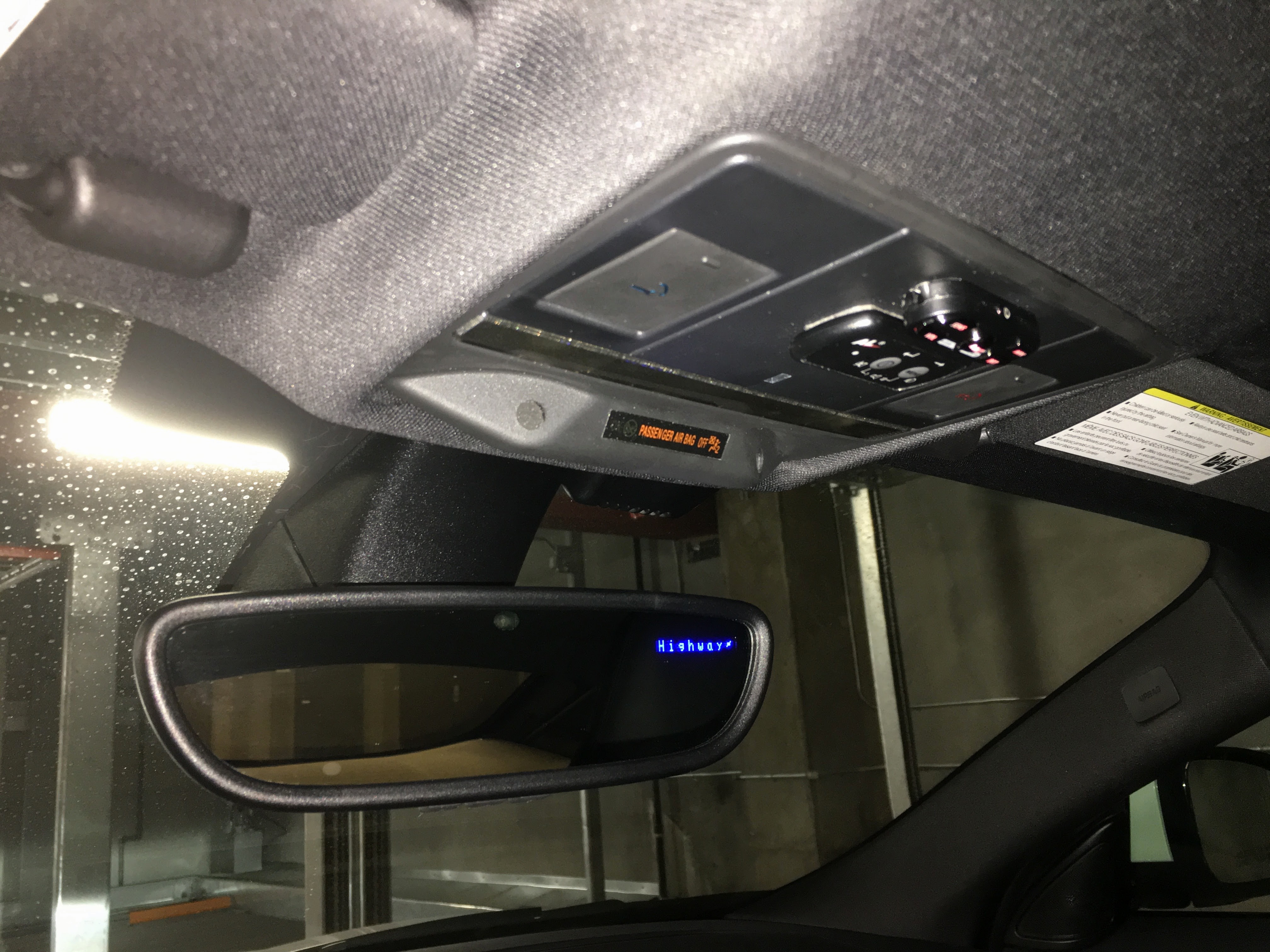

Got my car back from the shop this week. I went with a Stir+ALP quint (3 heads up front and 2 in the back).
Not sure why one of the posters here couldnt get the Stir+ display in the rear view mirror but my installer was able to do it. He said it was a little tight but he was able to find a way to put it in there. Looks great, very stealthy and better that the option of removing the passenger airbag option that was used earlier. I usually run this in single letter mode so only see H on the display and not Highway (as displayed) so its barely noticeable unless it needs to be.
I also like where they put the LED's for the ALP and Stir+. Again makes it looks fairly standard and not crazy aftermarket. The LEDs only blink when there is a thread detected.
The control panels location was the most interesting. I wanted something to not look out of place and the ALP panel is pretty bad looking and I didnt want to display it prominently. The solution they came up with is awesome, the panel up near the lights can be easily replaced and its where they attached it. The ALP went behind the Stir+ panel. At normal sitting height, you can't even see it (which is perfect since you never really need to use that panel really). The Stir+ panel is right at eye level and again doesnt look crazy out of place.
The angle of the photo is exaggerated low, but at normal height it looks perfectly fine.
Overall nice job, dare I say it better to my eye than the job posted earlier in the thread. Now hopefully no more speeding tickets for me in this car!
Apologies for the dirty car, its been raining pretty heavily here in the Bay Area. While the car was with the installer, I also got Huper Optik Ceramic 70% window tints done which look amazing and at 70% you can hardly tell its tinted buy as some of you guys know the heat and UV rejection of ceramic is the best in the biz.
Hopefully this post helps others looking to install Stir+ALP

Very nice! I have to say that I like where things ended up in my car better, but this is definitely a nice job. For me the passenger airbag light is just about purposeless, so I'm happy to have it gone and like the placement there, but to each their own. I can see the benefits of having it in the mirror.
I have to say though, I really don't care for the placement of the ALP controller and STI-R controller. Why do you need access to the ALP controller at all? Mine is hidden down by the pedals and isn't accessible at all, but that's fine for me. I'll never need to touch it. Instead, they just installed a very well hidden switch to kill it. I'll post some pictures tomorrow.
Similarly, for me, I'd want to reconsider the STi-R controller placement. Mine is hidden down by my leg where it can be easily accessed but isn't visible except when really looking for it. I'll post some pictures of that as well. You may want to have your installer move them. Or not.

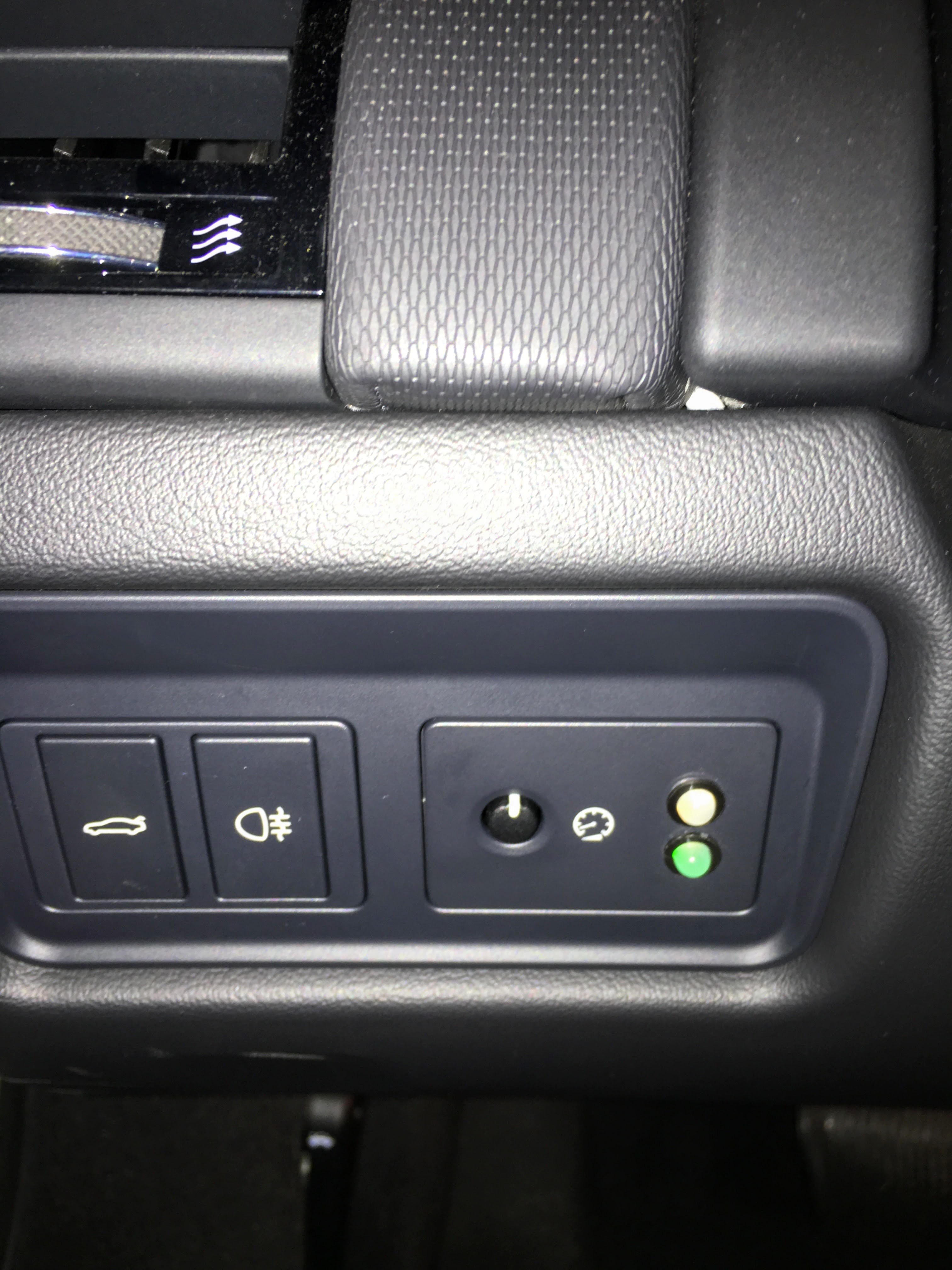

Actually.. I went and grabbed a couple of pics. It's better than hammering away at this presentation I should be working on
The first shot is a normal entering my car shot, which only shows that it needs a vacuum.
The second is me bent down to show you what it looks like below. Notice where the STi-R is and the rocker switch that controls power to both the ALPs and the STI-R. That way they aren't visible but I can still turn off the systems if I need to.
