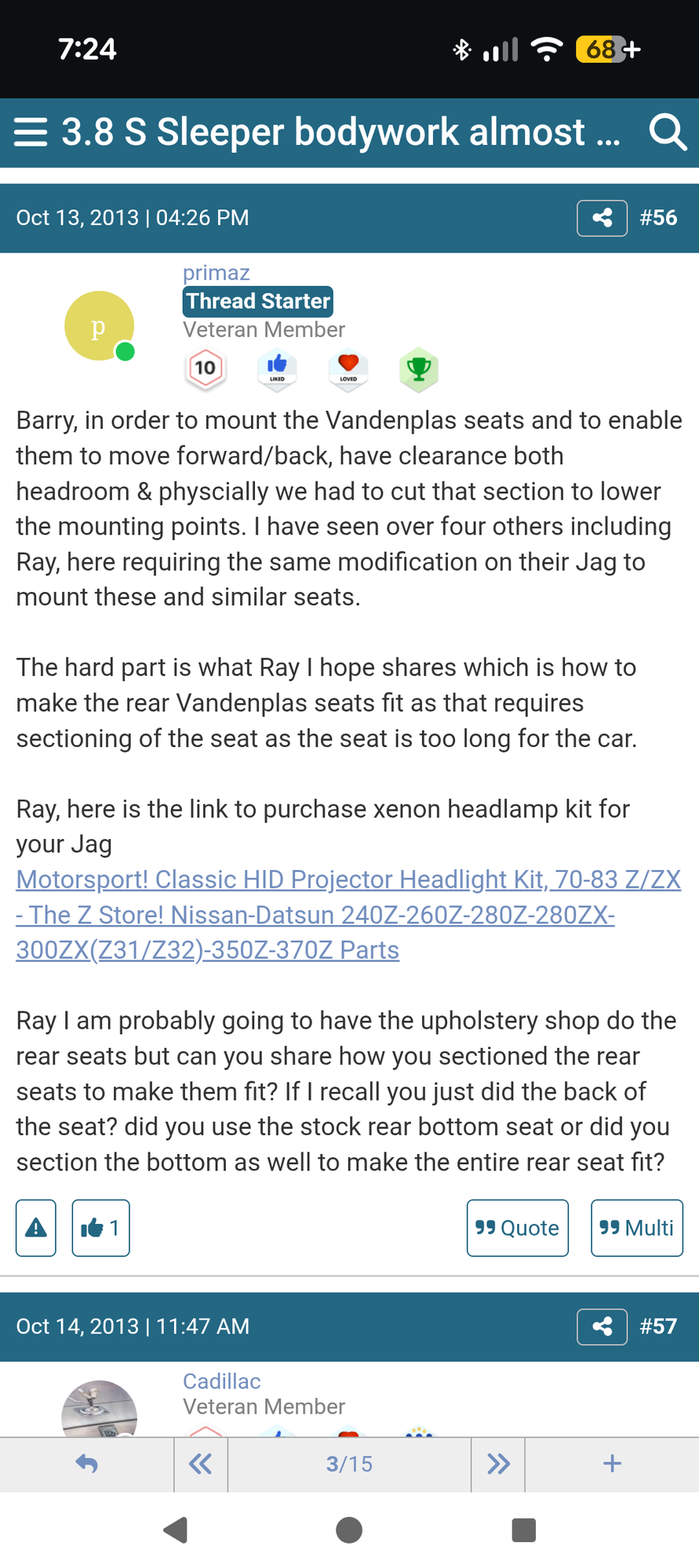

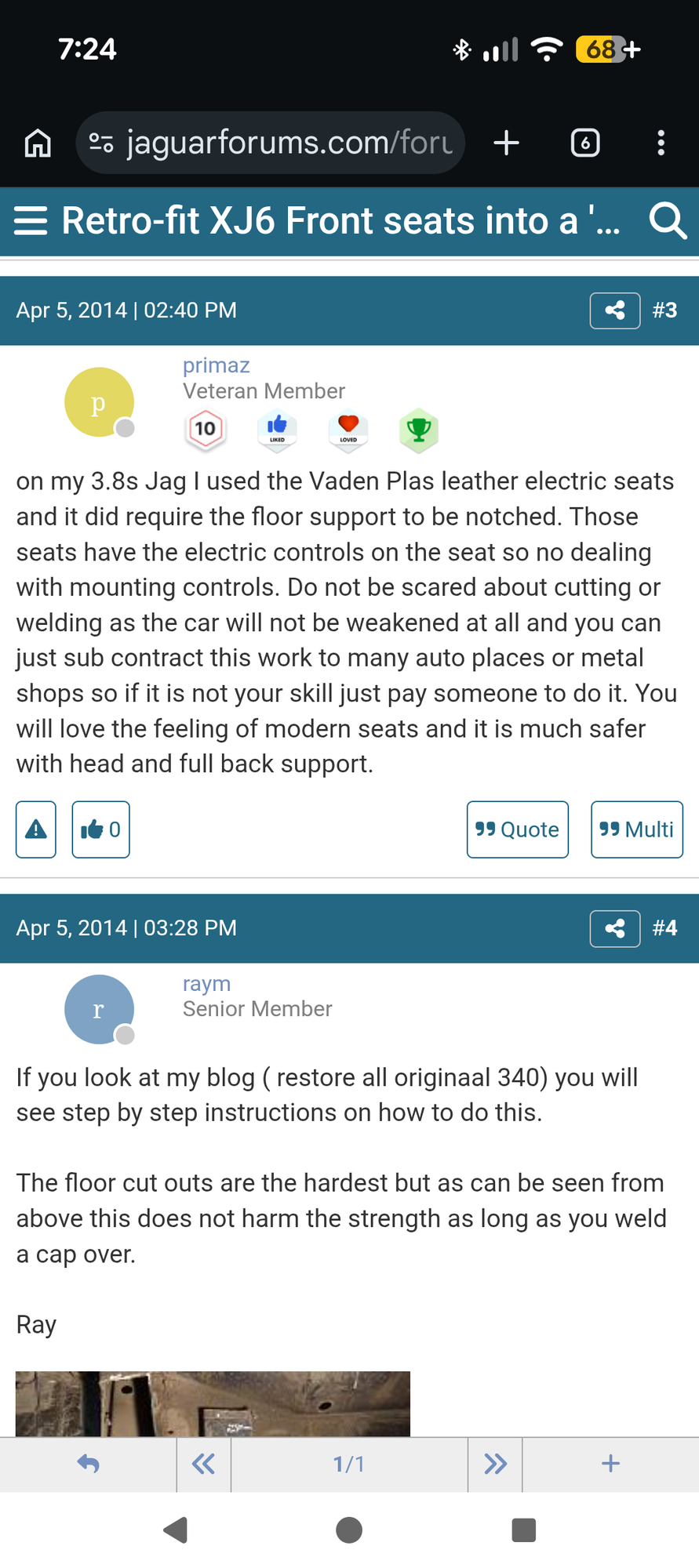

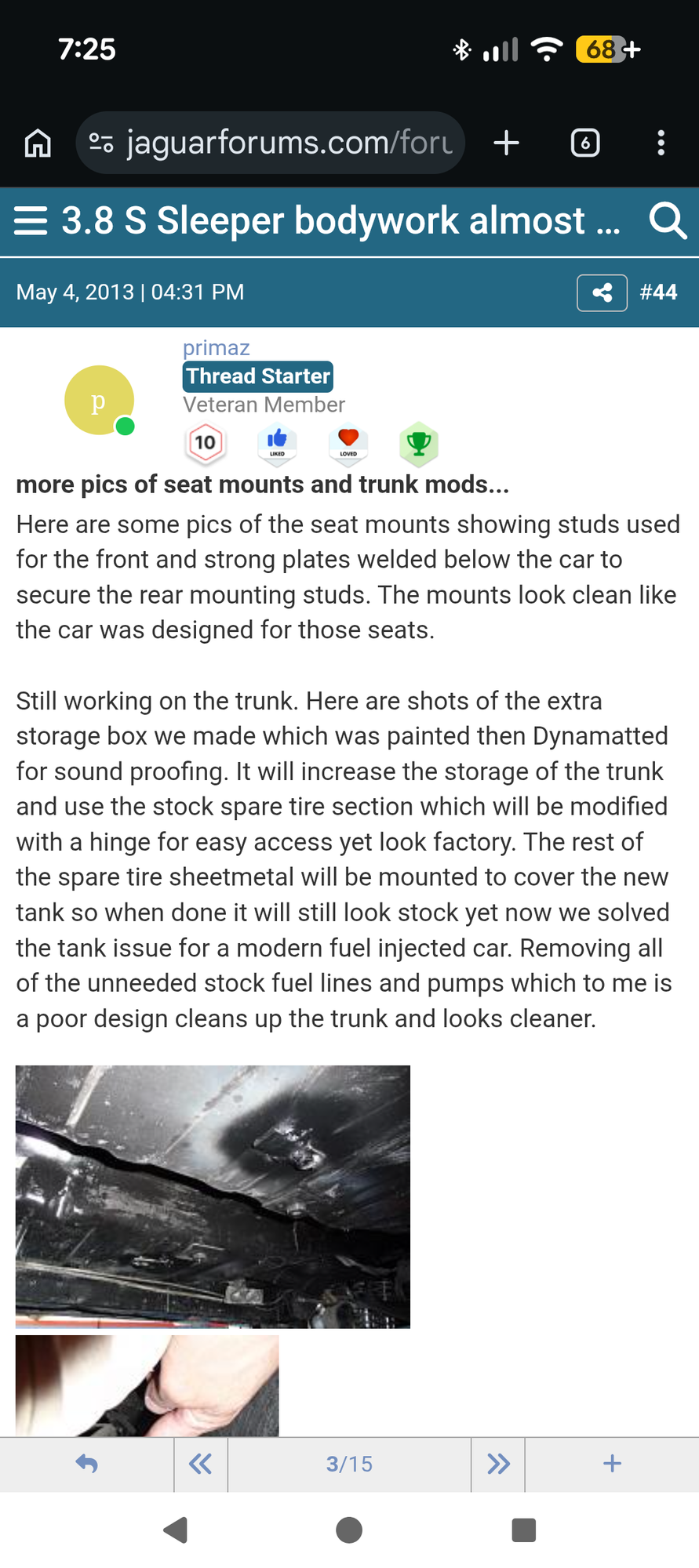

The front seats mount with no issues only the rear seats require the upholstery shop to section the rear seat frame so that it matches the approximately 12" shorter rear seat space for a 3.8s or MKII then you can even replace the rear seats from a Jag Vandenplas.
The welding was the firewall of the passenger side to fit the GMC LS1 V8 and that was not a big piece that needed to be cut and then a piece to weld back in place. If you ever attempt to use a V8 I do NOT recommend to go old school Chevy 350 but instead spend the extra money to get a modern Chevy/GMC V8 so you have the computer fuel injected control and ECU. The value of the car will drastically higher and the way the car will drive will be like a new car with no more choke, cold start issues, points/distributor, much better fuel economy and way more power, as the modern V8's are better in every way.
Again as he has said he wants more of restomod and the stock seats are just not comfortable as they have zero head support and only half of your back is supported. My original seats were in perfect shape so I know first hand how they feel and in my opinion they really are not comfortable.
I believe from your restomod thread you need to do some fabrication to the seat mounts and channel to get the front seats to fit. Am I mistaken? Would be great if I didn't have to go that route and they just bolt in.

Here are some of the pics I found, it does not look like I had to do any modifications to the front seats at all, and the others show some of the rear seat modifications.

Thanks again for your input Primaz. I attached some screenshots where you mentioned you needed to do some modifications to the mounting point/floors support/cross member to fit the XJ40 seats. Let me know if I am misinterpreting your posts. I understand you carried out this project close to 13 years ago so some details might be fuzzy 🙂
I would much prefer being able to directly bolt the XJ40 seats in!
