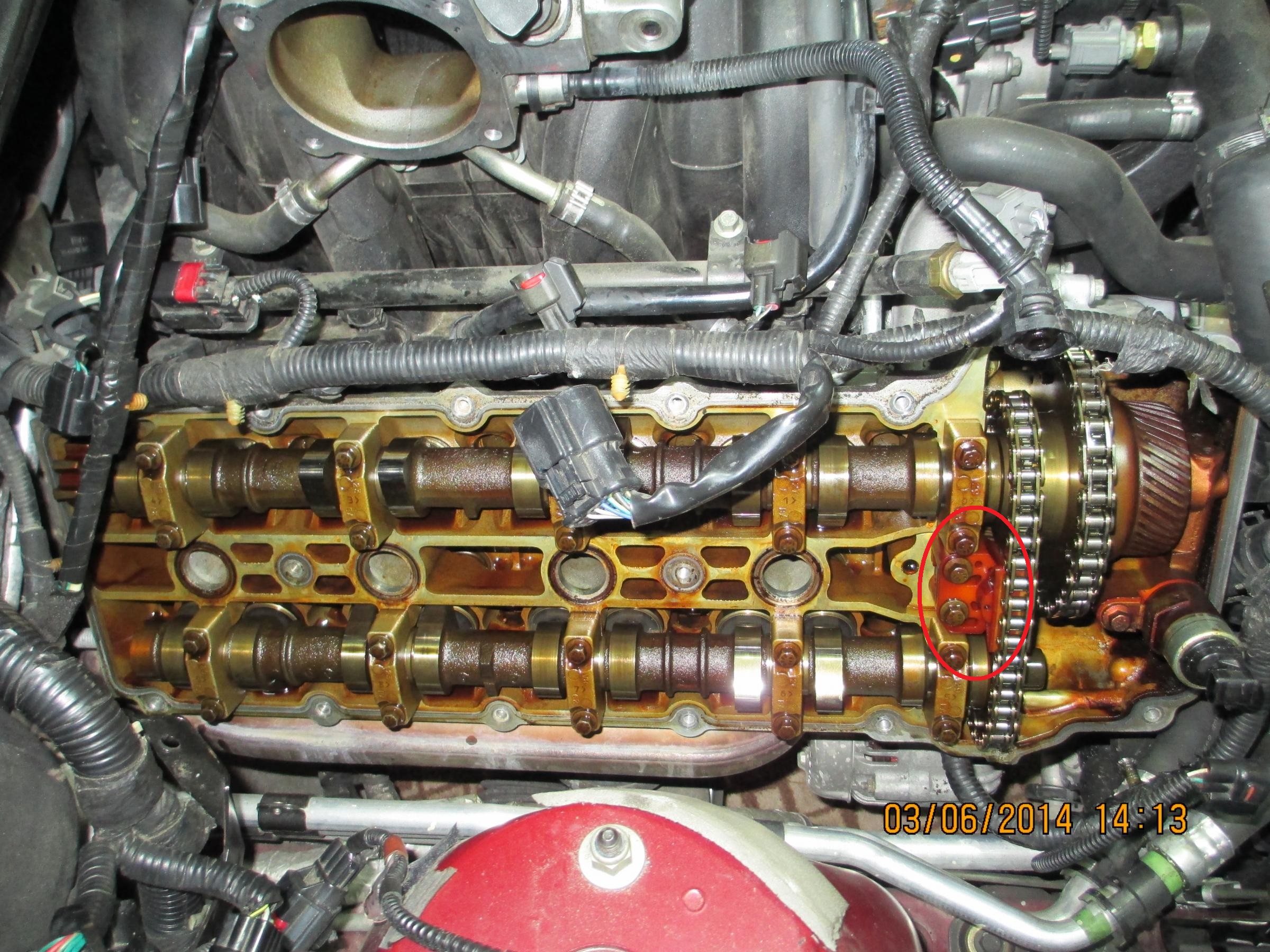

Very good job but it looks like you have more work to do??
You have the old plastic timing chain tensioners. They are orange/yellow in your engine. They started out white. I have circled them in red.
They need to be replaced with the upgraded metal ones ASAP. You will destroy your engine when they let go. And it's only a matter of time before they do.
Yes, I agree, and I should have done them when I had the valve cover off. I knew someone would point that out.
I'm not sure if that's a job for me to do.... I don't like messing with the timing much, bad experience many years ago. I talked to a Jag mechanic (my guy) before getting started on this and asked him about these tensioners, as I wasn't sure what I was going to find and if they had been replaced or not. He basically told me to inspect, make sure the chain is tight, look for cracks, etc. and if everything looks okay not to worry about it. According to the service records that came with the car the chain was last serviced/inspected in 8/2010.
Again..... I agree, after what I've read, that these should be replaced with the new metal ones. I just want to fork out the labor to have it done at the moment and not sure if I can do the job myself.

The cracks/damages are very often not seen until the old tensioners are removed so they could be damaged now and you don't know it.
Now you can most likely avoid engine damage IF you listen closely to the engine at every start up. Things will begin to rattle and make noise when the tensioners are getting close to letting go. It's not 100% but more than a few people have caught it in time and then posted pretty torn up tensioners to show how close they came to the edge!
