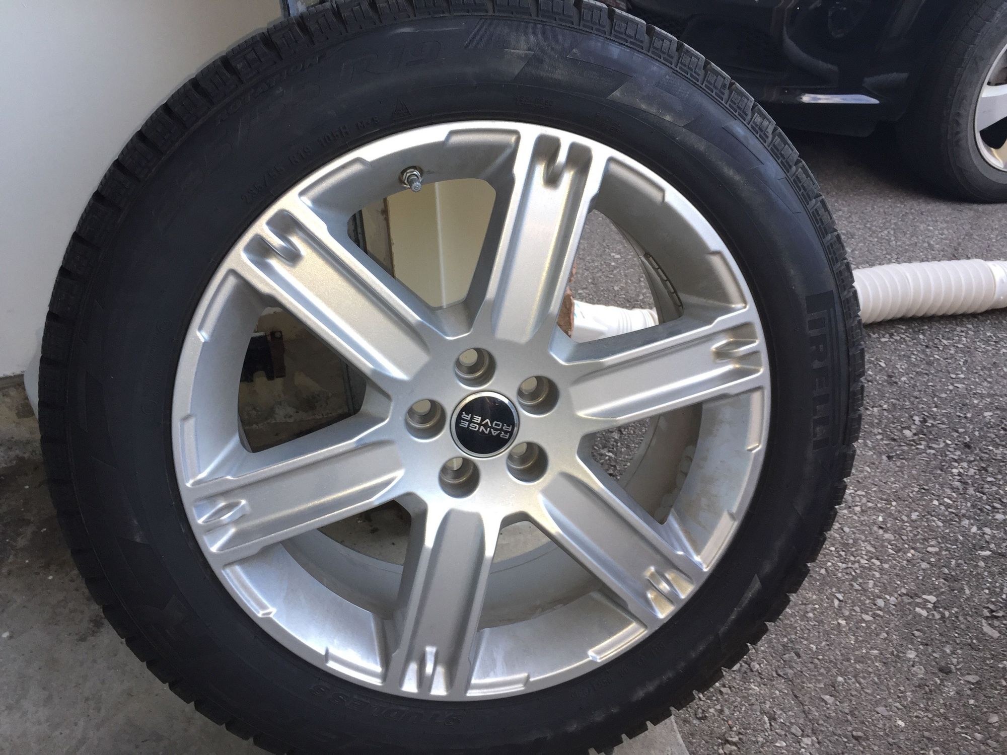

Will OEM Range Rover Evoque wheels fit on our Jaguar F-pace?
I bought a set of used OEM winter tire package originally equipped on a Range Rover Evoque (previous owner bought from Land Rover dealer) . Trying to know if I can fit this Evoque winter tire package on my F-pace? Plz help.
I am driving a MY17 F-pace prestige 35t, now. wearing OEM 19" wheel+255/55/19 tire.
Range Rover Evoque winter tire packet I bought:
Wheel info.:
Part #LR024424 6 spoke silver painted alloy wheel.
Size: 19 x 8J CH 45
Lugs: 5
Bolt Pattern: 108mm
Offset: 45mm
Tire info.:
Pirelli winter ice zero FR 235/55/R19
TPMS info.:
OEM sensors by dealer for Evoque
All Spec. numbers above looks identical to my F-pace OEM size except narrower tire. Any concerns? Thanks in advance! http://www.fpaceforum.com/forum/imag..._face_grin.png
https://cimg7.ibsrv.net/gimg/www.jag...2492e5a123.jpg19 x 8J CH45
https://cimg8.ibsrv.net/gimg/www.jag...a351a804b7.jpgOEM parts from dealer
https://cimg9.ibsrv.net/gimg/www.jag...3c4adcfcb8.jpg

Update: I got the Evoque oem wheels on last night with no problem. Wheel fits perfectly, using original F-pace lug nuts. (The same thread and same tapered cone seat.) Evoque TPMS sensors are also woarking normal following the 15min parking mode,15 min above 20km/h rule. They are self-learn SMART sensors! (So now I have extra set of 4 OEM F-pace sensors available, let me know if you want to get them)
Only problem during installation is the wheel center caps are not the same size for bore. I have to leave the Range Rover one on it or maybe put a jaguar sticker on top? And I'm not sure about the jack point for floor jack. I find the points by reading user manual (next to wheel with a triangle yellow sticker) but my floor jack's teeth are supporting on the edge of 2 metal joint, not a plat contact surface. I'm doing this wrong?
