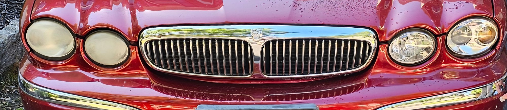

Just a "this product actually works" post. Bought the 3M Headlight Restoration kit. Lights look brand new. Very noticeable at night, both while driving and while viewing from another vehicle. Before/after pics below.
Both sides; right renewed, left not.

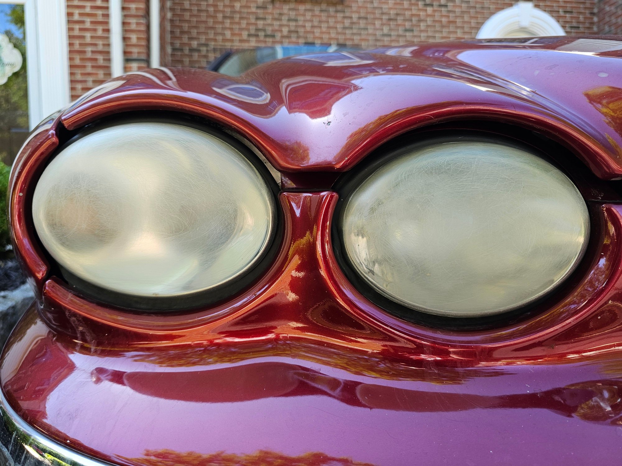

Left side
Left side \"before" photo. Right side looked similar.

Aug 24, 2025 | 11:33 PM
Nice job.

Aug 25, 2025 | 03:16 AM
Yes, I know. I did that, too. I think I started with grid 400 sandpaper, and in the end I used something very soft, sponge-like, attached to my battery powered drill. All that polishing by hand would have been too much...
Reply 1
Aug 25, 2025 | 03:30 PM
Thanks. The kit starts at 500 grit, then 800, then the polishing disc. Important note: following directions matters. Lol
