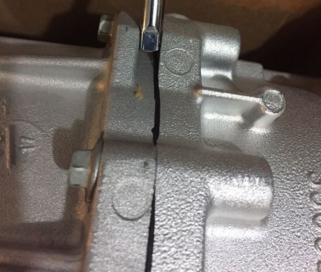

Nov 11, 2019 | 10:25 AM
I just recently saw this too. Here is a picture that might help.
The tab is under the SC snout and you can easily miss it if not pointed out.
See where the extension bar is placed. Look for the black sealant that is pushed out of the joint.
This gets you the leverage needed to pop the snout off the SC itself.
