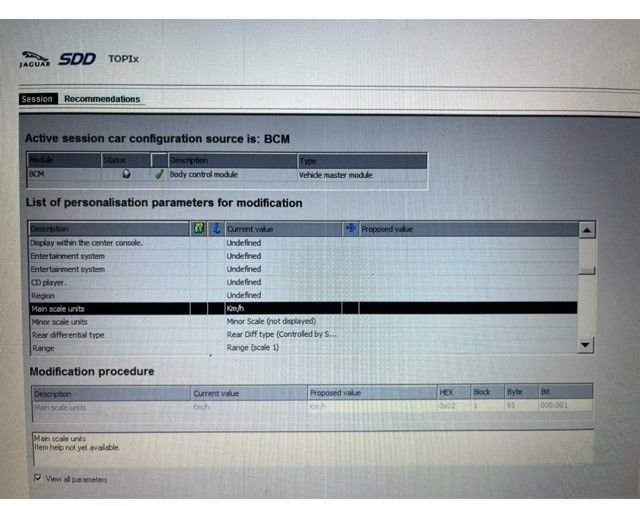

Working on SDD on a dedicated Windows 7 laptop (not a virtual machine) on a Mongoose clone cable in Engineering mode (yellow bar at the bottom of the screen). The Mongoose clone cable has worked fine in the past for anything I've used it for including CCF modifications, but it seems like only basic car personalization parameters are able to be modified. I am trying to edit the instrument cluster parameters to change my major and minor units from KMH to MPH (CDM market car) but I am not able to modify since the selection is greyed out. Can any of the SDD gurus shed light on this?

You can switch the "minor scale" units (the small numeric readout below the dial graphic) in the settings menu in-car, but you can't change the scale of the dial and speedometer needle. You need to edit the CCF to do that.
Update, I solved the issue. On your SDD "seed calculator" (a downloadable program along the SDD crack or at https://vehcom.com/jlr/access-code) you must select the "CCF EDITOR" under Jaguar Functions. This will allow you to edit everything within the CCF.
I now have the main speedometer scale as MPH even though my car was sold in the Canadian market.
