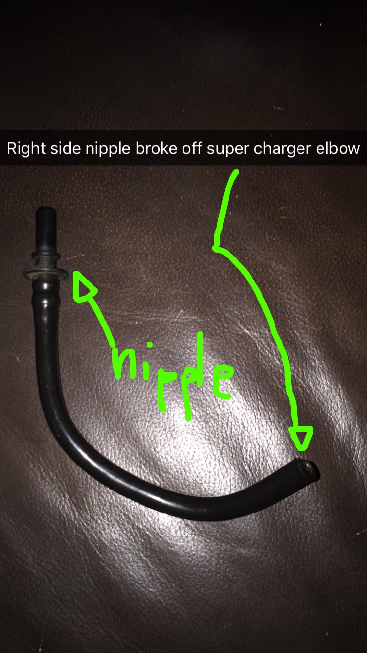

We just swapped out the old fuel injectors and went ahead and replaced some common failure hoses for the XJR. Ended up breaking a short plastic hose with two nipples/fittings on it (located on SC elbow apparatus).
Having trouble identifying the short hard plastic hose so I can order it online. It had 2 nipples/fittings (one on each end) but one of them broke off when trying to reassemble *picture attached.
The hard plastic hose's location is off of the superchargers aluminum elbow apparatus which attaches to the back of supercharger (opposite end from SC pulley)
If anyone could tell me what this hose is called and maybe where I could get it besides dealer so it comes asap would be much appreciated.

It's the brake booster hose. You can find it on ebay. Make sure to get the brake booster connecter clip kit as well you'll need it.
