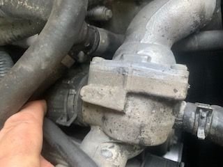

Leaking coolant, driver side, (US Version) top of engine as fluid hitting manifold and steaming. What coolant hoses or fixtures should I be looking at in this area?

Upon removing the intake plastic, I discovered the leak. The large hose that seems quite short coming off the outlet housing to the motor is leaking. Where might I find a part number or description for this hose? Thanks in advance.
hose leading from housing down to engine is bad, does anyone know the description or part number for this particular hose?

I don't know as I don't have an XJR but I will suggest this: save your pennies and replace every rubber coolant hose there is. Otherwise you will be chasing leaks until you finally have all the hoses replaced. Don't ask me how I know that.
Call a Jag dealer and get the part number from them.

I believe this is the part you're looking for #AJ811638
