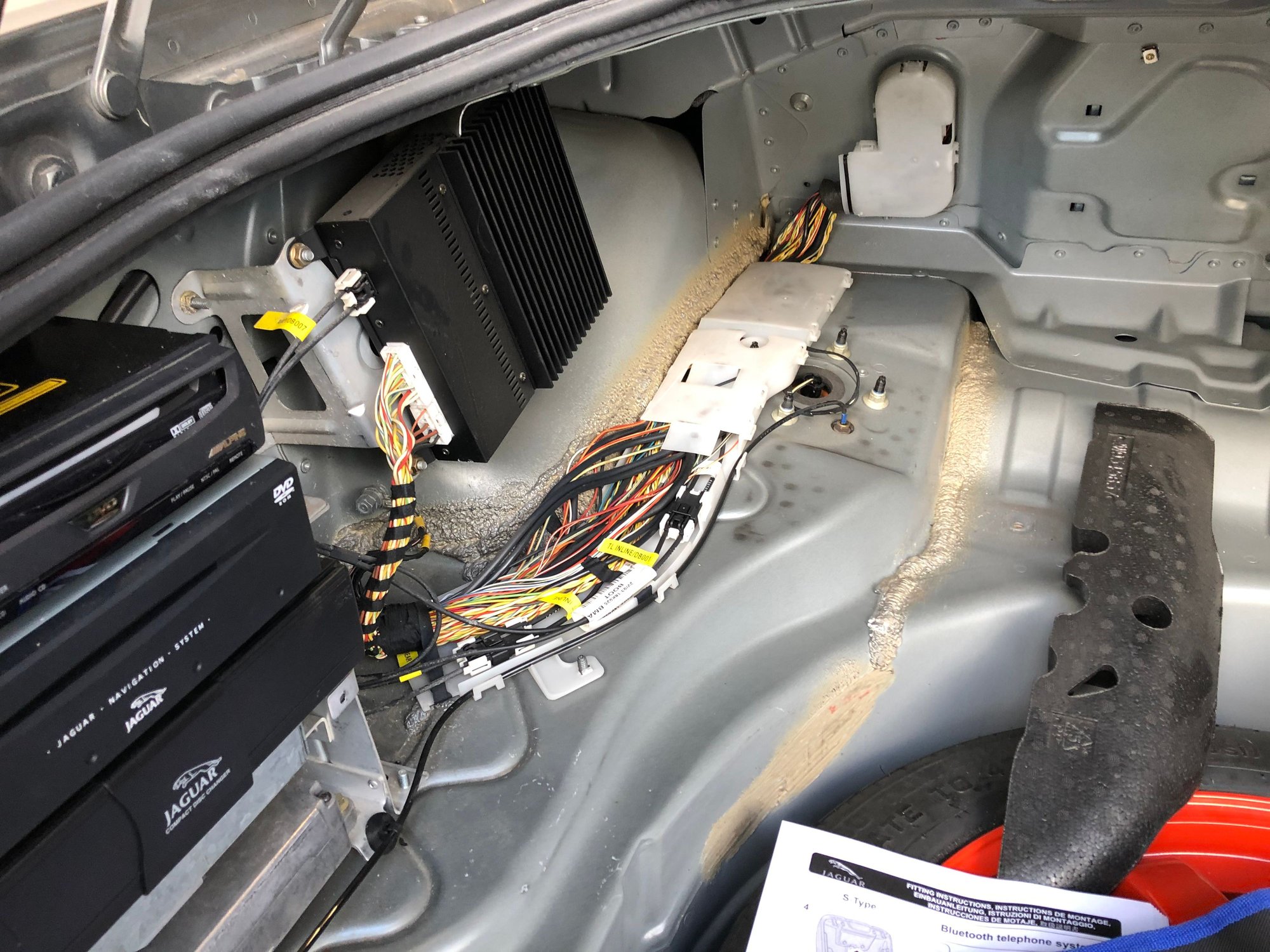

Hey everyone I was wondering if anybody out there could help me by telling me where exactly is the amplifier located in the car so I could replaceI would really appreciate the feedback

if I remember correctly, only the premium sound system on the X350 has a separate amplifier. This is located in the boot, behind the left hand side boot lining. Have a look at the picture.

There is also an antenna amplifier that combines and boosts the performance of the two integrated rear window antennas. It is located behind the left C pillar panel.
OP wasn't specific as to which amplifier he was seeking the location of.

If you have the dash speakers and the rear deck subwoofers, then you have the amplifier. If you don't have those, then there is no external amplifier, the head unit provides all the power to the door speakers.
