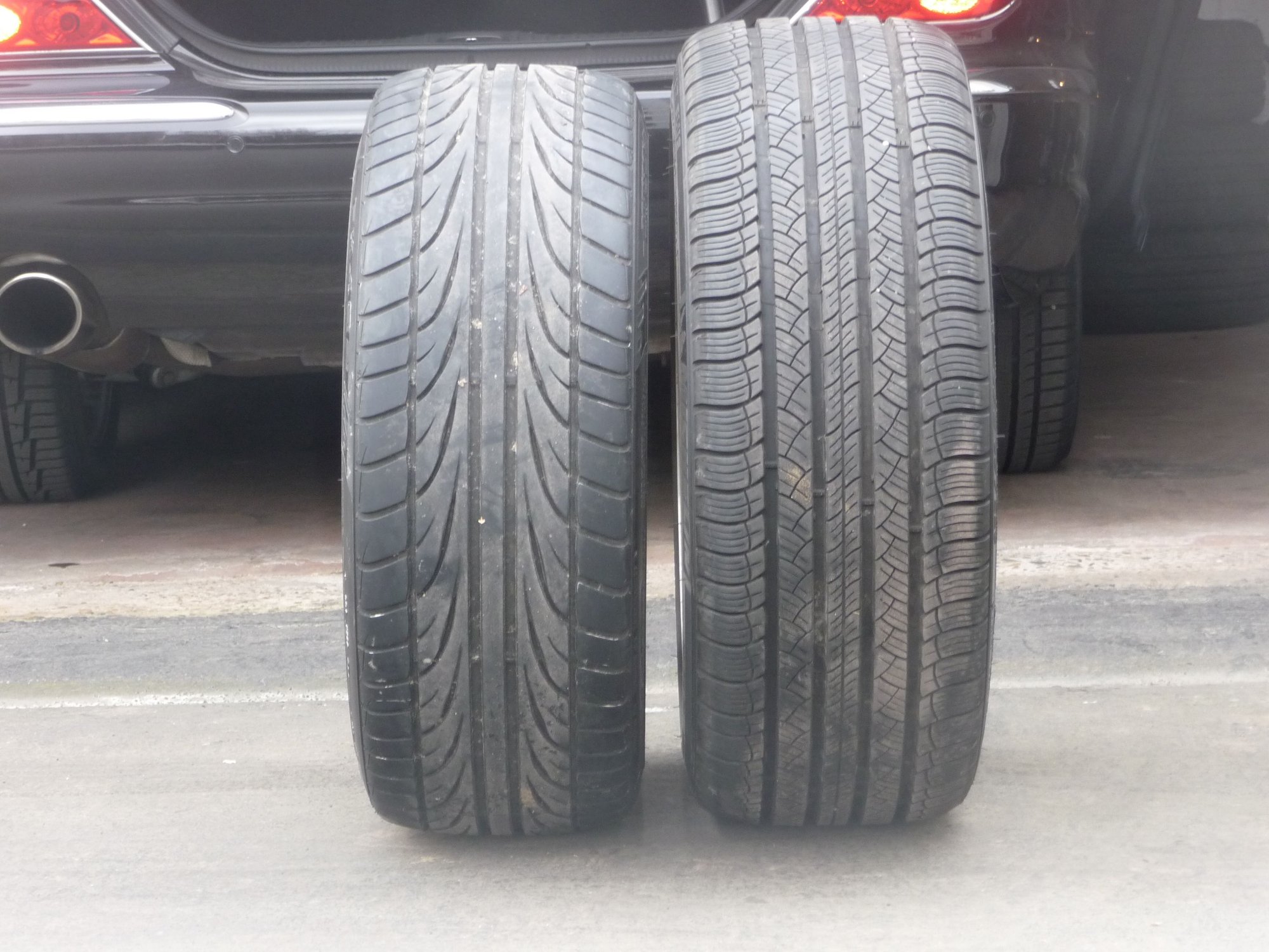

When I bought it, the PO had already fitted 255/40 ZR20 Michelin Pilot A/S tires exactly for that purpose: to avoid flats and rims damage, and get addtional smoothness.
That tire dimension has a substantially taller profile, I attach a pic showing it compared to a used Falken in the original 255/35 ZR20 dimension.Of course there is a slight deviation in the speedometer reading, but unnoticeable for practical purposes (at 130 km/h on the speedo, the GPS now reads a true 130, while previously it was 125). Also no rubbing in whatever conditions.
Since then I have made 60.000 km on that set of tires, perfect handling for my taste, no issue at all and they still look good.

If it would be 255/45 ZR20, it would be way too big!
255/40 ZR20 is already quite large as you can see on the pic

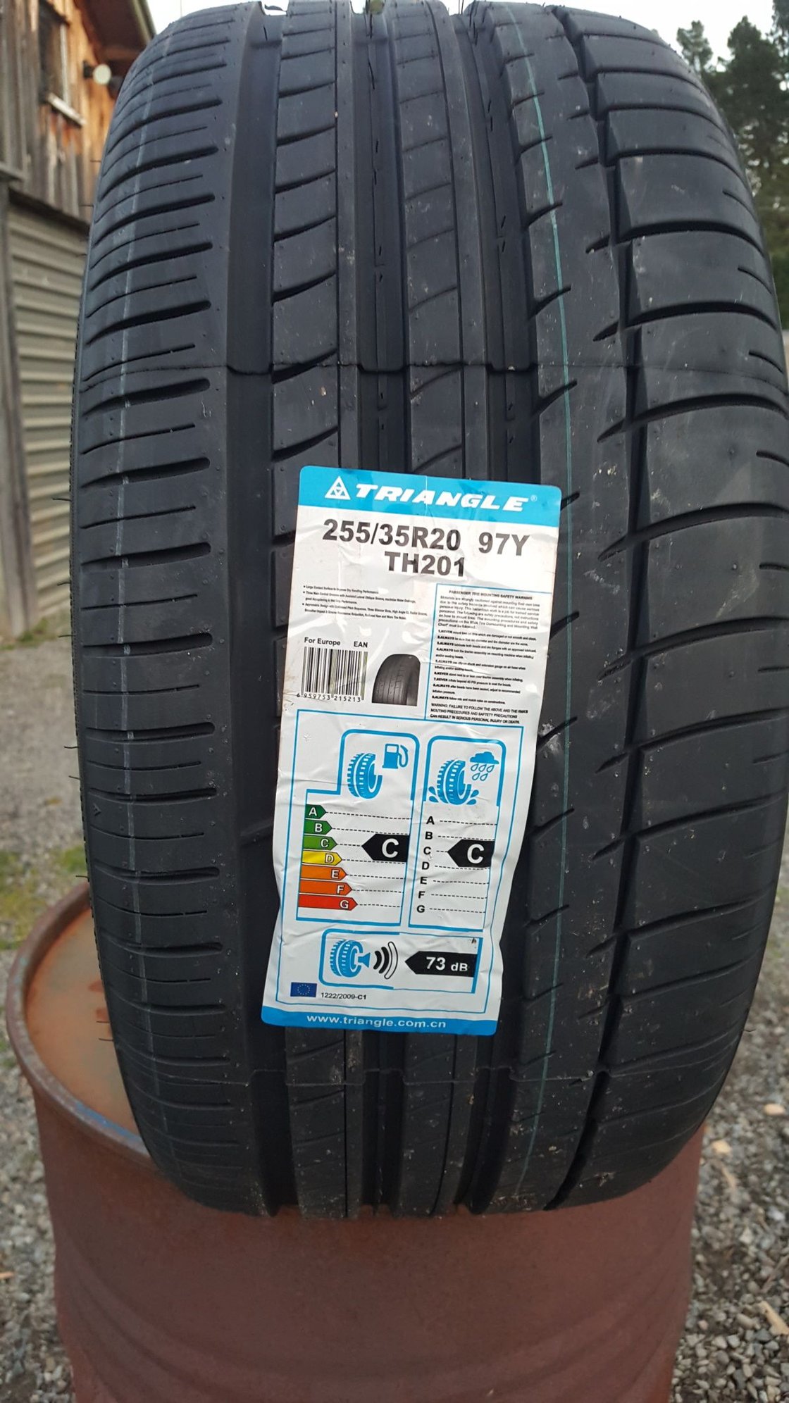

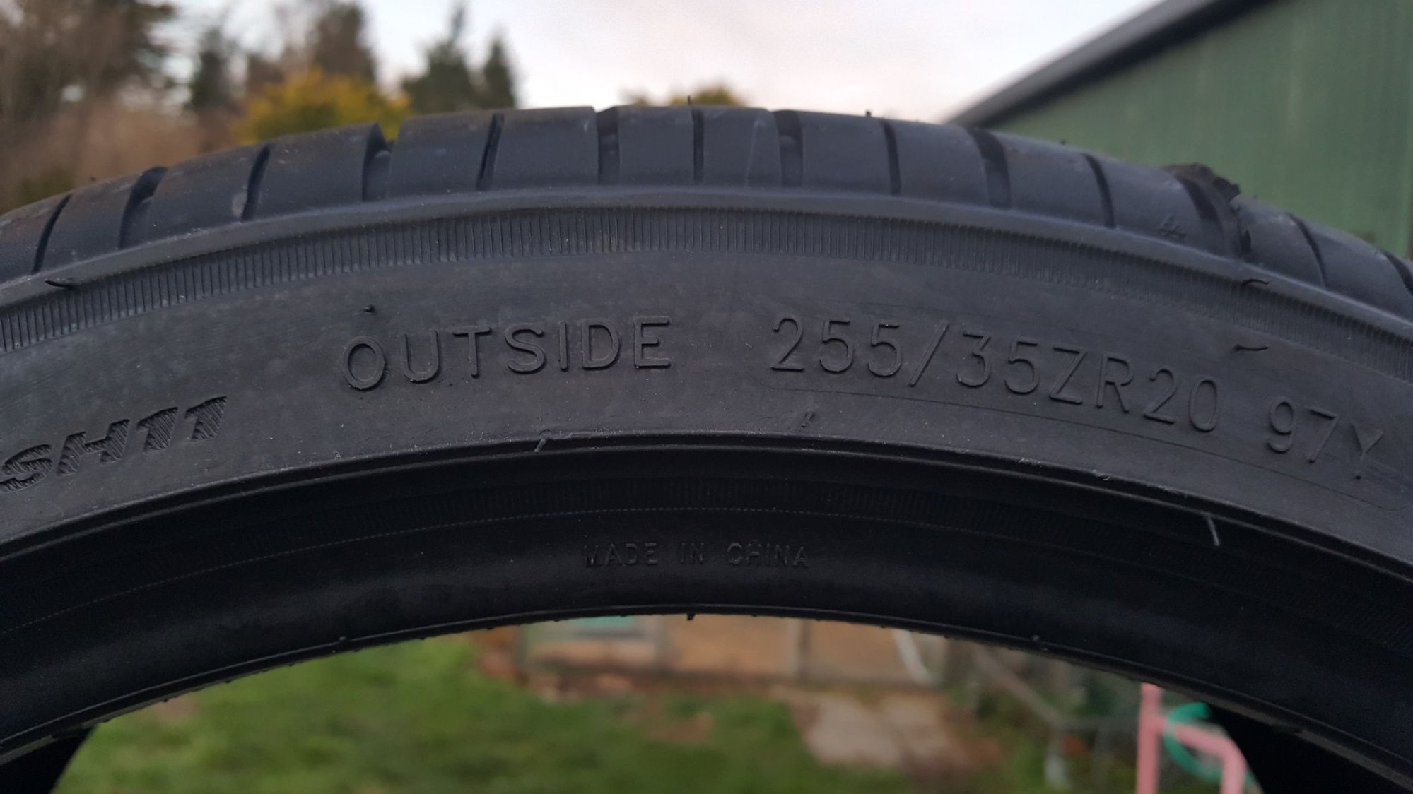

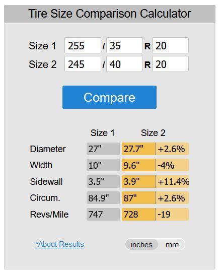

When I got my car, it had 245/40-20 tires fitted. It may have been that the correct size was not available for the previous owner at the time. They were quite worn and I obtained the correct 255/35 - 20 tires when I had the badly kerbed Callisto wheels refurbished. I found that the correct size wheels give a speedometer error of about 6 Km/h high at 100Km/h, comparing with GPS. I set my cruise control for 110 Km/h as there is a number and graduation there on the Japanese Km only speedometer, and GPS says about 103 Km/h, which is fine with our national 100Km/h limit.
You can compare the dimensions above.
It's interesting to see the discussion about Michelins and Pirellis and Continentals. In this country, all of those brands cost several hundred dollars each, making about NZ $3000 or more per set. I'm not sure why they are so expensive here, but this is a small country so the small numbers we import may increase the price.
You may laugh, but I got a set of Chinese Triangle tires for about $150 each. I have just got back from an 18 day 2000 mile trip from Oxford in the middle of the South Island to the top of the North Island and back. The tires performed perfectly. Sure, they are noisy on our coarse chip roads, but perfectly quiet on smooth tarmac. They seem to have plenty of grip, wet or dry, and I have never had the traction control light on or any feeling of lack of control. We have a fairly low speed limit, so they don't see much time above about 150 Km/h, and up to that only when passing semi-trailers.
Triangle TH201
Correct spec for car
I figured that for the price they were worth a try, especially given the price in NZ of 'name' brands.

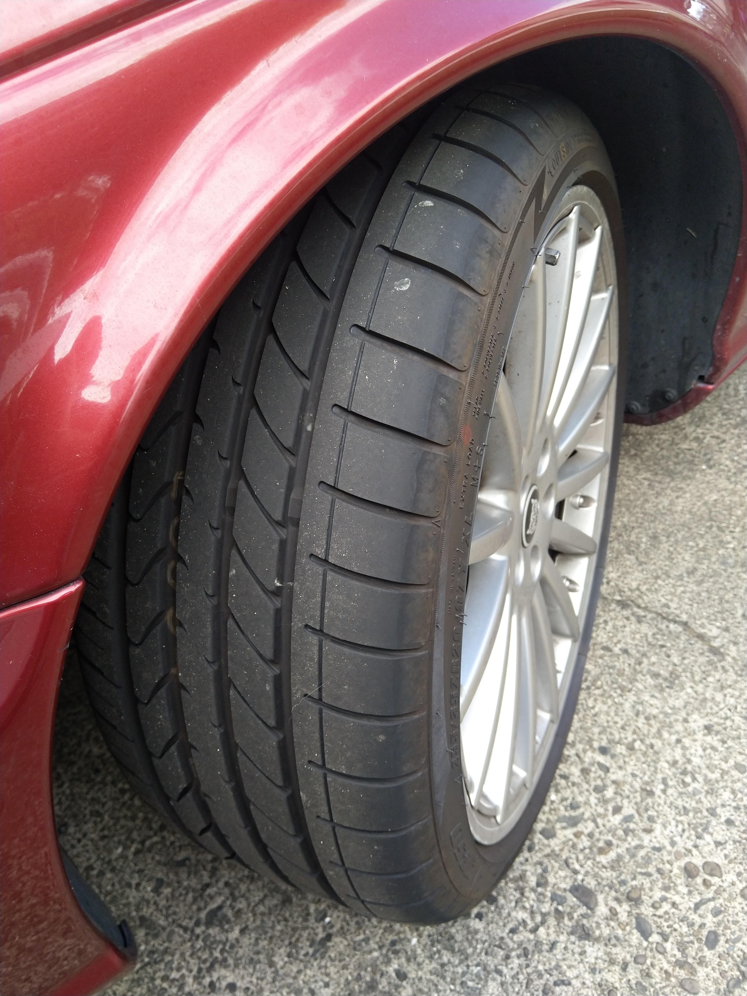

​​​​​​Next time you're tyre shopping, have a look at the Atturo. I found them to be quieter than the triangles and they have a thick rim protector lip on the sidewall. Had some bottom of the barrel 'kinforest' tyres when I got it - they were lethal in the rain.
Running 255/35 and have wondered if I could fit something a bit taller profile in there to help with our rubbish roads.
