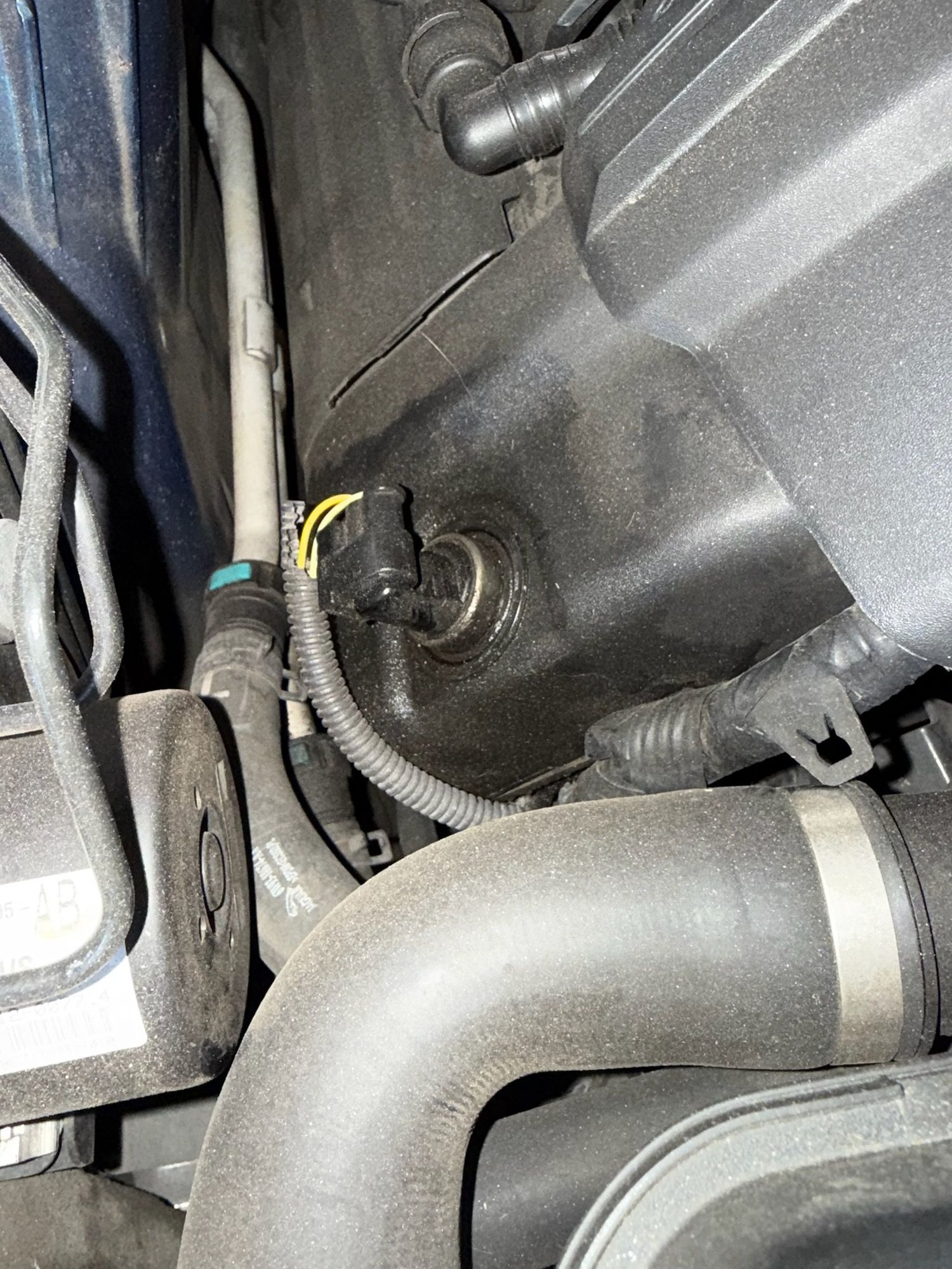

What is the part number for this sensor?
Subscribe
Feb 11, 2025 | 07:03 PM
Hello Everyone
Does anyone know the part number for this oil sensor?.
Reply 0
Feb 12, 2025 | 03:54 AM
Not an oil sensor; is your Variable Valve Timing solenoid?
Reply 1
Feb 12, 2025 | 07:18 AM
And your seal is leaking. They can be pried out and replaced from the outside of the cam cover. Pretty common oil leak area.
Reply 0
Feb 13, 2025 | 08:04 AM
It’s the VVT
need to get new seals for them I had to do that on our jaguar
Reply 0
Feb 13, 2025 | 08:08 AM
Part #
NNE2622BA
